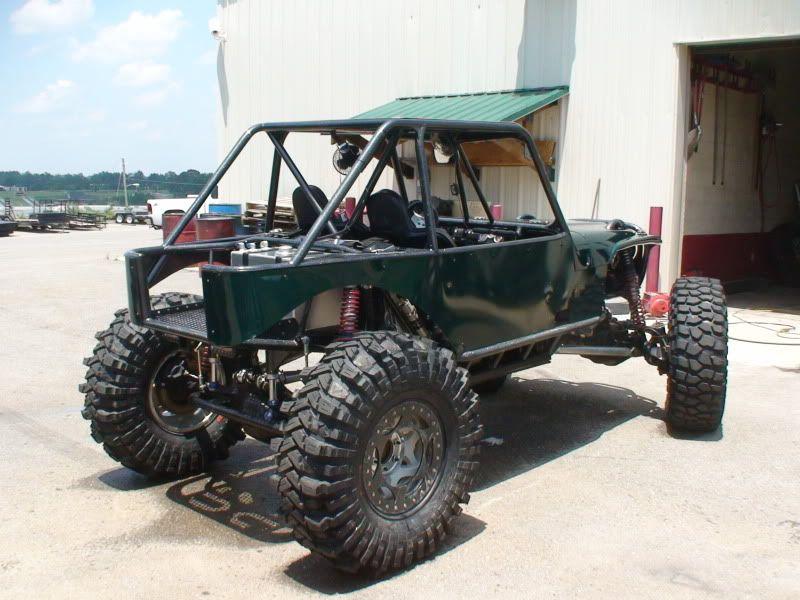

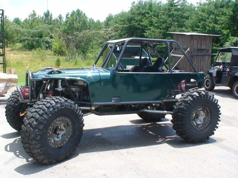

Took off about 10lbs from each tire. Gonna run them like this and may end up grooving them more later.

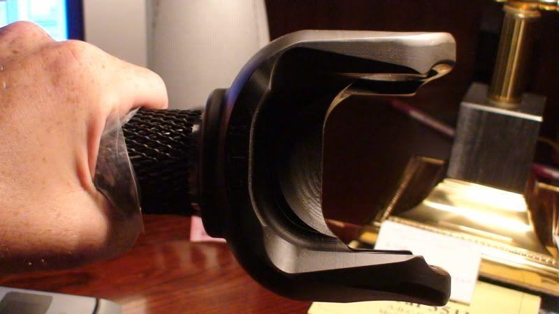

I tried to email this to you but it came back. ??? Did you find out what broke
Loose Rock 6-13-09

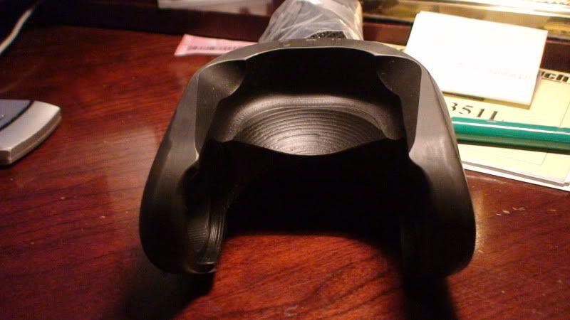

Yeah the stub on that side was a blem shaft and it had been double splined. It just ripped what little material was there for splines off. Already in the process of getting a new 300m stub. I think I killed it on Mine JB and it just let go there.
Locker and everything is fine because the shaft was just spinning in the drive flange.
Finally got my New 300M stub shaft in tonight. Thing is like a Piece of Art Work.

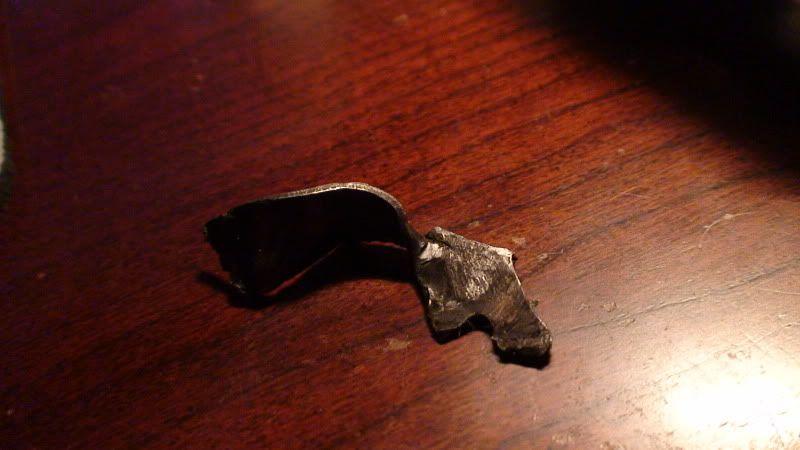

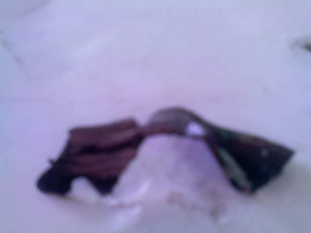

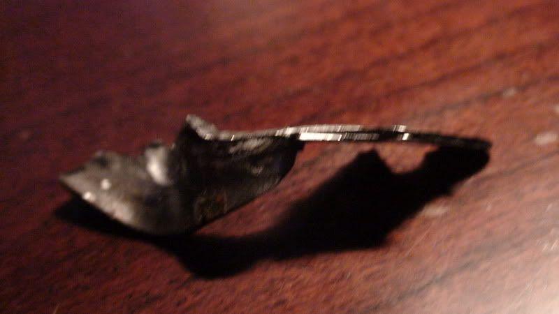

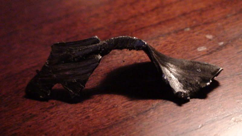

Also found this piece of Metal in the Transmission Pan yesterday. Everything shifts fine so I am just going to run it.
