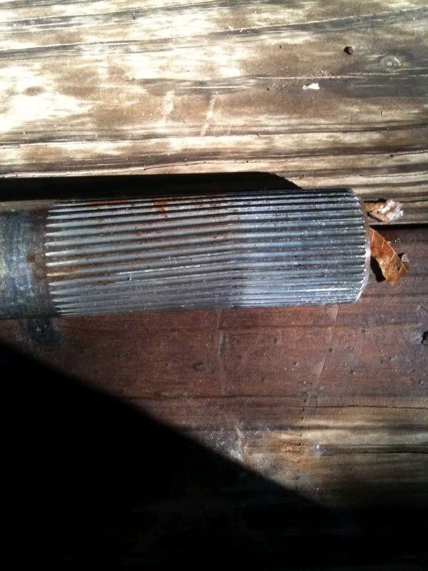

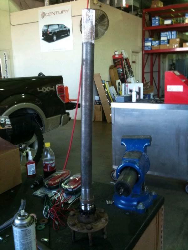

Well pulled the axle shaft out. This isn't what I expected to see.

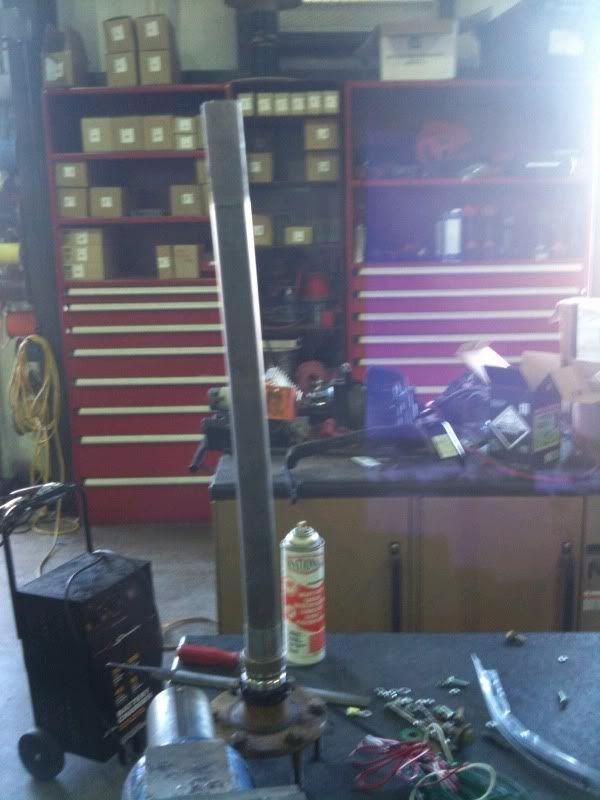

Anybody ever seen a shaft bend like this?
Also it destroyed the bearing and we had to beat the shaft out.

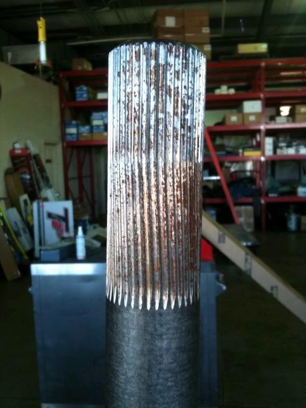

Also it twisted the splines. Remember this is a 40 spline shaft.
Congrats! I've yet to bend one like that. I've got a pile of 35 spline shafts twisted like that(one about 3 spline over), but have never broken one.
BTW...if they are Mosers, they are junk...or at least the two sets I got from them were.
Semi float baby. Tire hits and the axle and bearing take it all. I bet that tire was 40" wide on the ground from the wobble.
Put that thing back together and buy my housing and start over. Go 40 spline FF. Use your center.
