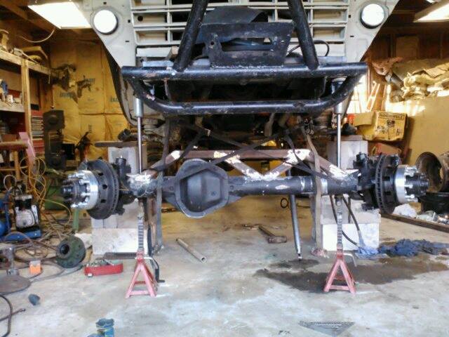

Dana 70 front out of a power wagon converted to open knuckles and 35 spline inner and out. I built it at home
