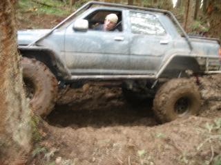

are you gonna have room for the back seats? mine is super tight...
yeah, I put sat back there with the seats, etc and it was fine. I have two small kids that will ride back there most of the time anyway.
I like the runner btw. Gotta love copped up 2nd gens... :cool:
