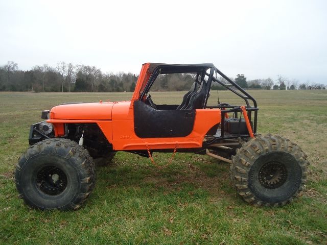

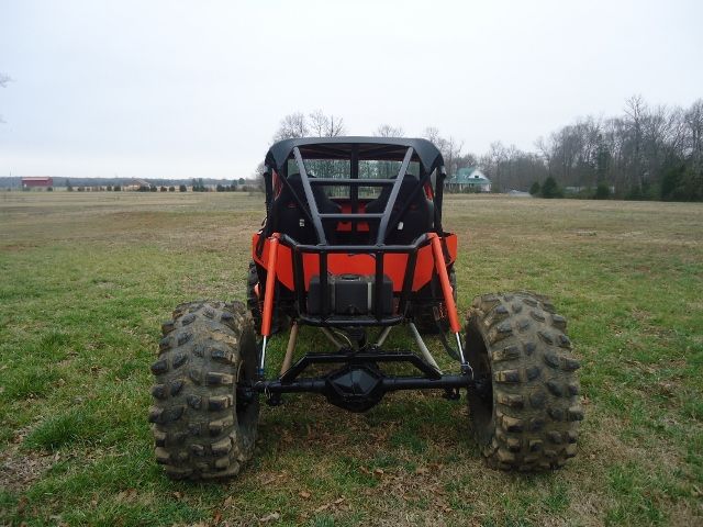

Well almost everything is pretty much done, took it out on a little test run everyting went great accept for my winch. the bolt holding the line on stripped and came out so the line just spun on the drum. a few pics now...

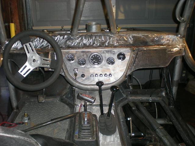

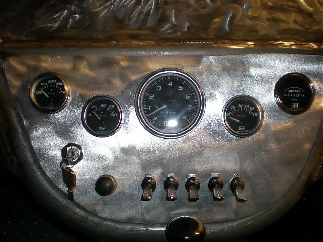

Heres the new interior
Loading on trailer...looks a little bit better with the 39.5s than the 27s that have been on it
playing on a little ledge
Movie%20clips
Movie%20clips
loaded it up and went to weigh it yesterday. More than I was hoping for and I still have to add some stuff. The total was 3520, front axle was 2220 rear axle was at 1300...
Looking good man. :awesomework:
thanks man, I just hope I make it out to the trails more than 2 times this year. its almost ready just need a skitplate on the bottom and I've had some new 5.29s sitting here a while that need to be in.
Sounds like it could use a little bit more gearing from the video.

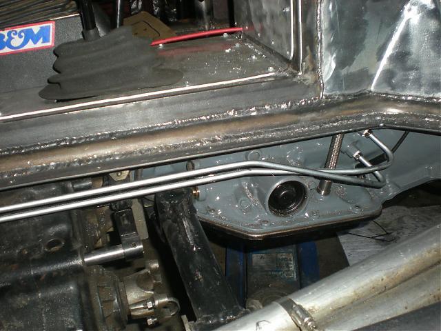

Did a couple little things that needed to be done.
--Getting rid of air bumps up front
--Reworking the front steering to get rid of the tierod twist and binding
--installed some grab handles for the passenger off my old bmx
--installed shifter knob i had from when I bought my axles
old steering setup
bumpstops coming out
Mounts off and all cleaned up
New ram placement, just need to build a guard off the axle
Passenger handlebars and shifter knob
First off... I installed them because my steering ram was smashing my oil pan jumping in tuff truck races (no more of that, to expensive) and just hard front suspension hits on the trail. Once i installed them the bumpstop had to be riding on the axle so it was low enough to stop steering ram to oil pan hits. out on the trail it was super annoying cause every bump the bumpstops would go... cluck..clunk..clunk..clunk..clunk..
Now with my steeing ram moved down lower and engine moved back my axle house more travel up and the mounts would have to redone. I think i will just put regular bumpstops back on with shock and put the air bumps on the shelf till I get the front 4link going some day:awesomework:
Good to know...the front of my truck bottoms out easy (kinda heavy) so I was thinking about running these to help. I was going to destroke them to 2" though so the truck wasn't riding on them constantly
They worked great and served there purpose but they were annoying. Mine were the 4in stroke ones, I probaly should have got the 2in stroke and it would not have been quite as bad.
