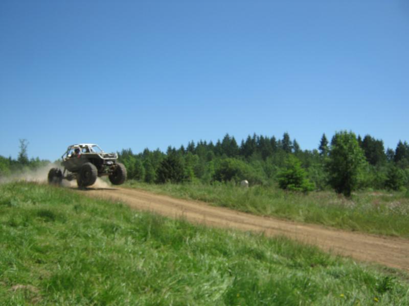

Here is a picture 1 second before the trunion broke

thanks for the pic Corey, I wish it would have been just the bearing. Ended up being broken pin in the hi-steer arm, bend the housing on the short side and the inner knuckle ball ears on the short side, and i had to fix it in a week to be in the naches for the 4th. so i ordered some parts and got to work the day i got home from truff truck.
had to cut the ears off the inner knuckle balls to get the birf out and then had to chop the shot side tube to get the inner axle out. a friend had a bare housing laying around so we went and got that. cut my diff guard, steering skidplate/guard and truss off the old housing to put on the new one. I also ordered the TG kingpins to get rid of the trunion bearings.
