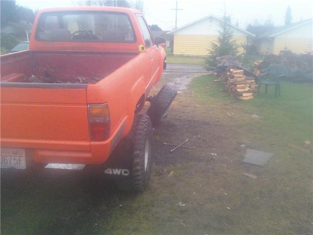

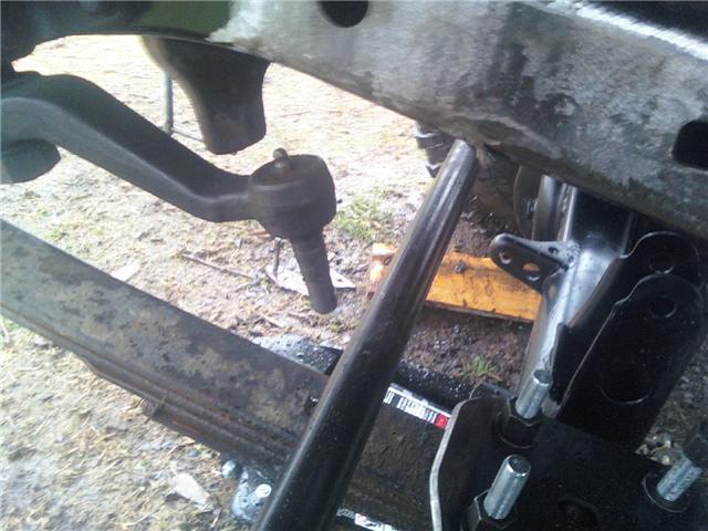

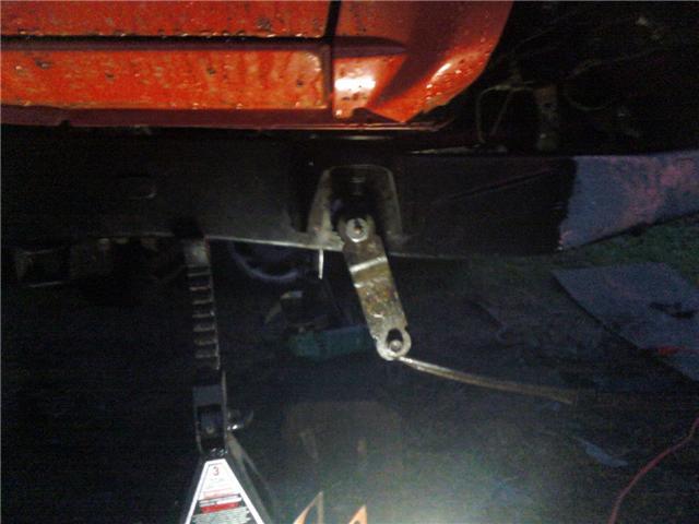

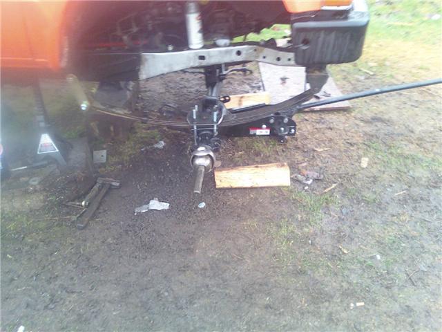

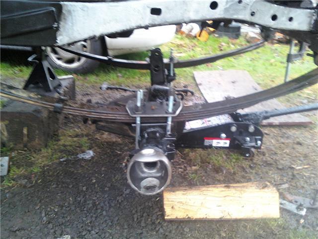

Well changed out the leafsprings tonight, for a pair i stole off a buddys truck for the moment it looks to have improved my shackle angel now. Anyone think this looks better now then the pro comp springs? I think its ready to weld and check it out on monday im going to get my ubolts in the mail, so ill throw my axle half way together and lower it back off the stands to check to see if it goes to where it needs to. No more updates untill then i guess cant really do anything else.

Chop's got a good point--I think you should leave the shackle sleeves where they're at, just in case you change to a longer spring...:awesomework:

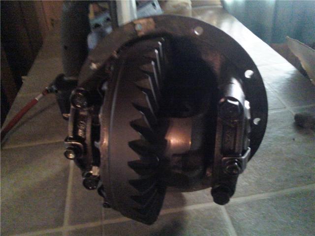

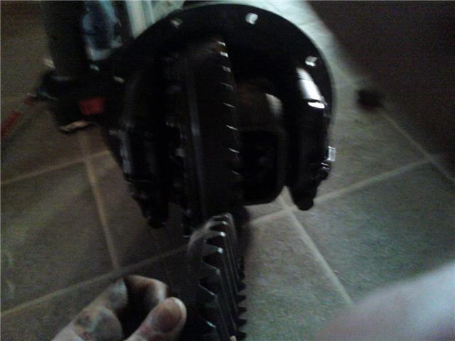

one picture is the difference between the size of a 410 ring and a 529 (529 is in the 3rd)
other picture is just assembled 529 (its set to .007 thousandths backlash thanks to zuk for pointing that out

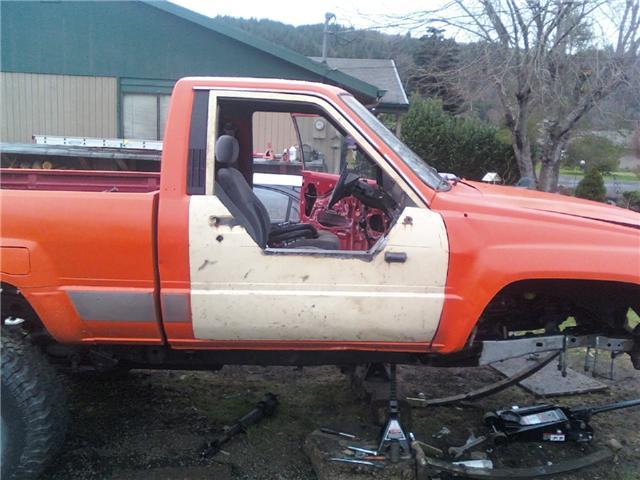

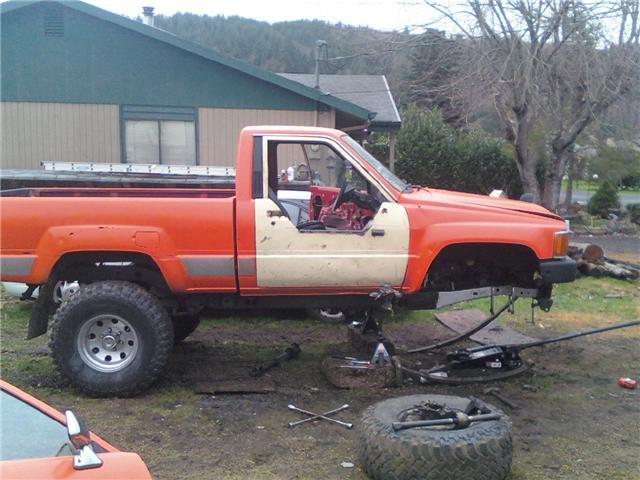

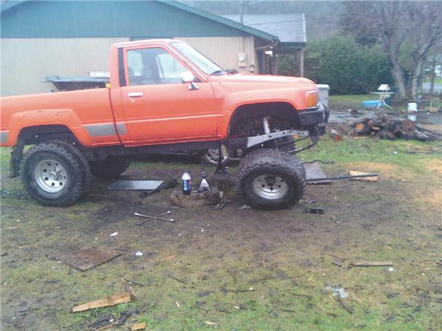

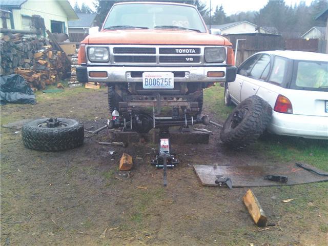

after mock up conclusion is move hanger backwords to clear the stearring components of the hy steer and just some poser look a like flex from not having my knuckle on just propped up with my tire lol

continued so its all coming back apart tomorrow in order to move the hanger back to spring perches are flush with stock cross member which should fix shackle angel at ride height and stearring stuff

Why did you take the knuckles apart like that?
if you take off just the felt gaskets on inside of knuckle,and the stearring arms and remove the snap ring on the end of the birfield inside the hub, you dont have to mess with brakes or wheel bearrings you just have to pull one trunion bearring out of the axle ball the other one you can swoop the whole knuckle assembly off of the other trunion
That is a strange way to do it.
how else does it get done? besides tearring everything apart one by one? just a trick i found out in the garage a couple days ago
haters:masturbanana[1]:
thats the way you do it on the trail just like he said saves so much time and bs:cool: rigs lookin good:beer:
