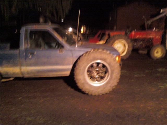

pic 1 parts knuckle kit 529 ring and pinion and rock sliders
pic 2 used but half way new looking shocks from toyota corey i purchased
pic 3 how bored i get while waitin for parts my blue bomber daily with coreys 41iroks next to it lol

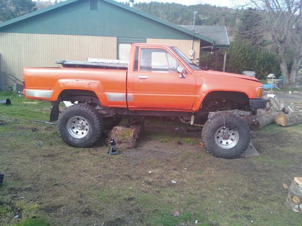

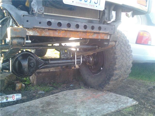

front end put together finally for the last time for a while
front axle has 529s and full knuckle rebuild new trunions you name it all new grease in the birfs and everything also got my 26 inch extended brakelines today
official ride height on the front (gonna have to figure out the rear
TO DO LIST!
bleed brakes
install 529s and weld spiders in rear
put shackles in rear
torque down everything (u bolt plates and hysteer stuff)
get 37" tsl's or boggers
install rock sliders
Bob somewheres between 12 and 24 inches out of the bed
thats all for now more updates when i get a wild hair up my asss to start on the rear of it ( have rear 529 already just lazy)

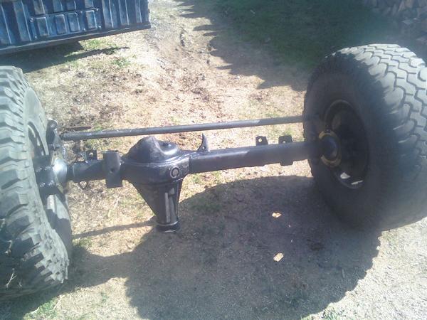

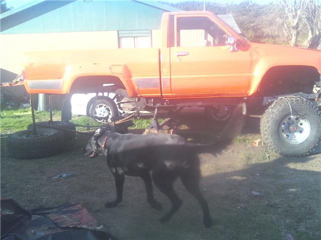

just a small update for today pulled my rear 3rd out
and also got the spiders welded up so making progress hopefully next week i can get my front axle trussed everything welded in and get wheeling for the moment till i decide to do links

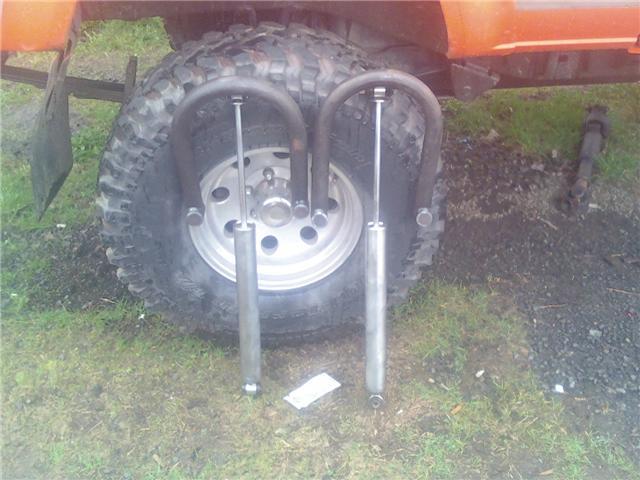

rear 3rd in with locker is installed
shackles are done (cant remember if i did that update or not lol

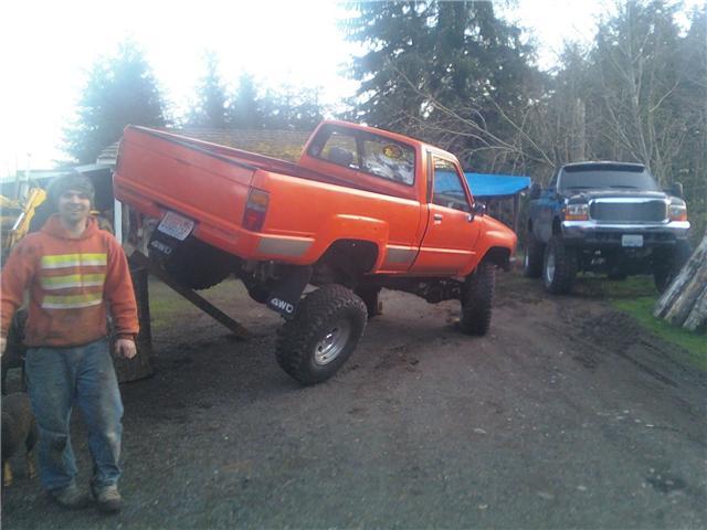

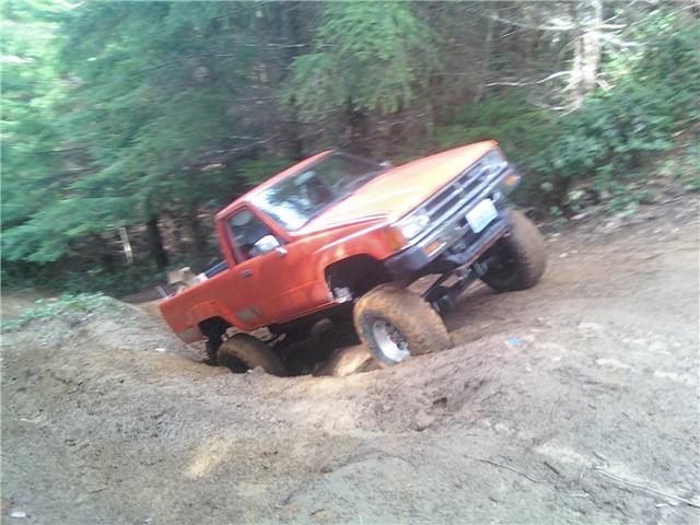

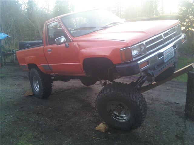

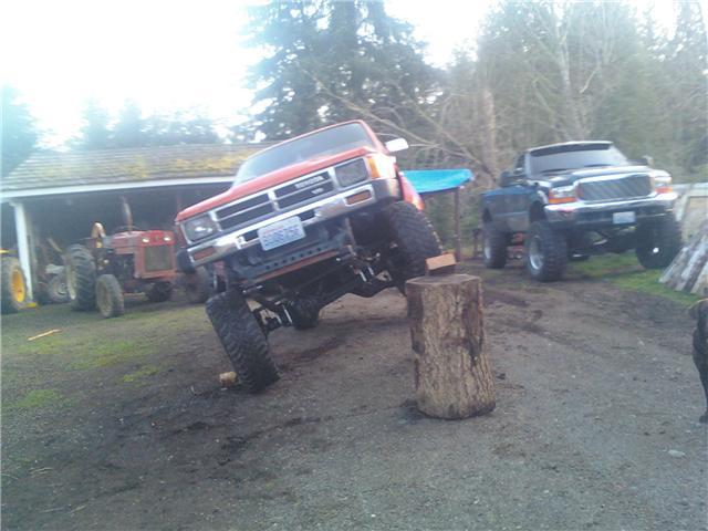

Everythings done now except welding on my knuckle gussets and rock sliders pretty much now. Did some dinking around the other day testing flex and all that fun stuff. In case anyone was curious i guess 87 stock calipers off an ifs truck bolts directly on to a solid axle and works also. Just a couple flex pictures for the moment apparently corey had to flex his race car on my yotah lol. Will update again when i get the gears broke in and start trail cruising im still currently debating on the bobbing of the bed also

its not literally a race car its just the daily driver its nic name is just the race car cause its its liek a 29 second quarter mile runner like all geos lol

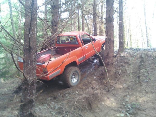

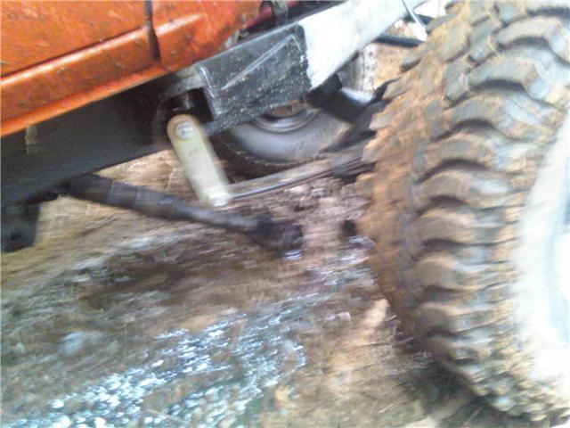

went out and played on the local little wheelin spots around town yesturday 1st just dickin around
2nd where i broke my truck
3rd the culprit was i tore all the threads out of my pinion nut in the middle of a quad trail
this week itll be getting bobbed on the bed roughly 13 and a half inches is what im thinking and got laid out at the moment so more to come

well been getting work done lately and wheeling and denting the holy piss out of my unit it was straight till a week ago....... lol i hit a buddys home made trail to test the rock sliders and they worked apsolutely great untill those awkward angles side hilling then it just really crushes in the bed. So instead of hammering like crazy like i did my fenders to restraighten them half way out (driver was crushed to the engine compartment) i decided to bob it which got rid of 2 goodsize ones ive hammered a few out of my bed and then said screw it no sense in tryin to make it look pretty now
