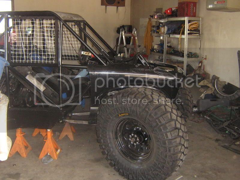

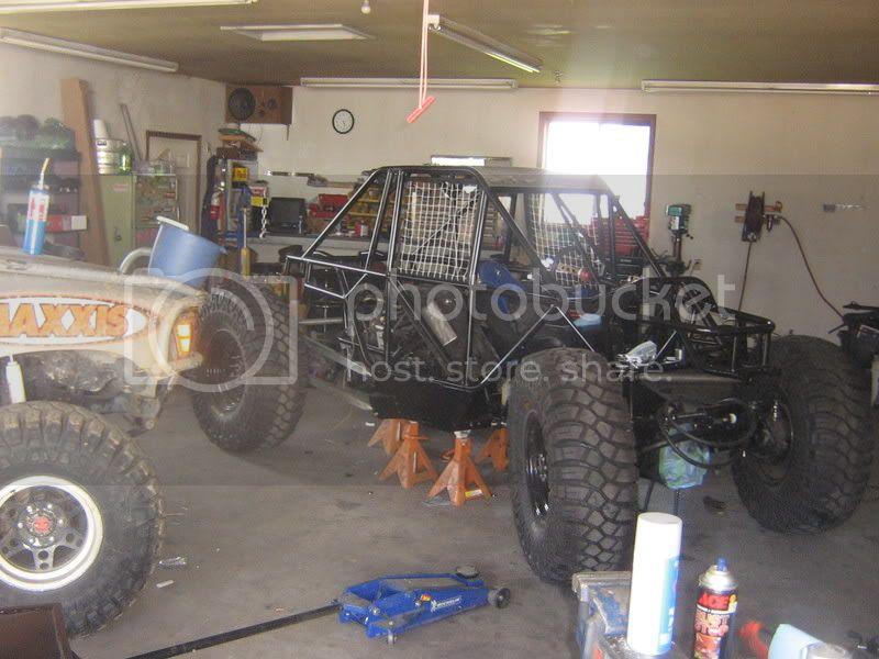

weekend progress
I gotta get this skins on cause they look bada$$!!!! but no time

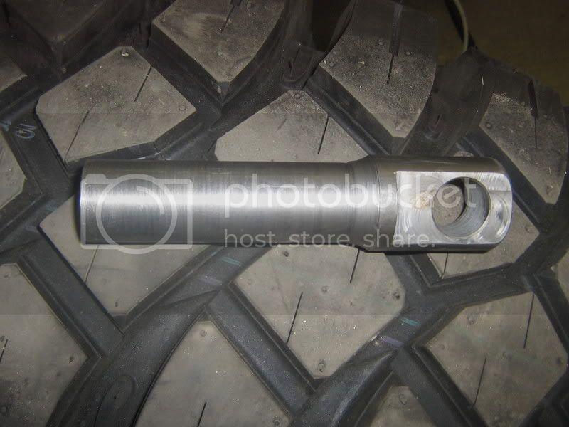

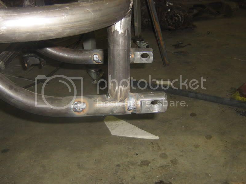

Kraus machine by my place custom made these for me
Custom shackle mounts for 1.5" tube and std shackle
They said they'll make more for whatever size tube for $50 a pair if you want some let me know

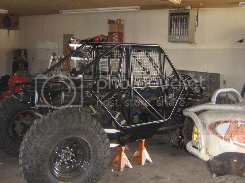

This is the best pic I have of it right now

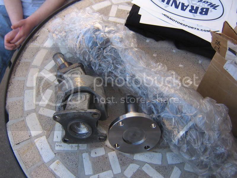

The small in the center was made for me by Branik Motorsports
It started as a solid chunk of prehardened chromoly and they turned it down to be a transaxle output to toyota flange for me!!!! Custom ford taurus splines on one side and toyota flange on the other. They can make about anything you need! I'm glad I got away from the welded CV shaft that's on the left and was a known weak link.
Kickass Travis !!
man this is awesome seeing all these rigs coming to gether Im so stoked !! :woody:

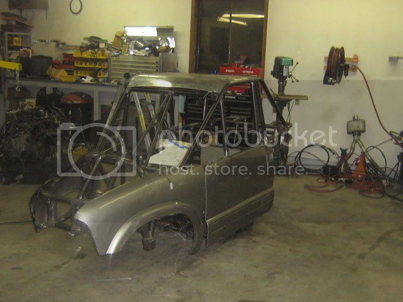

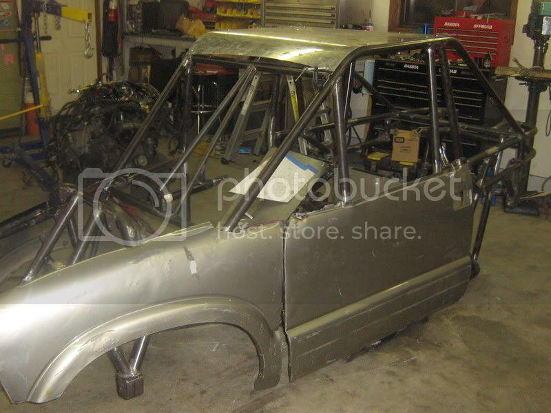

really really want to get some skins on it to look like an s10. It's bigger than most single seaters but still a small bastard and I spent some extra time getting it proportional for an s10 body in the future. In my mind it's just not complete till it looks like I see it in my head.
In the future I'd really like to have multiple engine/trans combos ready to drop in and swap around to find the best combo.
