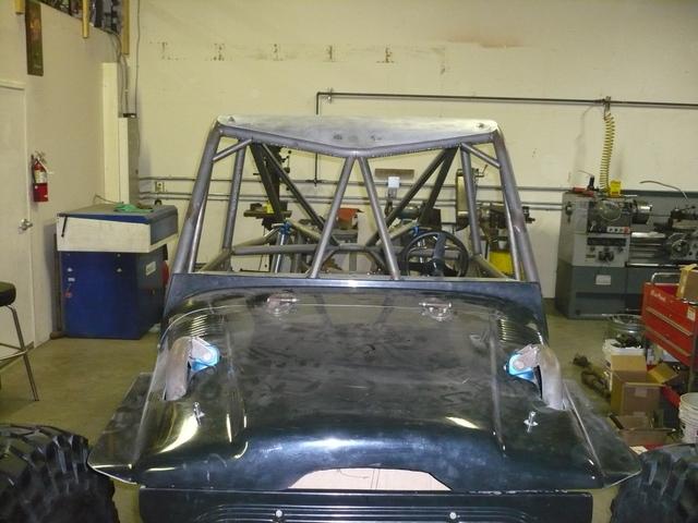

Here's progress from the other night, i'm about to head back tonight and slowly make more progress.

ok, had a hiccup but it's over with. I noticed when i tried mocking up a driveshaft for the front that i had some major interferance with the starter, so i had to raise the engine 1.5" . I went ahead and junked the old mounts, and made some new ones. On the upside i now have more room for headers, and my hydro pump. Anyways glad i found that little mistake before i got too far ahead of myself.
