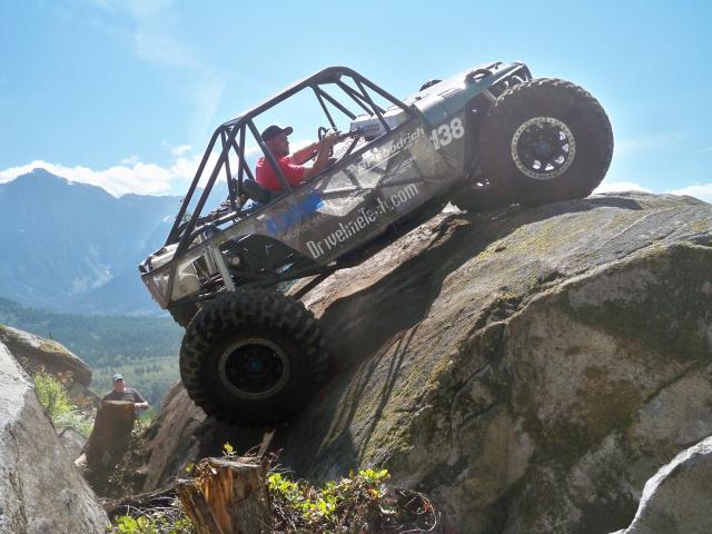

This is my buggy
It does OK
. I am not the owner of drivelinetech, but i will only run his drive shafts.
