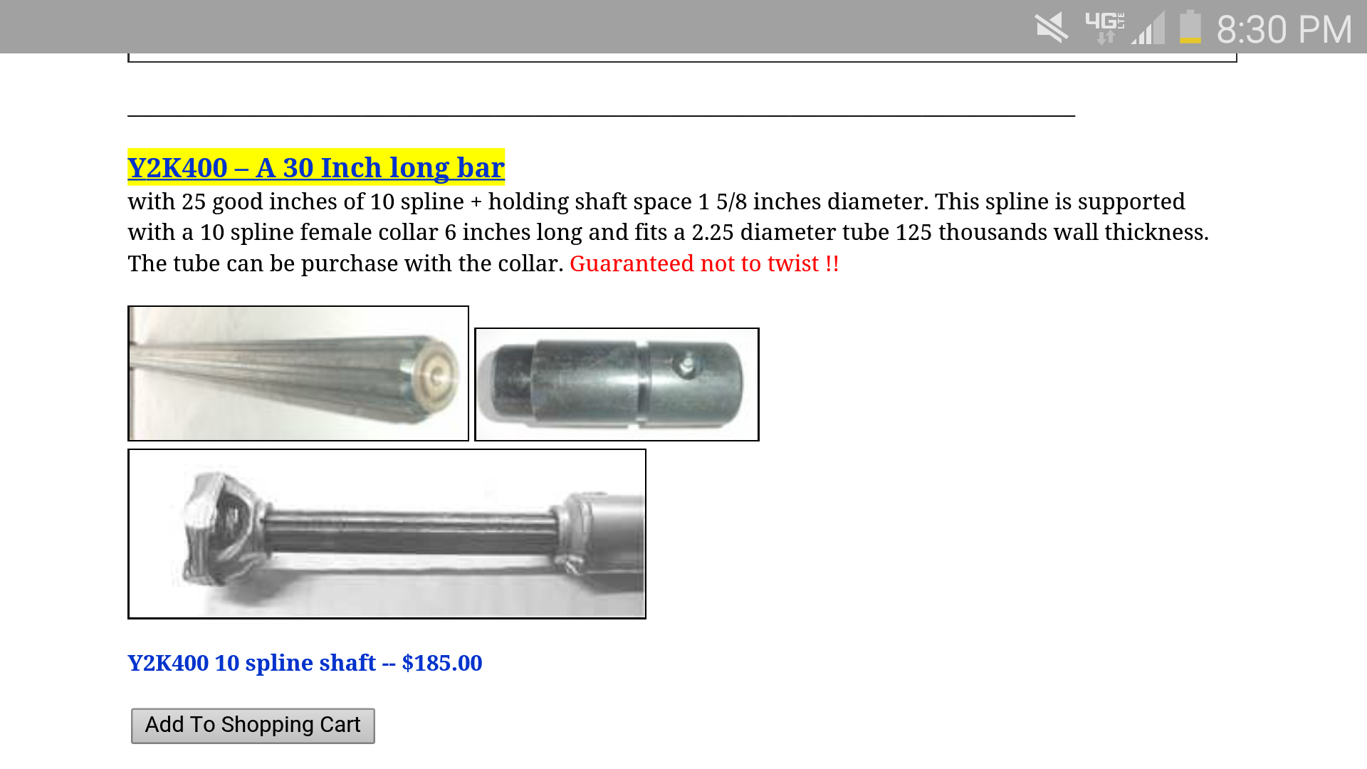

Question here from the stupid fella... What makes that shaft a PTO shaft? Still learning everyday..
*NOTE* - any funny comments, jokes, Internet bullying, ETC about my question will In no way hurt my feelings fukers. :woot:
Because the spline section and that lil female part are tractor PTO shaft parts. I reckon they work fine, lots of people run it.

Batmobile Will said:
For the driveshaft question that's what warfare and plowboy and a lot of other high horsepower buggys are running
And we've seen at least plowboy and showgirl break them. . hell I've seen plowboy break a couple with my own eyes.
I'd sleeve the transition from the female spline to the tube with another section of tube and weld it all together.
Mine will be drivers drop , makes life easier and guys I really don't mind questions I'll answer them the best I can .
So what is the plan for knuckles and C's?
I don't know where you got your info, but i know for a fact Plowboy isn't running pto driveshafts. :****: Glad to see you are upgrading your axle, it's cool seeing you build it on a budget, well sorta :drinkers:
Looks like this is part of his driveshaft . Doesnt appear to be pto shaft. I ran this same shaft. Plus they guarentee it not to twist
