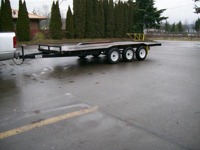

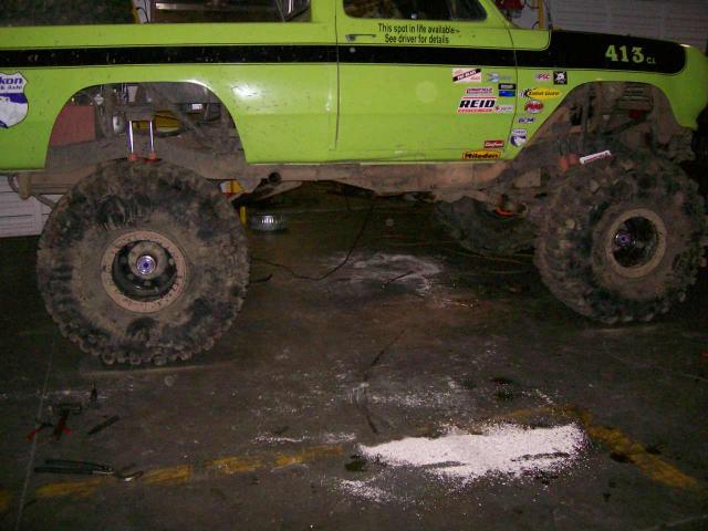

took some time to remodel the trailer that the pig calls home I added another axle...drive over fenders plus mudflaps

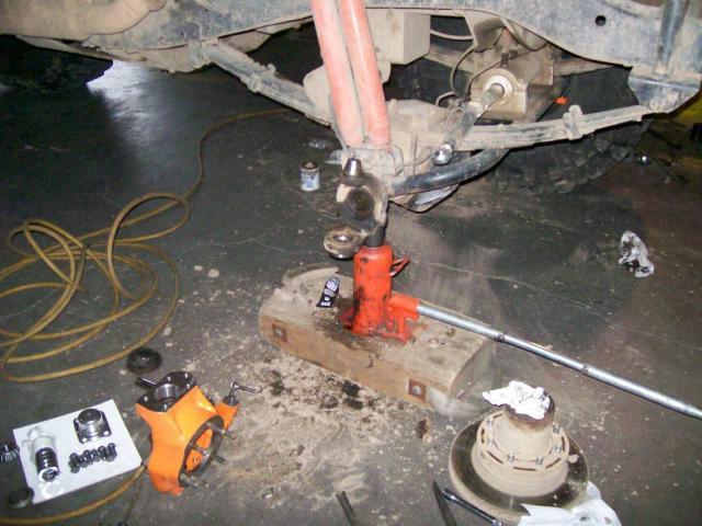

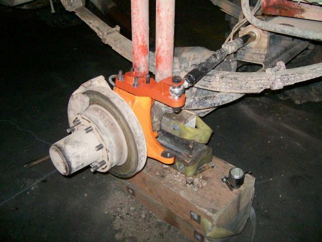

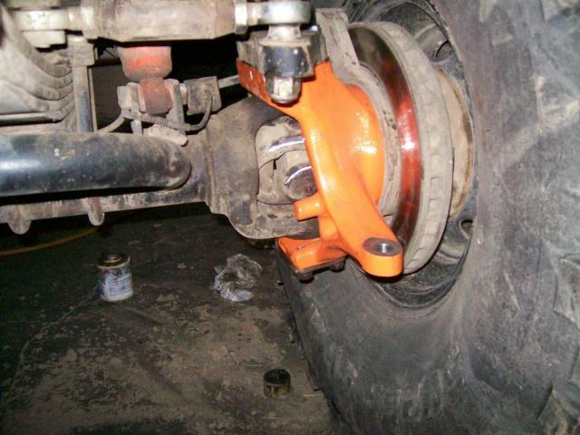

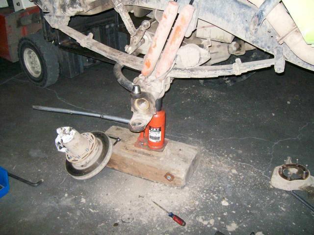

back to the remodel I worked on the front today got the knuckles swapped....I plan to remodel my new highsteer arms and make them double shear instead of single as the single shear tend to loosen up. So i put the old front arms back on untill I remodel the new ones.

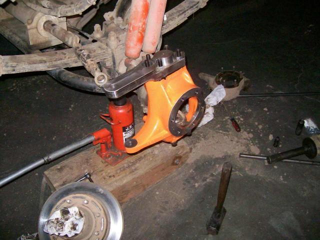

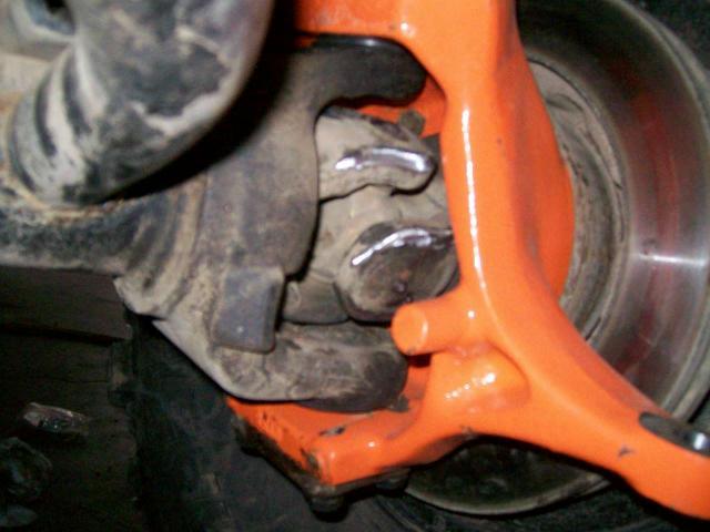

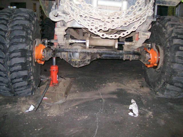

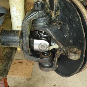

I used a 40 grit flapper disk and high speed angle die grinder to remove enough material on the yukon's to go thru the knuckles being careful to not create any sharp edge's where a failure could start. last pic is front all back together.

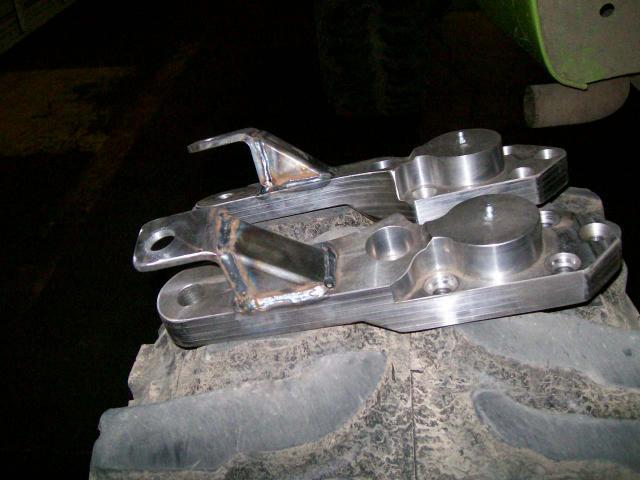

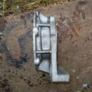

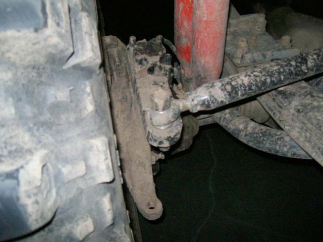

thanks Odie.....I reworked 1 set of arms 1st pic is what they look like in their natural state second pic is altered state

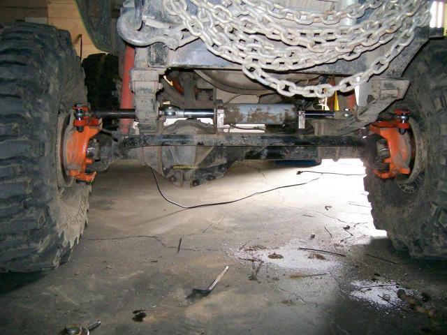

Front is done...fabbed some doubleshear brackets for the new arms and built new tierods also rotated the clyinder to protect the hydro lines better
