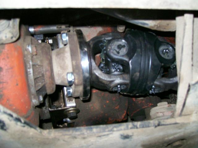

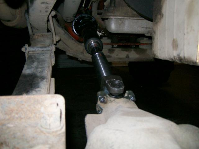

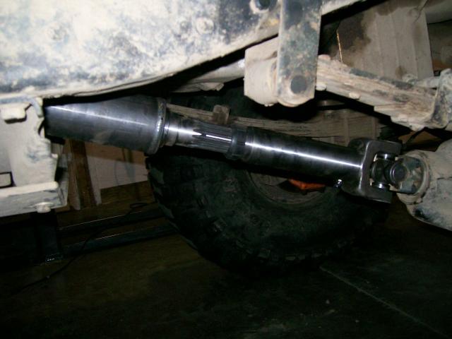

here are a couple of new ones.....I had to drll the 203 flange fron 7/16" threaded to regular 1/2" to use the metric bolts on the new driveline....This thing clears everthing nicely....But when the old one broke it bent the **** out of my shifter linkages so I needed to fix them up a bit.... Here are pics of then monster shaft installed.

looks like it bent the shackle also...look at the last pic...im in the market for a new front d-shaft myself, im curious how yours hold up...
shackles are both wacked like that from running over 4ft stumps I plan to buy some (gasp) jeep shackles and remove the rivited frame bushings then plate the frame and use 1.75" dom with (gasp) jeep poly bushings:D

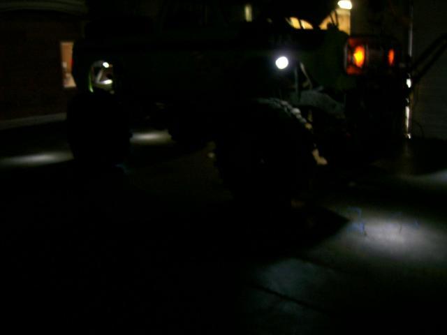

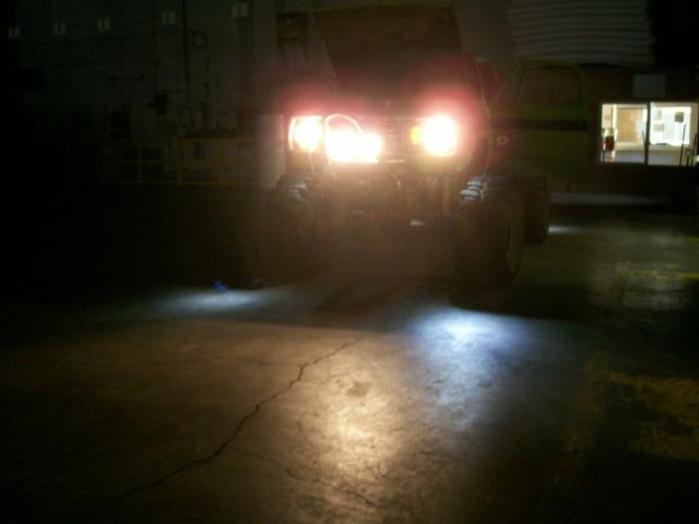

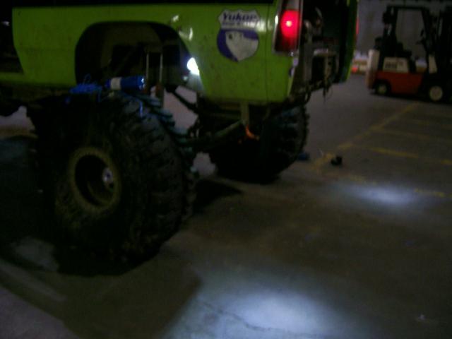

well after the flop I figured I would try to straighten the side a bit...so I took it off and laid it on some cardboard and jumped on it :redneck: then got after it with a 5lb hammer and oak block got it straight enough that you can hardly tell it flopped :haha: also working on my rock lights I have the rear done wiring up the front

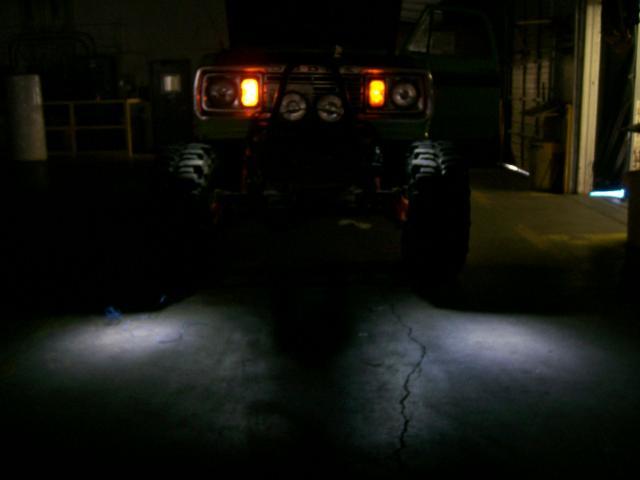

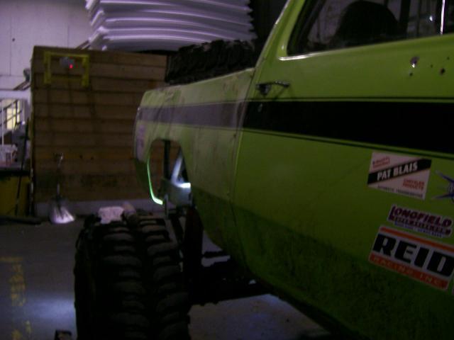

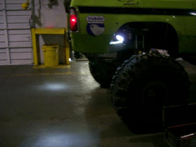

Front rock lights done I may need to get 2 for under the center of the truck as well.....
