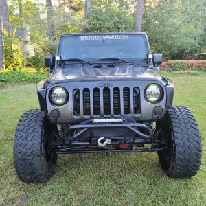

How hard will it be to get in/out of with that rolled bar coming down through the side "window" opening? Looks tight.
Re: buggy build "indecision"
It's not as tight as it looks. I'm 6' 205 so I should be ok. Don't think I'll be falling out of it though. Lol

Very good looking chassis! Some hard earned wisdom I want to share with you is leave room for a different tcase! The 300 won't make it!
There's plenty of room for an atlas which is on my expensive **** to buy list. I'd like to have a 5:1 atlas as soon as it's possible.
And thanks. Travis built exactly what I wanted.

5:1 is really low! What gears are you planning to run in the axles? 3.73?
Right now I'm at 4.10. The axles were in my last buggy and it was sm465/203/205. I would rather gear through the case than in my axles. I try to avoid the tiny pinions. My case has the lomax 4:1 kit in it.

I wouldn't order the atlas until after you ride in it with the 4:1 break it first then put a stock 300 in it while you wait on the atlas! Just from the looks of the buggy you plan to go fast when mine had t400 3.8 and 4.88 it was all in the limiter in 3rd went to a 3:1 and it was about right IMO fwiw
Ya I plan on getting it going then seeing what the gearing needs from there. It will be a while before I can afford an atlas. The t case and a set of rcv's are the only two upgrades I have planned in the future, Other than some engine mods to add a bit of Woopow. I'm gonna have to recoup from the build itself first.
