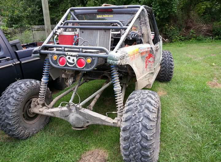

Pholman, the buggy is looking good. I am seeing how you have you shocks mounted. Seems like most of the time people run the eyes of the shocks 90° apart. Where the top shock bolt is pointing toward the engine the bottom shock bolt is running from front to back on the rig or vice versa. I have always heard you do it like that to keep them from binding and breaking the shock. I noticed a blue Rockwell buggy on here is like done like yours, I was going to mention in his build but thought I needed to look around a little first. I started looking on WOD instagram and all his builds the shock eyes are 90° apart. Just something I think you should look into. It would be great for some of the reputable builders or tech gurus to chime in.
Thanks Casey. I know it's killing me to have to leave.
Kevin, I'm all ears. I may need to turn them. For some reason it made sense at the time. I think because They are laid back quite a bit. I didn't even take into account the twist during articulation. I'll look at it when I get back from vacation and see. Good call I'm open to suggestions hints and tips from anyone that knows more than I do, which isn't hard to achieve.

If you are like me I can't afford to go ruin a set of coilovers. Buggy looks great.

I think I'm "blue rockwell buggy", maybe not. Both of my bolts run with the frame,where as yours run with the axle. I originally tried that but had to much articulation in the axle. it took me almost an entire night of cycling the front axle to get zero bind. In fact I made temporary brackets on the axle end until I got the angle correct. Somehow, I forgot to beef them up, until I read this.

No guru here, but the 90* is mainly for packaging on the upper mounts. On the lowers, the bolt should go in front to back as that allows the shock mount more range of motion. Flexing the suspension while mocking up the shocks allows you to see potential binding. Shocks with high mis-spacers net about 35* where shocks like Fox that use the little spacers net a bunch less.
Mounting the two eyelets 90 off is negated by the shaft being able to spin in the body.
But I dunno...
I would think it kinda depends on the shock angle front to back. If they're fairly straight up and down then I'd say mount the bolts parallel with the frame since you'll have more variation in the C/O to axle relationship. If you're flex nets you a 45° angle between the frame and axle, then you'll have damn near 45° difference between the axle and C/O which you might only achieve with pivoting on the bolt rather than the spacer
I ran my lowers pointed at the transfer case output and angled down a little towards the front to prevent binding, seemed to work well.
