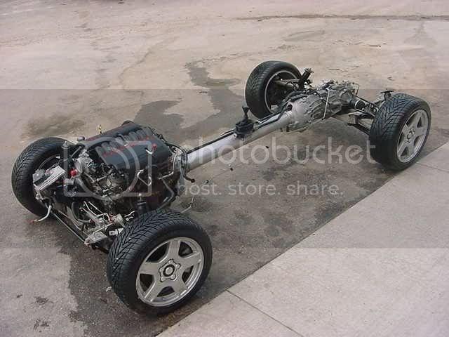

Screw those beat down no harness/accesoriy having turds. CALL these guys, they get motors direct from trucks that GM can't leagaly sell. They normaly have some alot cheaper than what's on ebay.
Some of their stuff has less than 100 miles, you can even buy a whole vette drivetrain, and d-max's.
