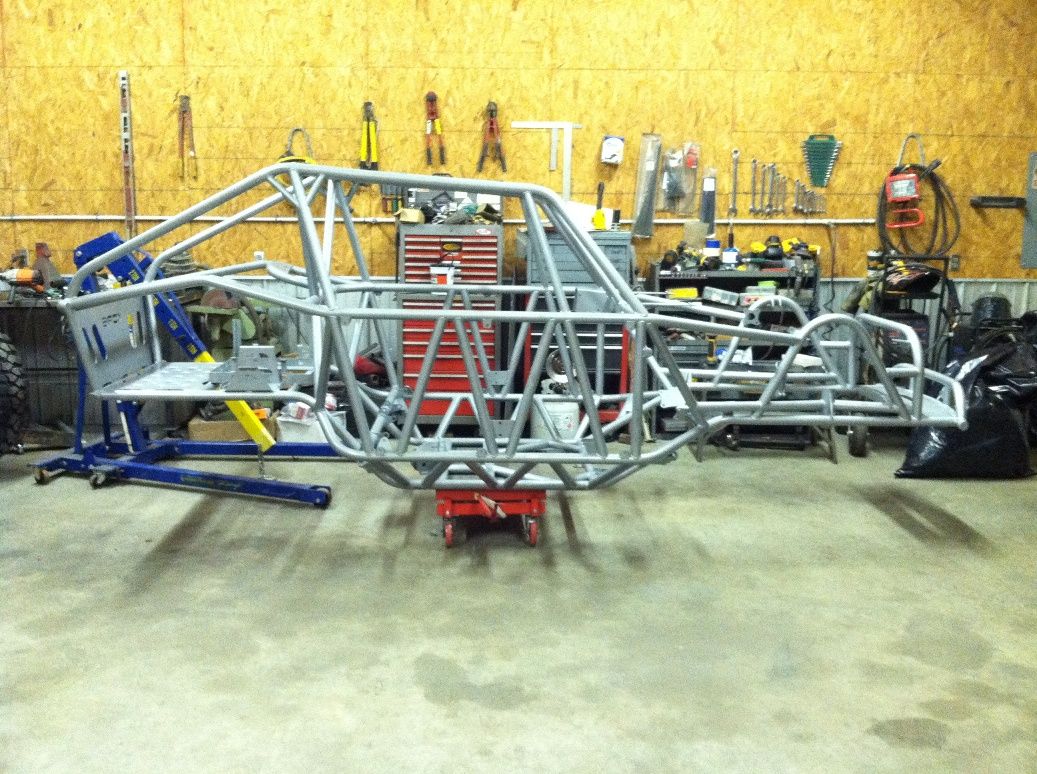

Cpl more pics, the pic Mo posted is awful blurry, iPhone camera goin down hill, shop atmosphere gettin to it
how did you paint yours? spray bomb or ? and what brand paint did you use? my silver didn't come out near as nice as yours did.
I used rustoleum :****:
i primered it with Rustoleum automotive primer then wiped it down to remove any overspray , then i used the Rustoleum hammered finish universal for the base coat, then when back with regular rustoleum hammered finish for the top coat.
