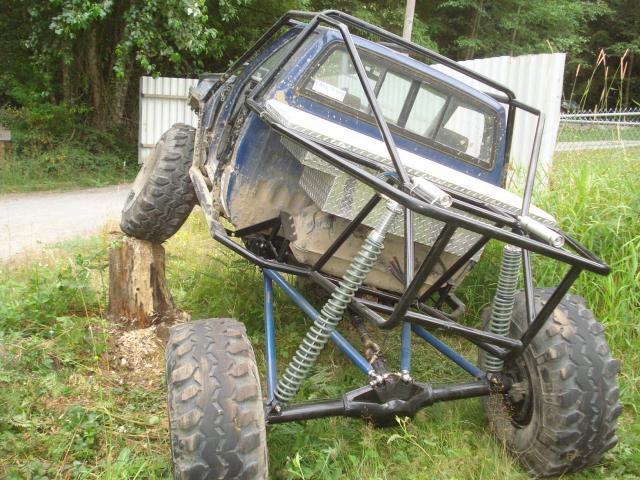

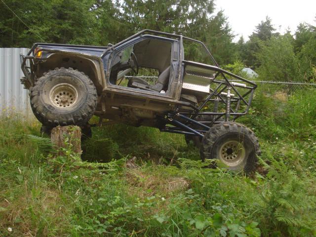

:bling:Some flexed out drive way poser shots.

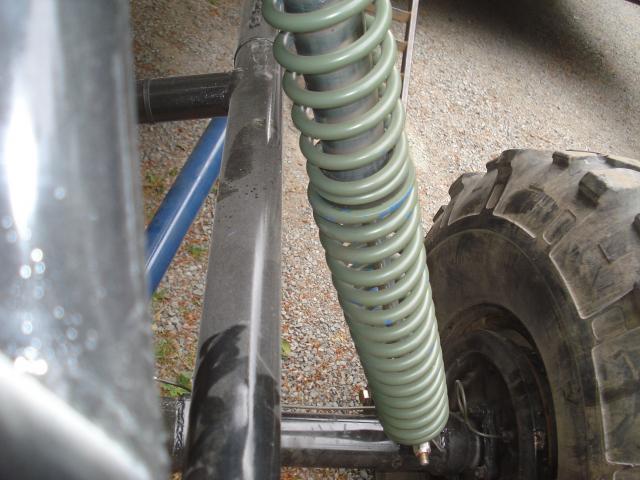

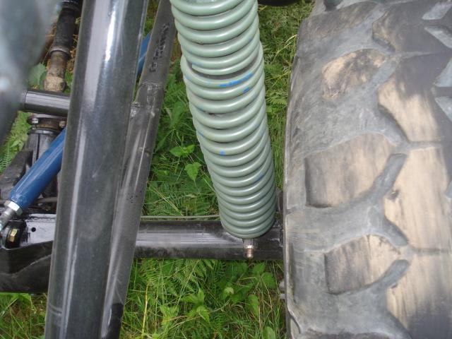

Last two are of shock clearence at stuff and droop. It clears the frame and tire nicley.:awesomework:

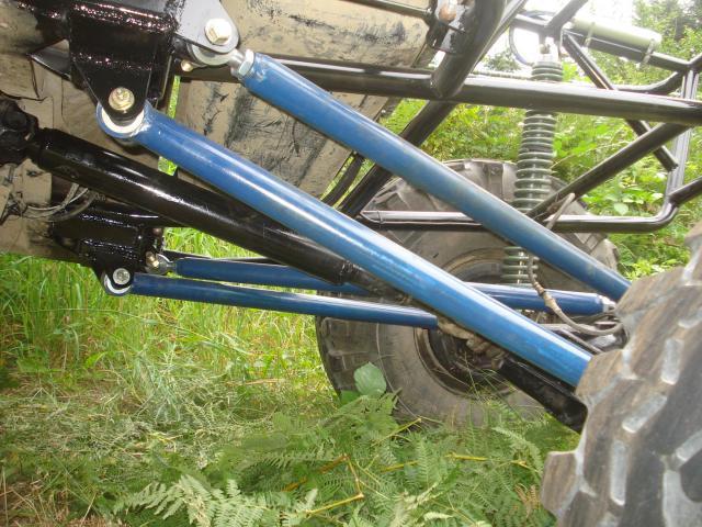

I went ahead and ripped the front end apart and swapped out the stiff front leaves for some longer and softer hybrid packs built custom just for this here rig.:redneck:
I made a few tabs and extended the front about two inches. That combined with the new springs pin location moved the fornt axle foward 3 inches. Now my wheelbase is 111 inches.
Should have alot more travel. Just have to get the drive shaft done and flex it up this afternoon.:awesomework:

2nd pic post 139...why is your upper spring sitting there??? Ya got triple rate for it? How is the spring cup retained on foa c/o's??
The dual rate sliders between the springs is a little tight on the shock body. It needs to be machined out just a little to slide easily.
The lower cups are like the other coil brands just cast, not billet.
Whats the hot ticket to keep the coil centered on the lower cup. It seems to be a common problem on coil rigs from what I have been hearing.:mad:
On mine I just drilled a couple small holes and zip tied the cup tothe spring.....It can still get cockeyed at the bottom but rarely does.
Ive seen the same thing but with saftey wire instead of zipties. They hold fine, dont break/rip (zipties)?
I have even seen folks JB weld and silicone them on. I liked the hole and tie method myself. But I like the fact that the zip ties wont wear a rusty mark/stain where the cup meets the coil.
It works way better than before now that I have the front springs swapped out. It will put a tire up my trailer till the rear pumpkin touches the deck. The front splits the work with the rear now instead of just following the rear and not working the front.:awesomework:
