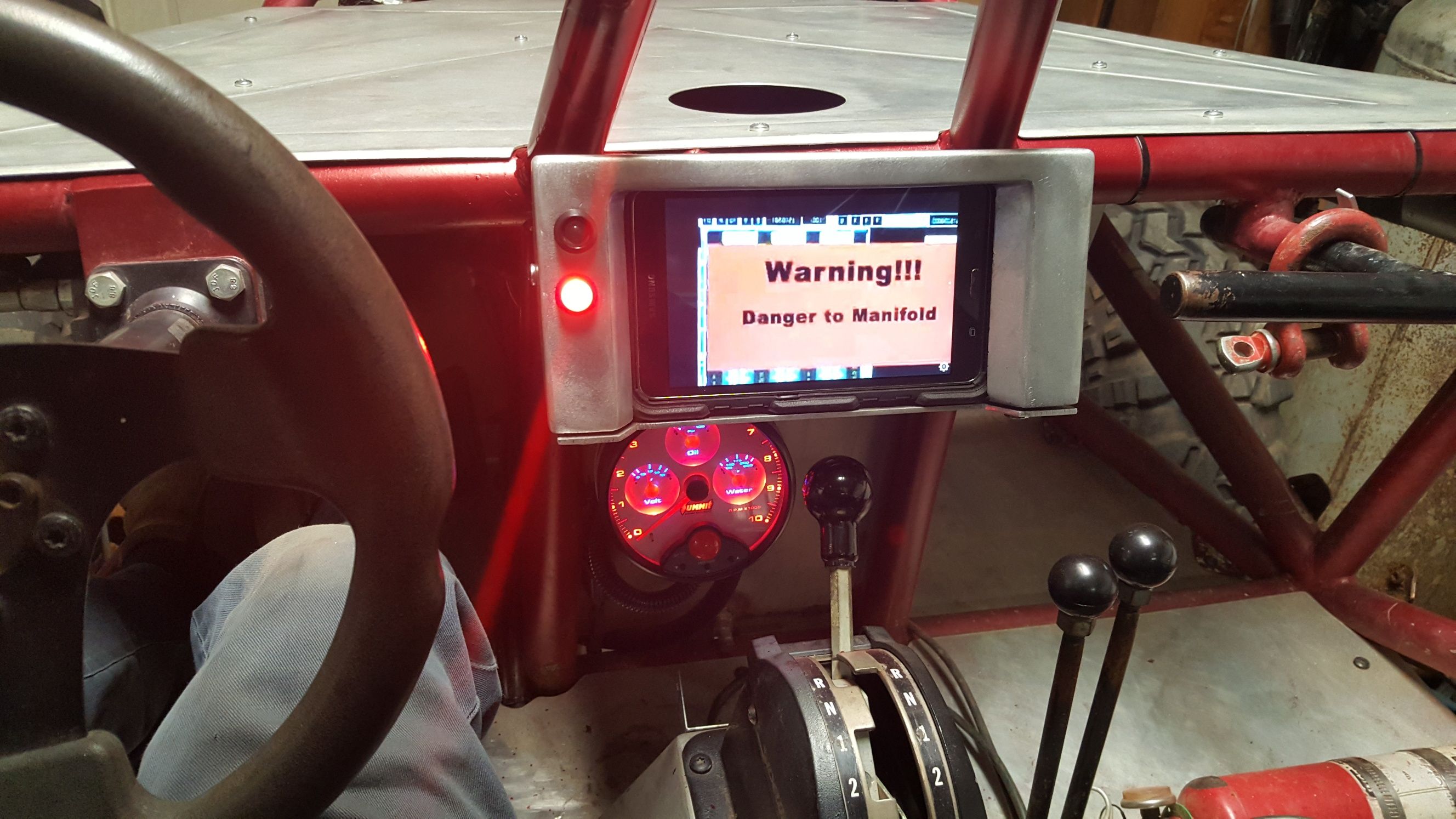

I have been working on getting a tablet installed in the dash of my buggy for a while now, finally had some success. Hardware is a Samsung Tab4 repossessed from one of my kids. A OBD2 dongle from ebay and the Torque Pro app. The dongle runs just over $20 and the app is $5.99 plus a tablet which are not overly expensive these day.
Engine is a 2004 LS, TH350.

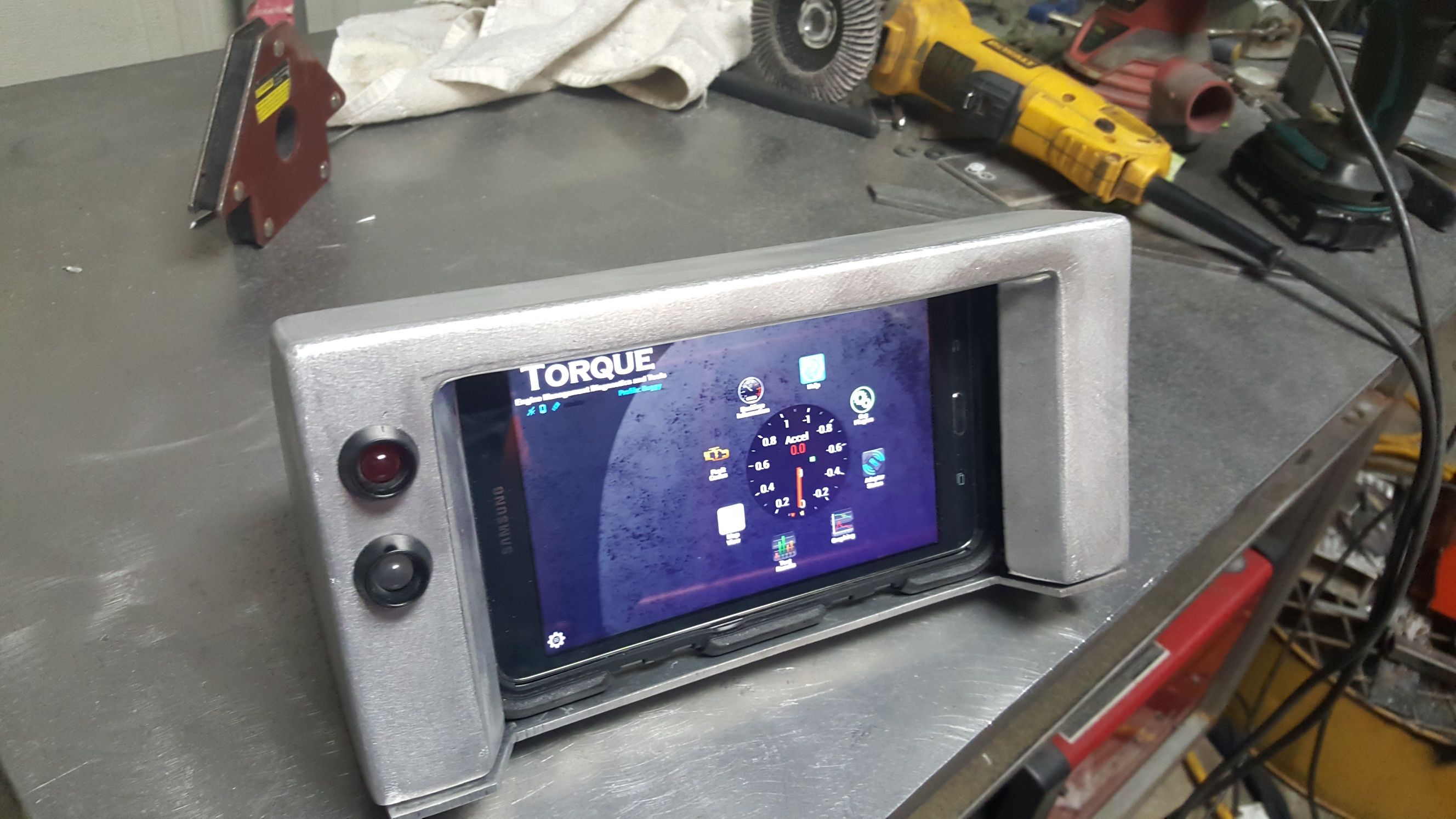

Started with some 2"x 6" aluminum tubing cut up and welded into tablet mount. Tablet slides in from the bottom. Added warning light for coolant over temp and low oil pressure and charger to the tablet.

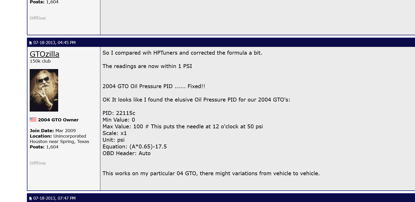

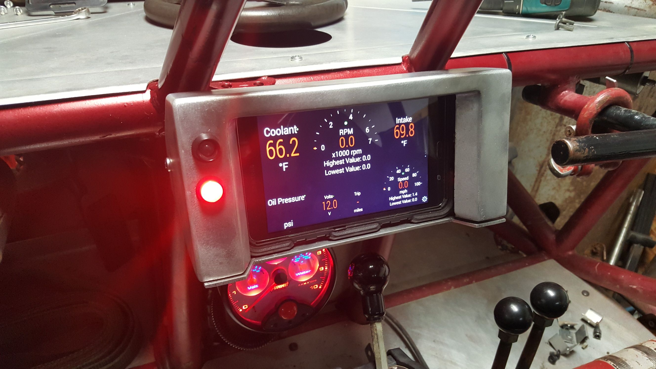

I was able to get the tablet mounted in the buggy and just barely had room to not hit when shifting into park. I was able to get engine rpm, coolant, voltage to read on the app without any problem at all. I could not get the engine oil pressure to read. I could add a gauge but it would not read anything but a -- on the screen. I had originally deleted the oil pressure sensor from my harness. I added the sensor and wires back to the ecm. Still no luck on reading correctly. Searched for a couple of days on and off and finally found a solution on a GTO forum.
You have to manually add a custom PID into the Torque app to get the gauge to read correctly
Navigating the app from the home screen go to settings - manage extra pids/sensors - add custom pid (top right corner 3 dots). This will pull up the OBD2 pid editor. Enter the info below into the spaces. Click OK at the bottom right on the screen. Then you can go back to the homescreen and then to real time information. Add gauges as you see fit onto your screen. The green highlighted pids are available to be used as a gauge. The custom oil pressure pid was at the bottom of the list for me.
The oil pressure no reads correctly for me. Seems to be very accurate down to less the 1 psi. I can live with that!
Once you get the gauges added to your display you can even set a high or low warning. The display will flash the gauge to get your attention. I'm not sure if I like it as much as a dedicated warning light but it does work.

When you do get a pid working as a gauge you can tune in the formula for more precise output. On the oil pressure pid above you can see the formula is (A*0.65)-17.5. You can change the 17.5 to get the gauge to rear dead on. My oil pressure gauge read 1.6 psi at atmospheric pressure. I went down a bit to around -15 I think and ended up with the gauge reading 0 psi with the engine off.
