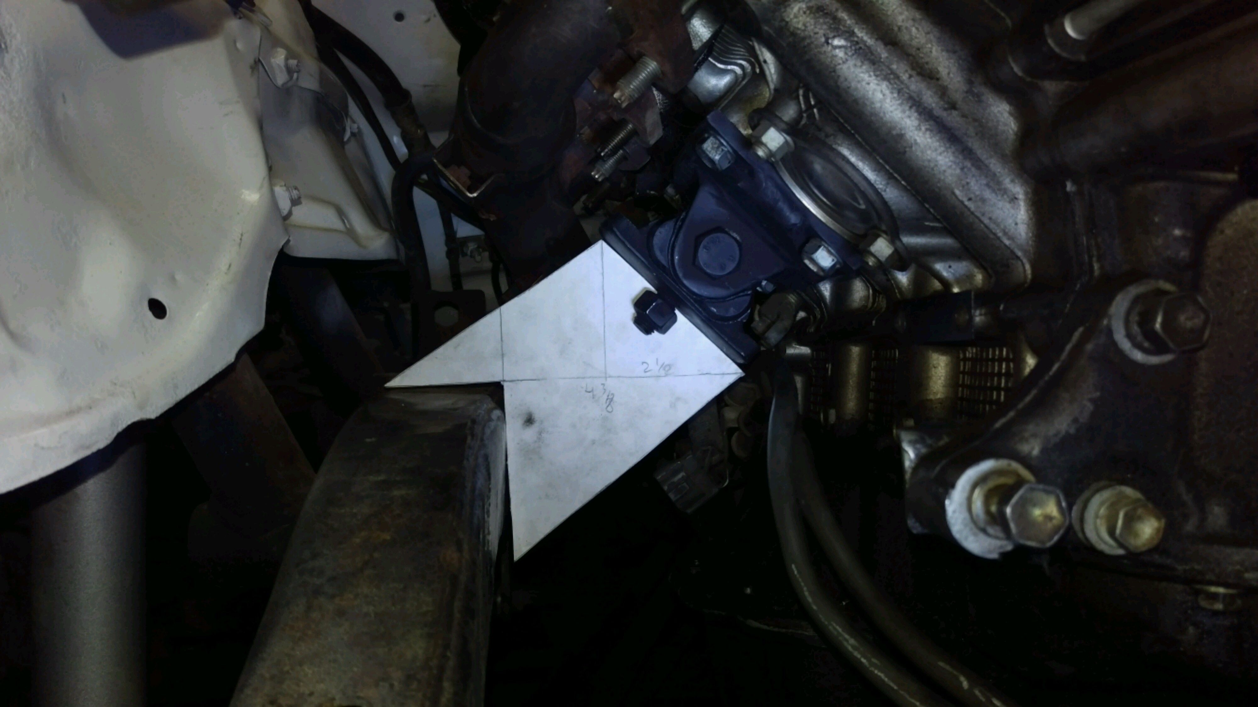

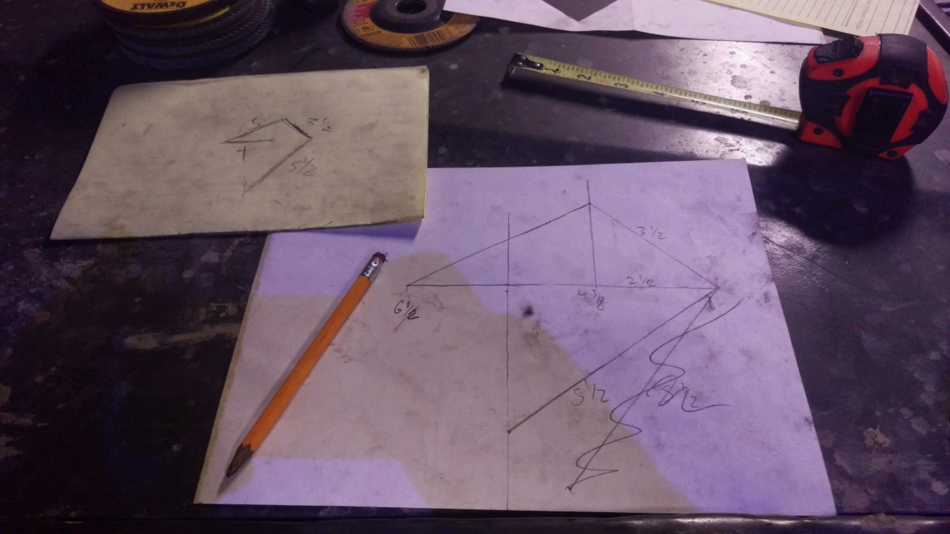

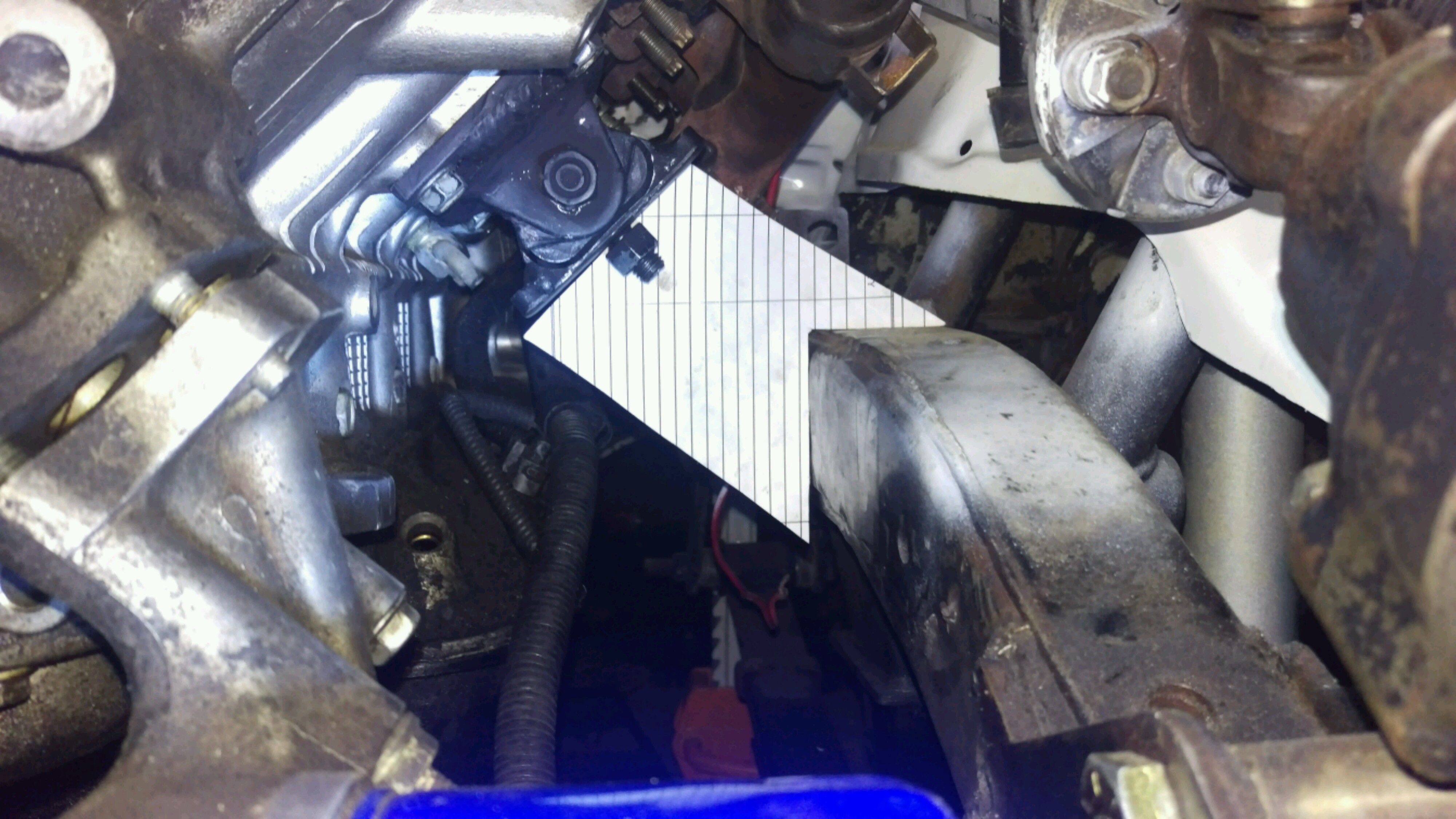

I used paper n pencil n simple geometry to rough in the frame perches.

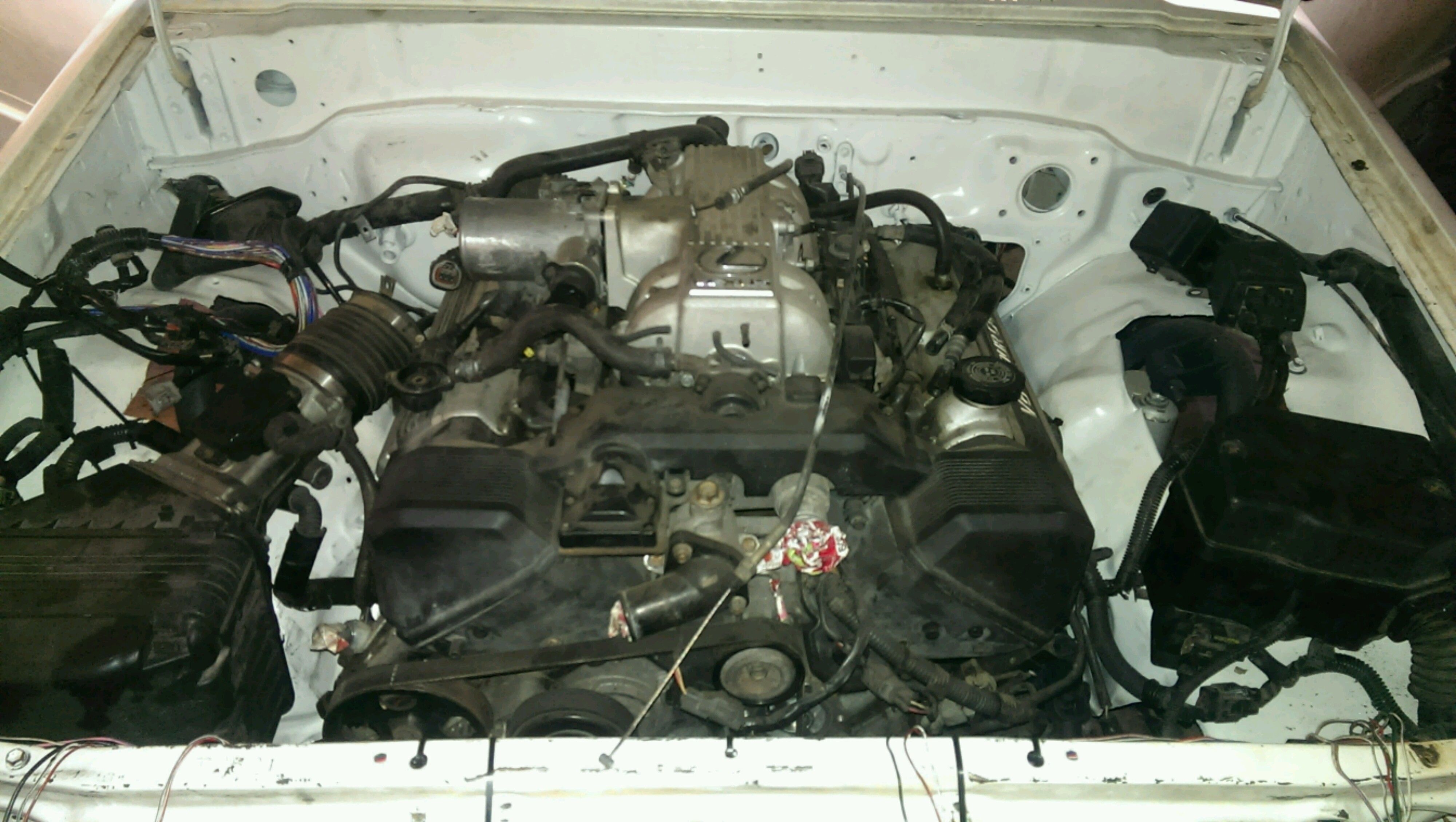

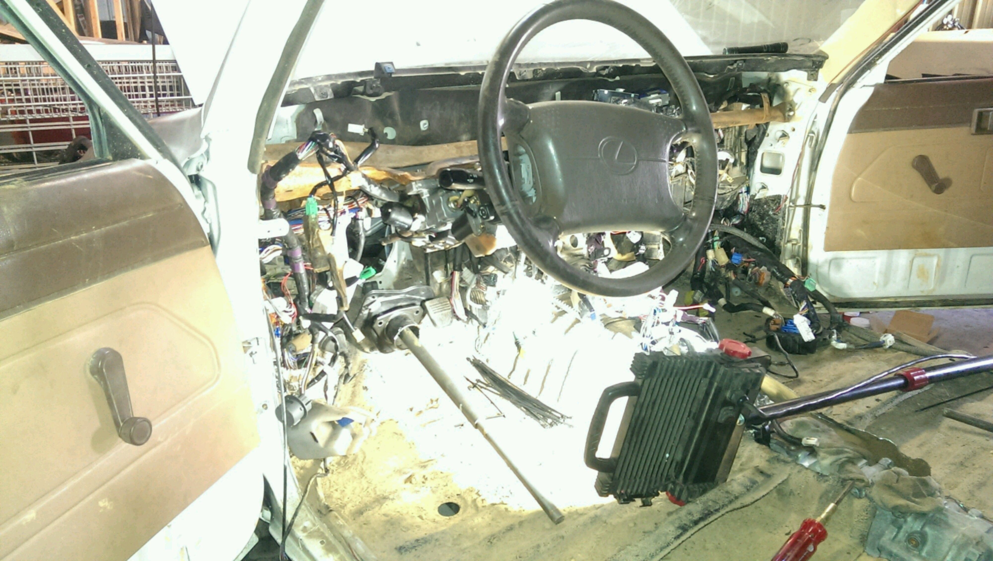

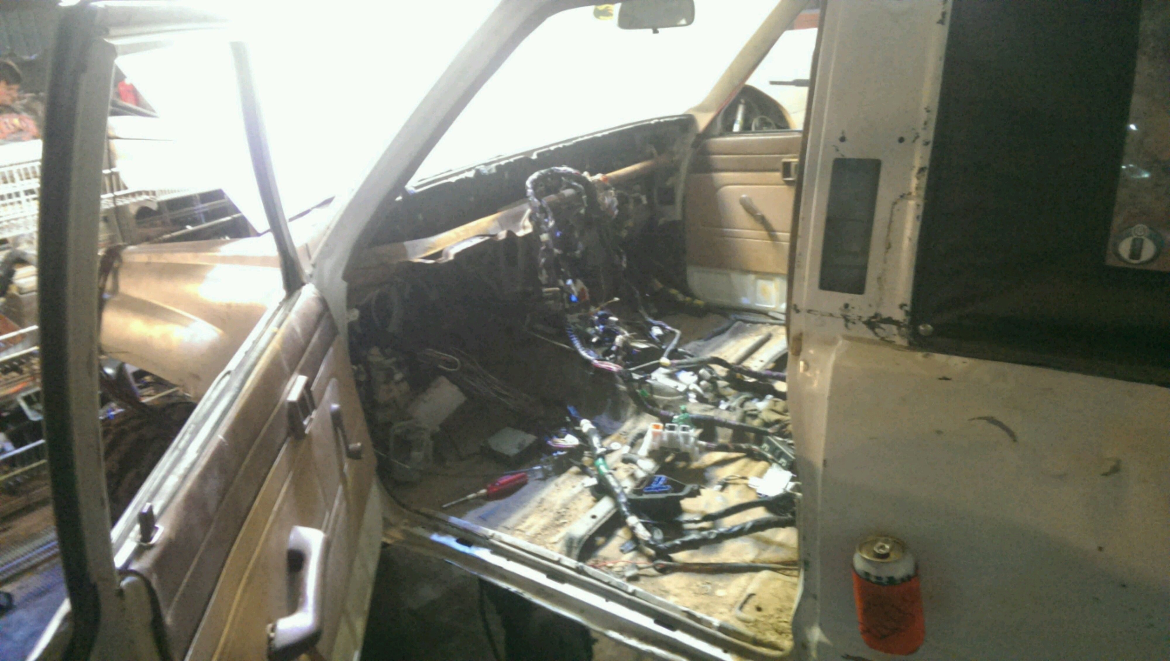

Well it looks like I'm over due for an update. The engine and drivetrain are in the truck turn key ready! All the Lexus wiring, electronics, steering column, and shifter center console have been retrofitted. Everything fit exceptionally well into the 4Runner! Now I will be moving on to install the fuel system, cooling system, braking system, fab the front driveshaft and fab the dual straight pipe exhaust then she will be ready for a good ol' V8 beating!!! :driving:

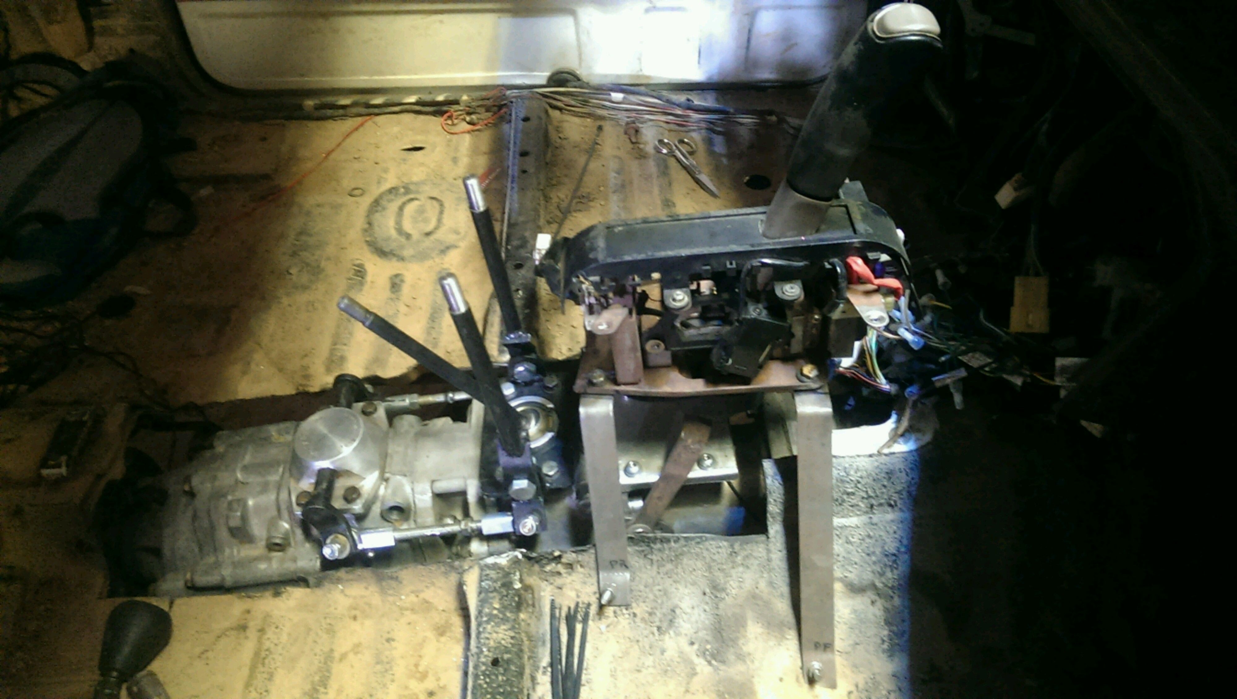

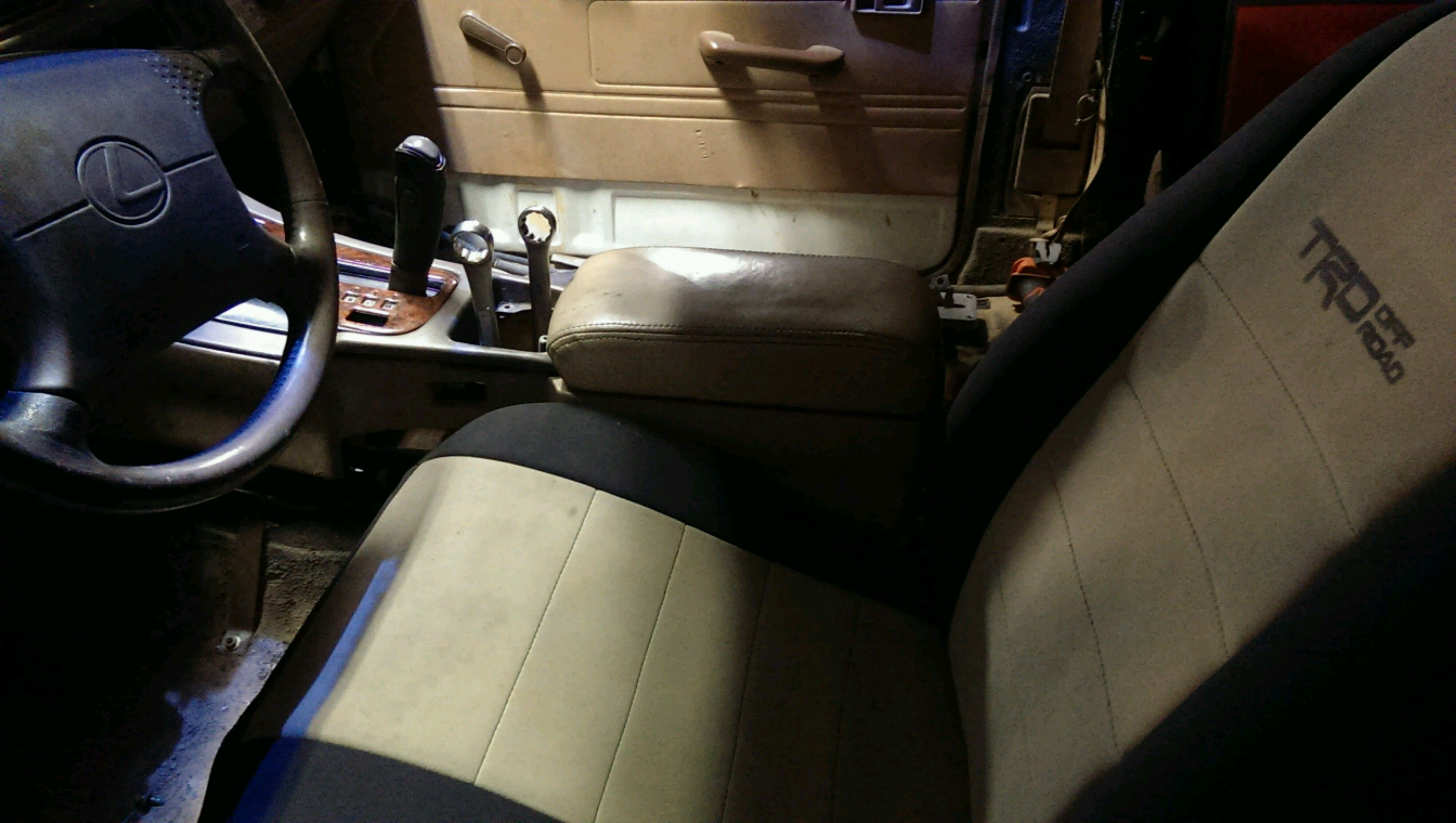

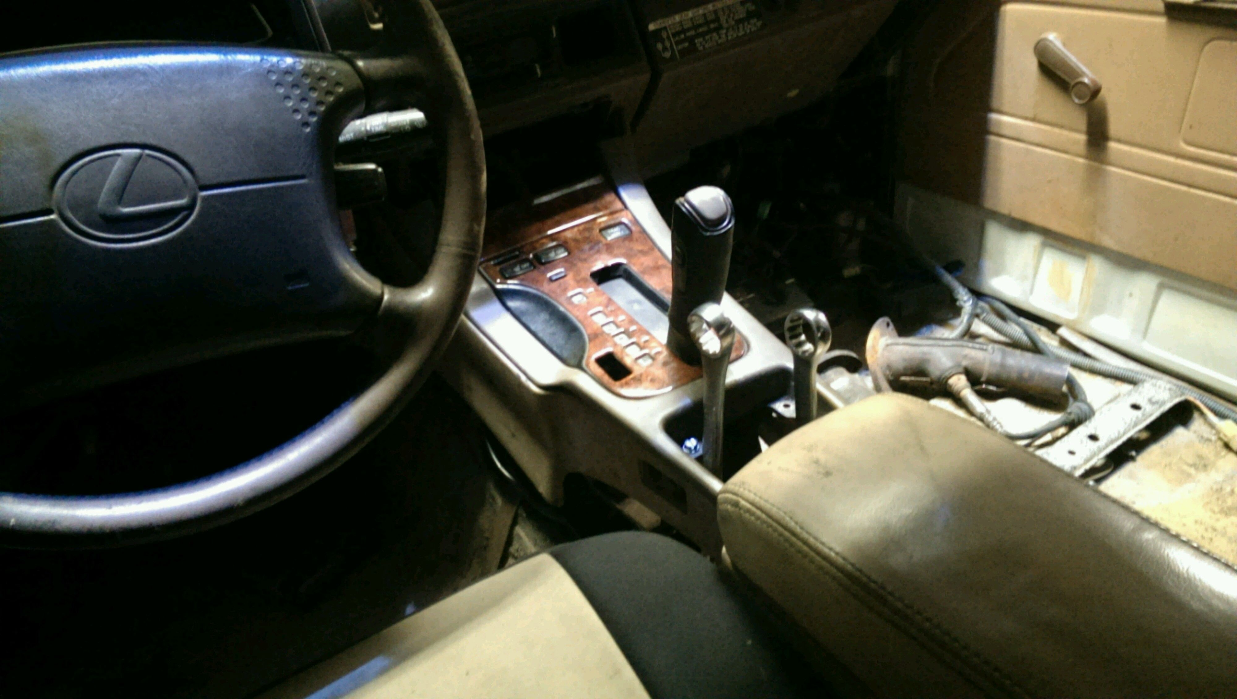

I got the shifters mounted and finished up the center console retrofit. I ended up cutting the double den head unit out to make it fit the way I wanted, oh well, no fancy radio! I installed a Davez Offroad Performance triple shifter kit and customized the shifter handles with 1" hand wrenches!
