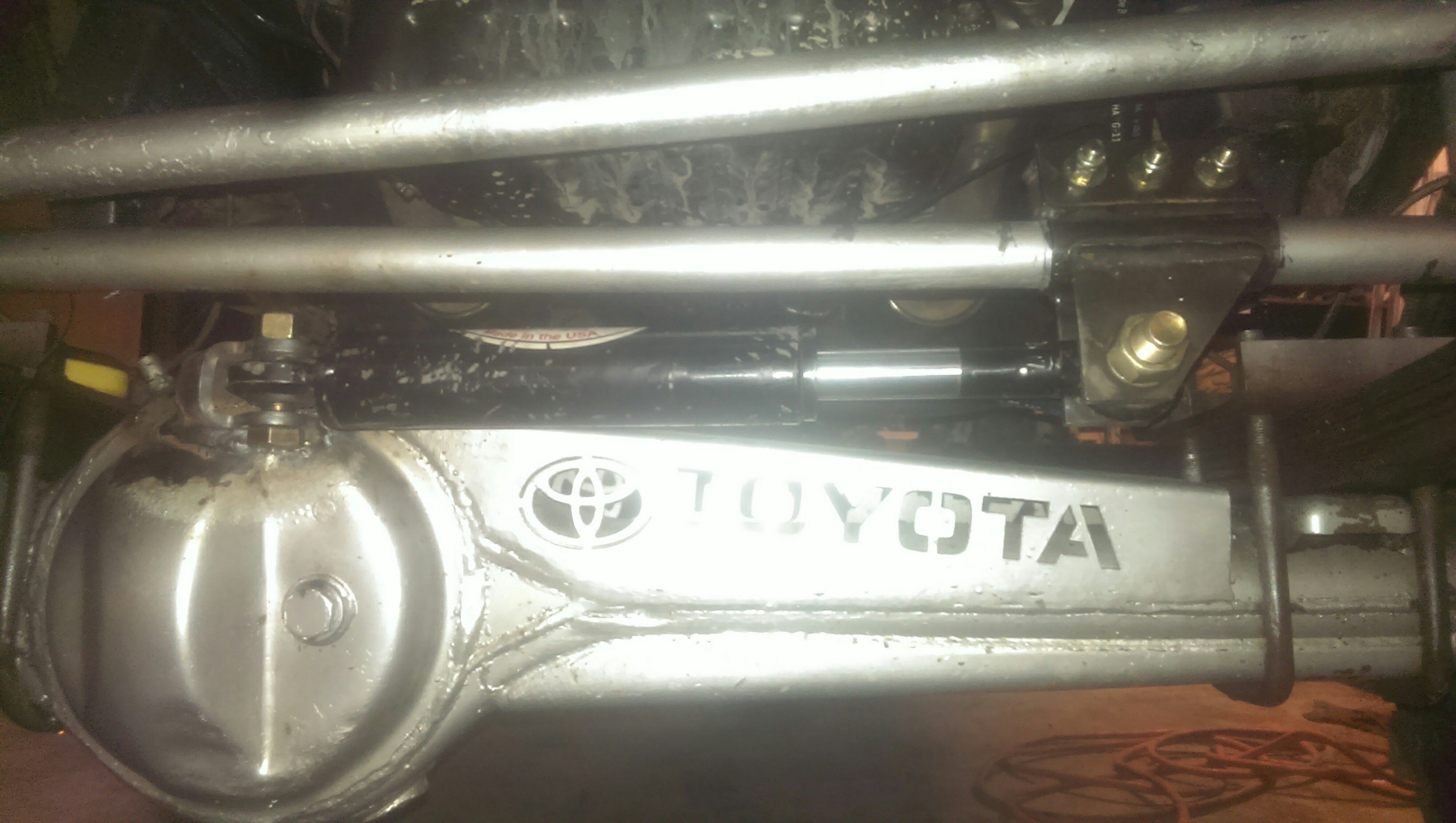

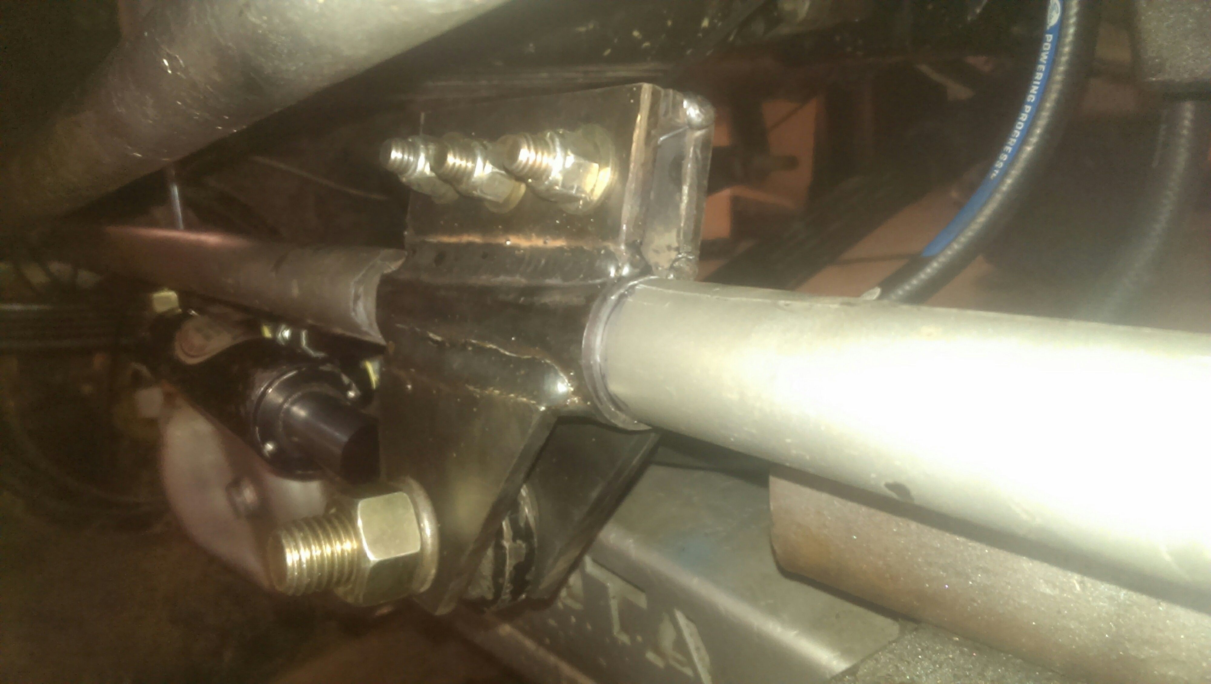

I finally got motivated to fab the mount and tie rod clamp for the hydro assist ram and I had Hydraulic Supply in Chattanooga make the 3 high pressure hoses. It turned out good even though I couldn't mount the ram behind the tie rod like it needs to be! See y'all at the BKORP grand opening for the SRRS #3 race!!! :woot: :driving:

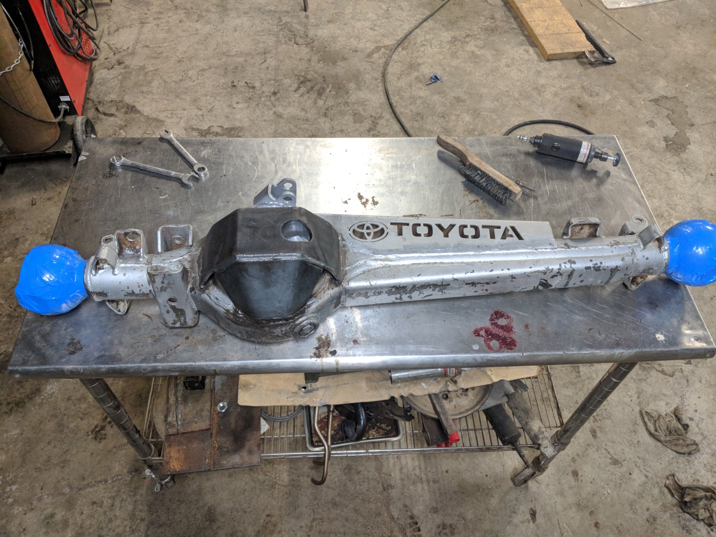

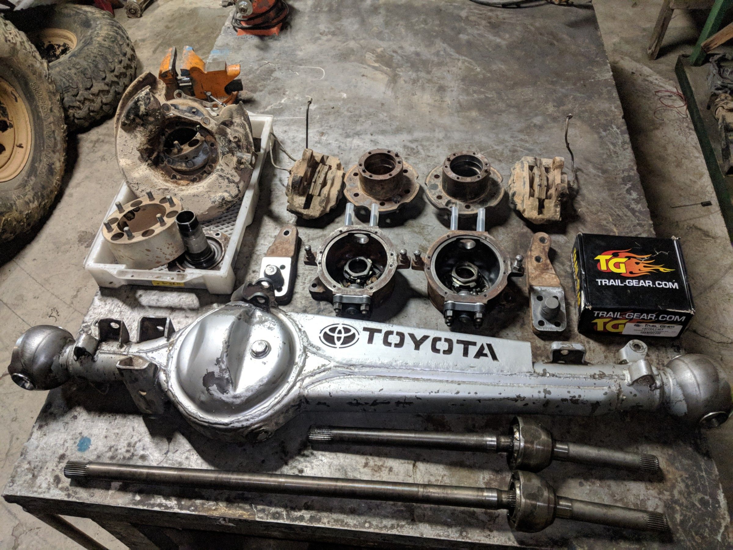

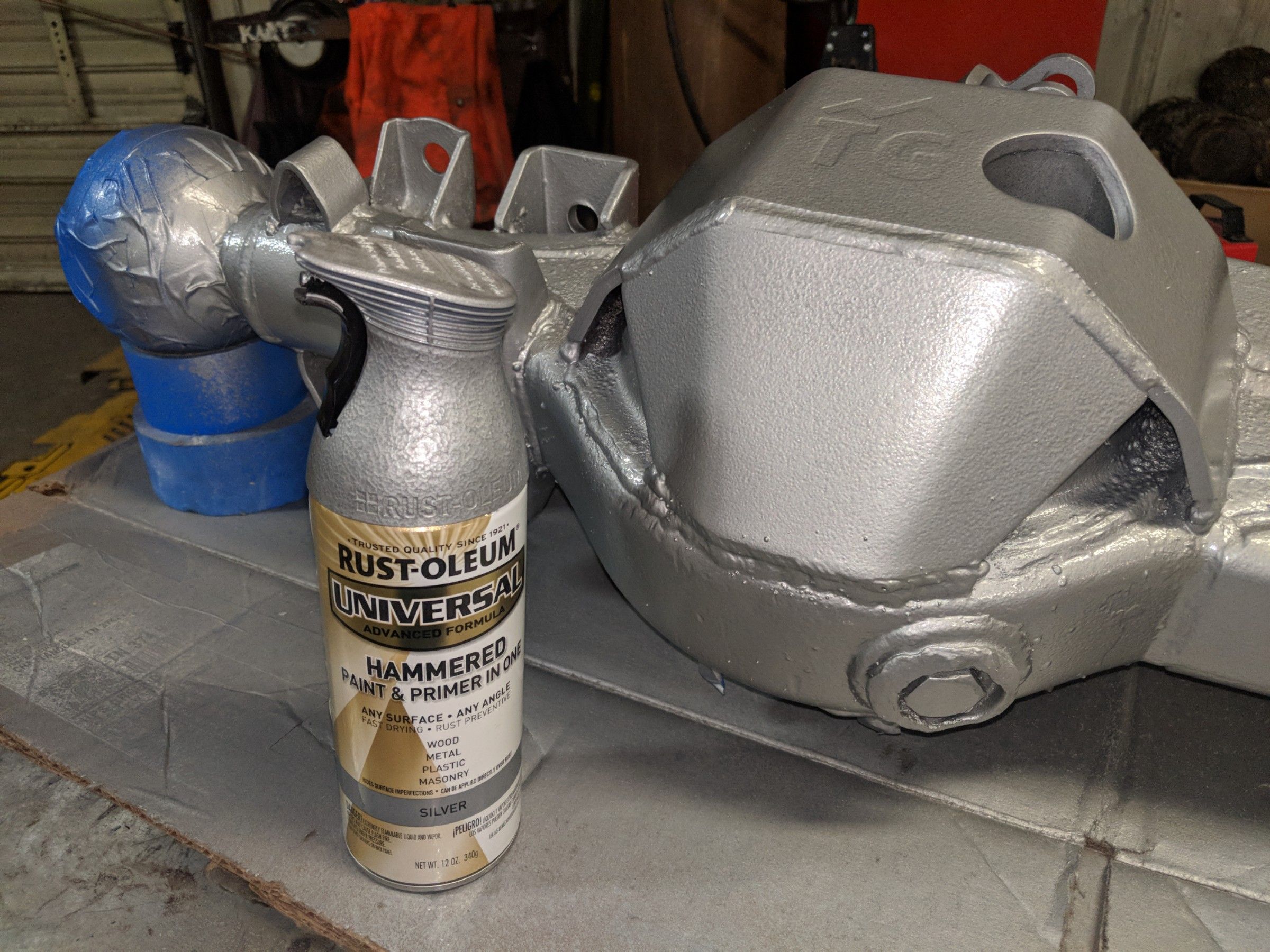

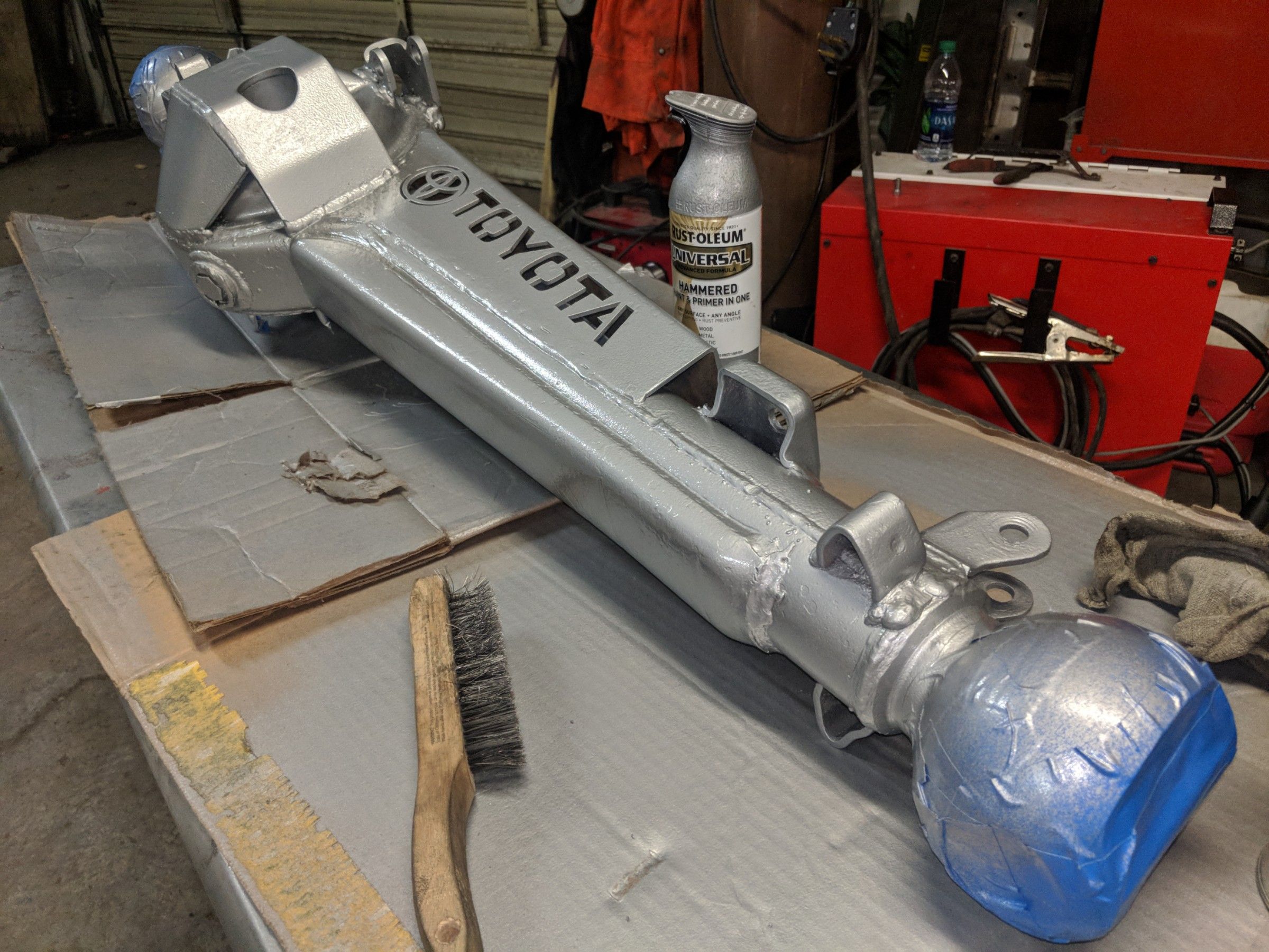

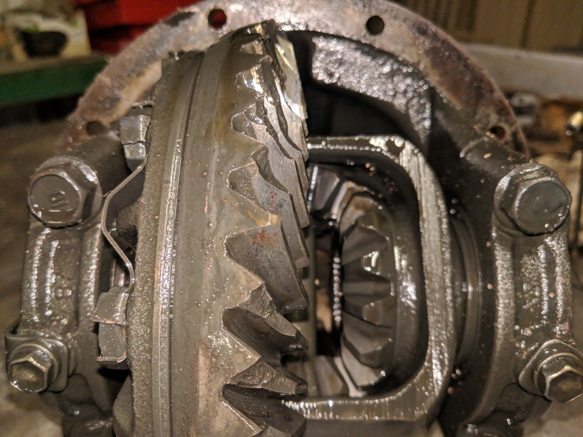

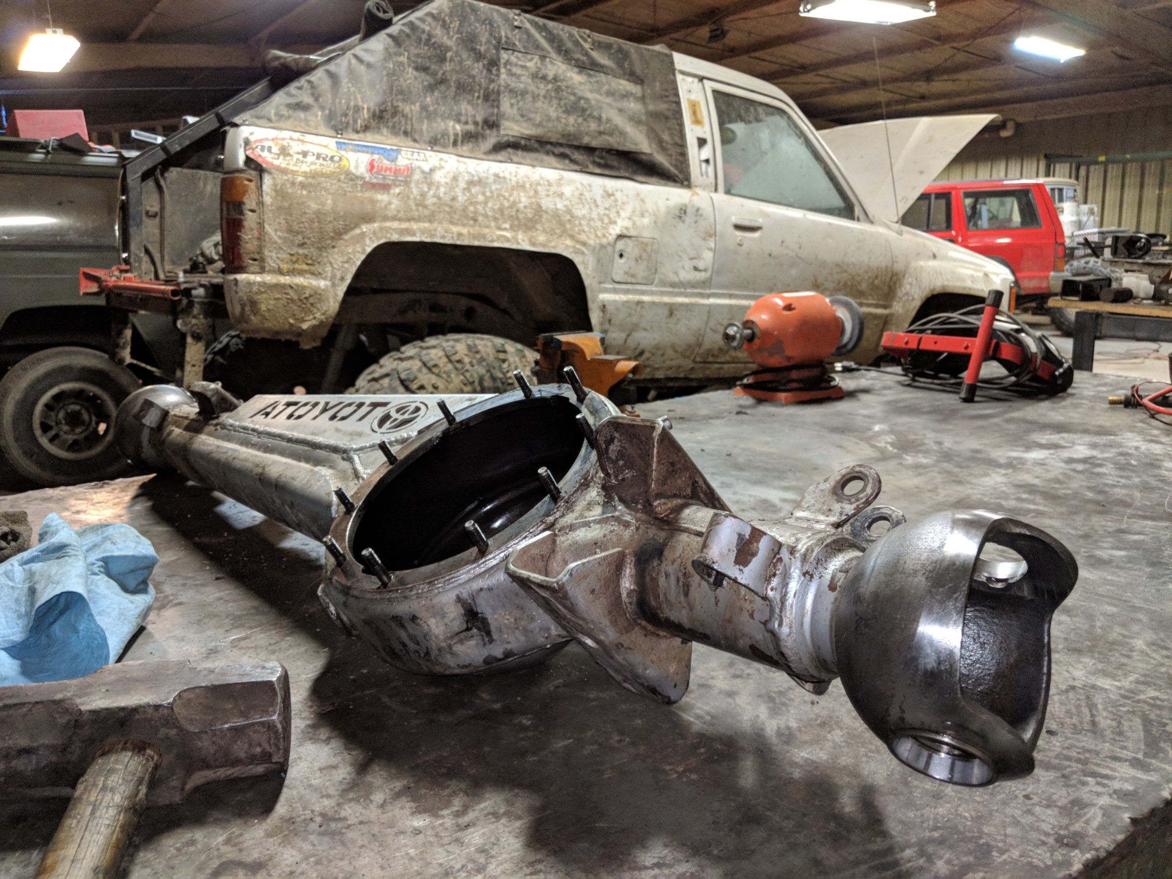

Finally broke a few parts down at Busted Knuckle ORP. I smashed the front axle into a rock on the white lightnin trail hard enough to make the differential housing touch the ring gear and shear some teeth off! 5 out of the 6 hub studs got sheared off on the driver side also. Oops! :drinkers: So I decided to disassemble the entire front axle, hammered out the dent n welded on some trail gear differential armor, installed a trail gear trunnion bearing eliminator kit, trail gear eco-knuckle wiper seals, Marlin crawler eco-inner axle seals, new gasket kit, new Timken wheel bearings, ARP hub studs and steering arm studs, an oem ring gear, and a fresh coat of Rust-Oleum paint. Let's see how long the front axle can last with the V8 now!!! :dunno:

:woot:

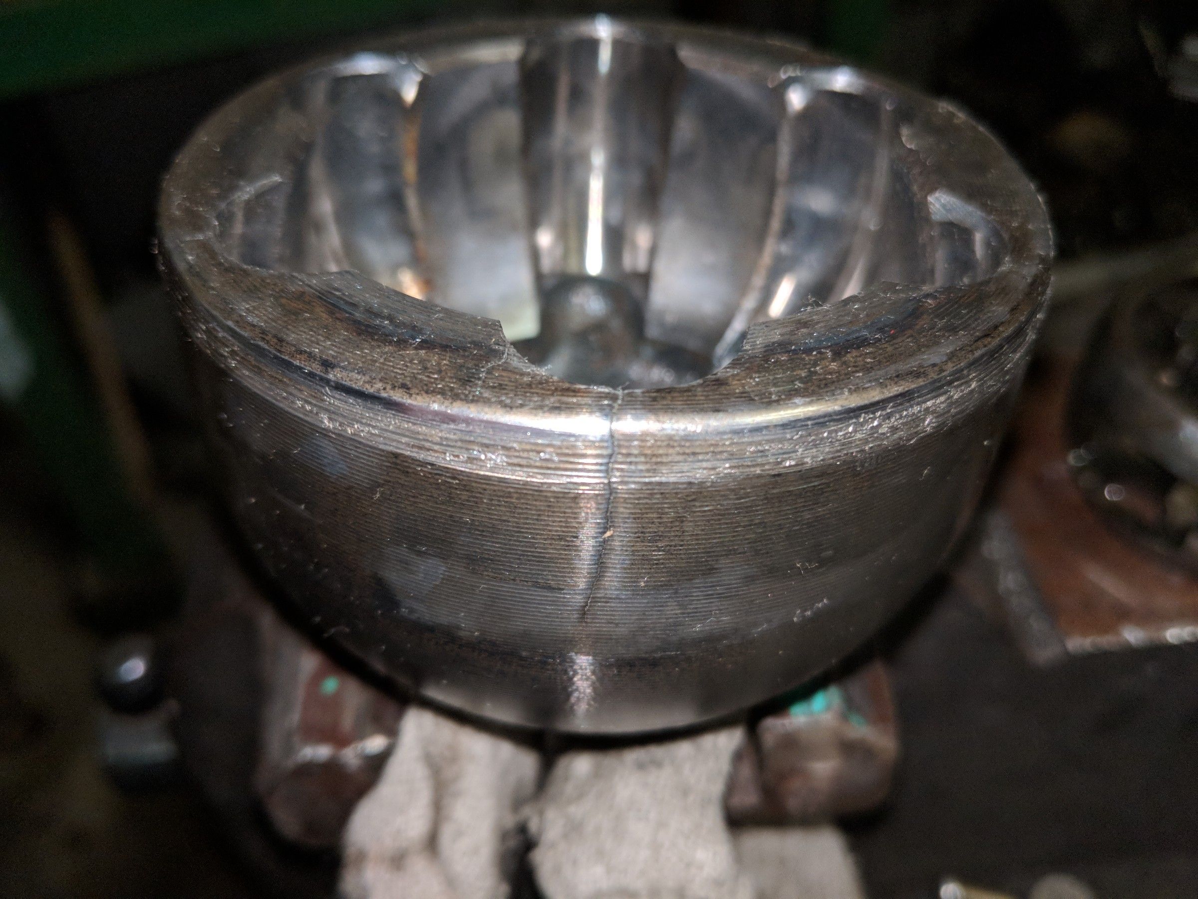

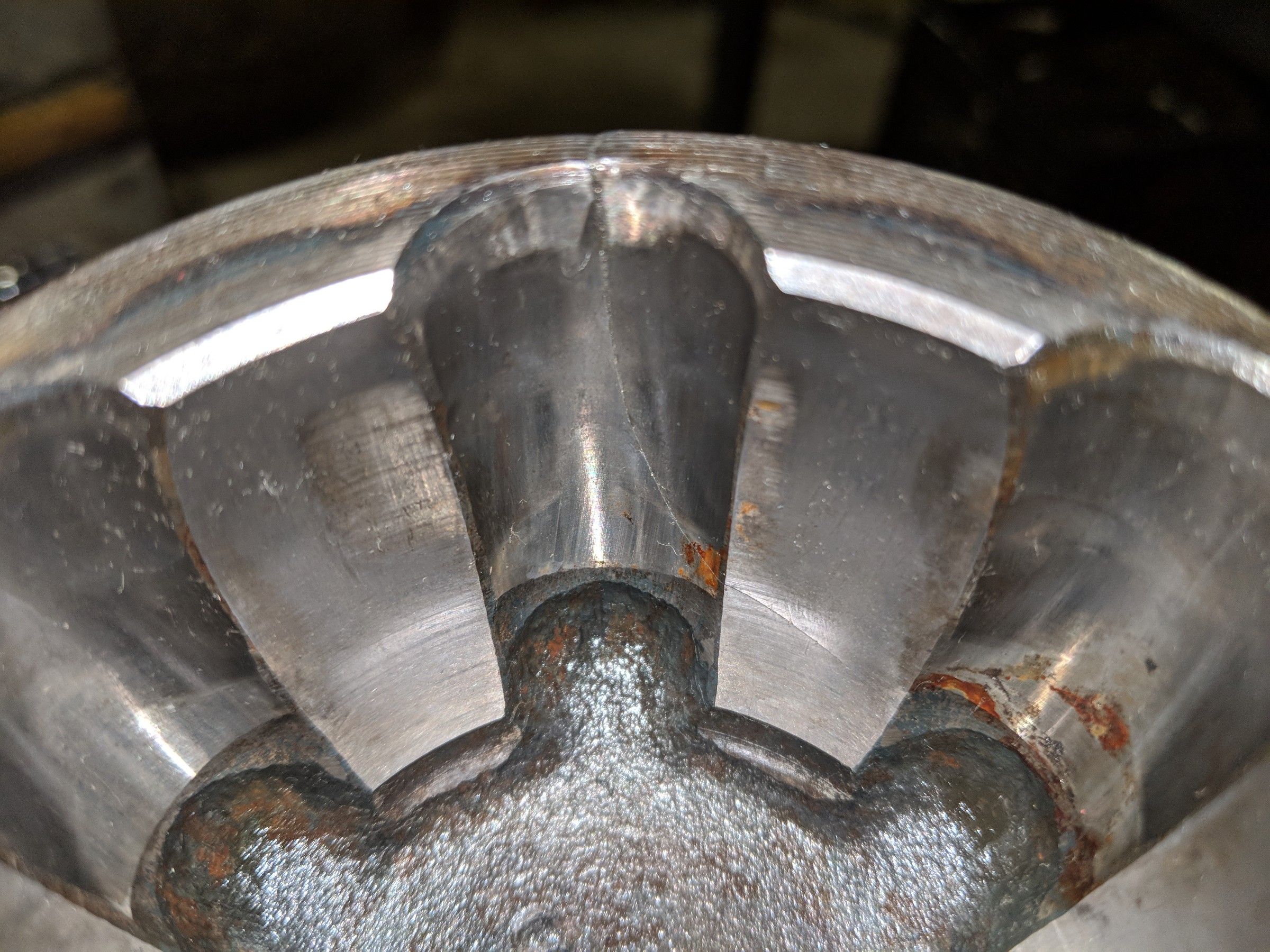

I found some more damage today on the driver side birfield (same side the hub studs sheared off) :'( there is a crack all the way through one ball bearing channel and two more channels have hair line fractures! Time to drop some more $$$ before this axle gets reassembled :(
