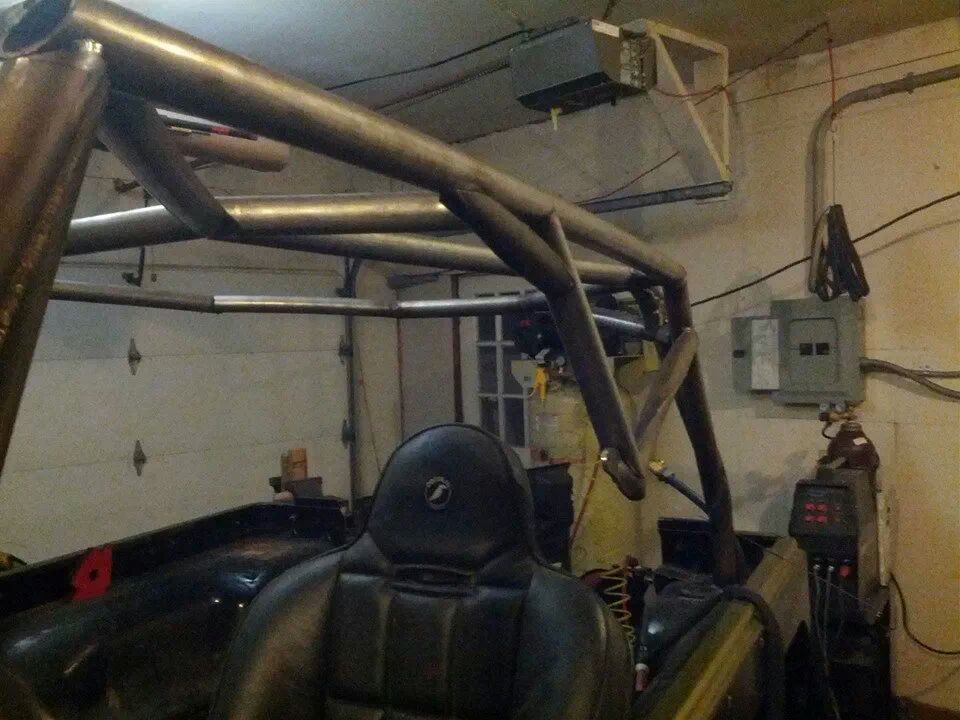

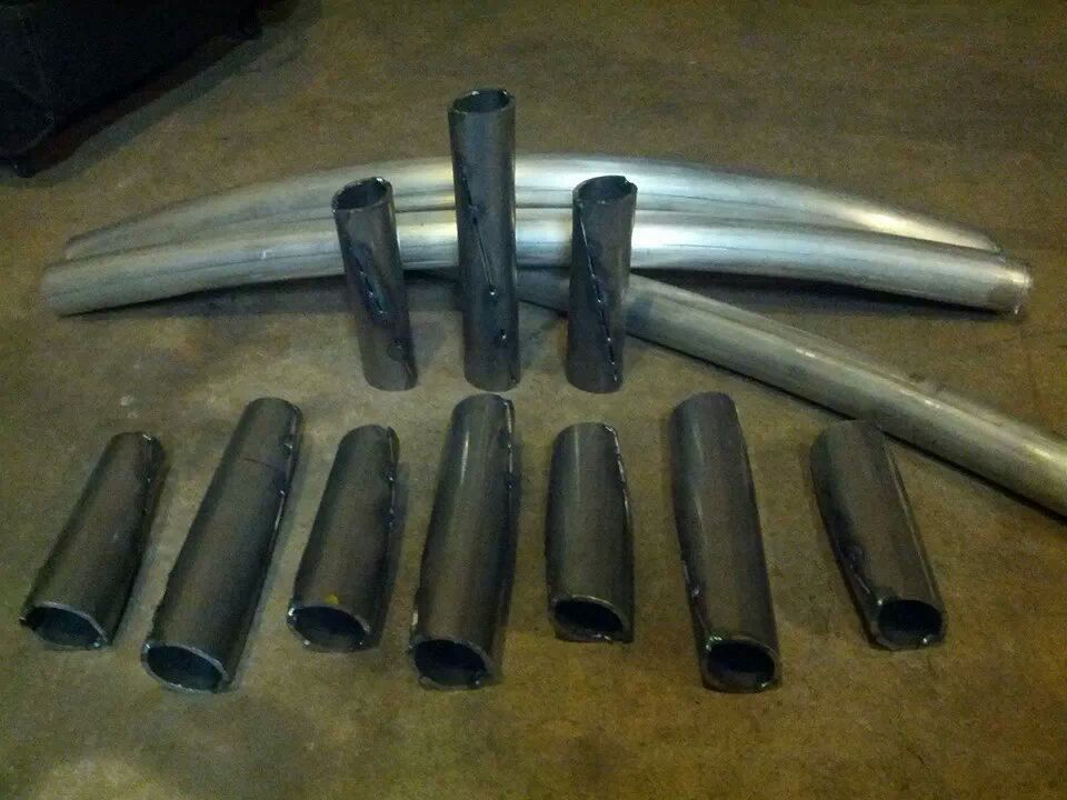

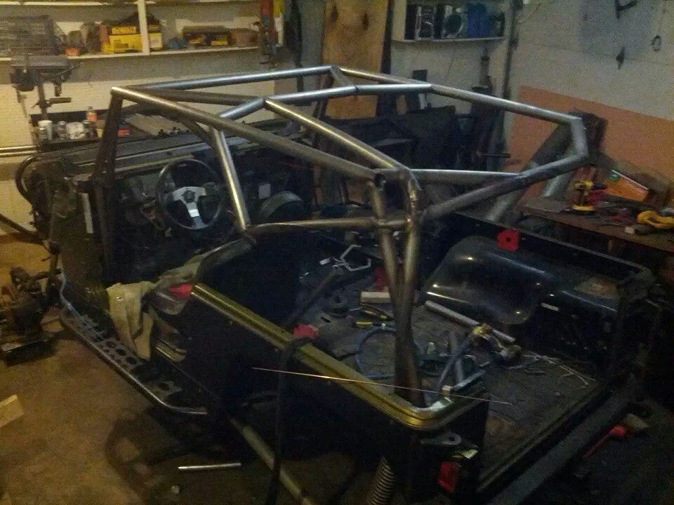

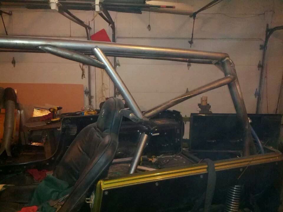

Man this build is intense, and I'm not talking about the Fab work.
Next time wait to start posting pics when you have gotten this far. I TOTALLY understand moving slow because you only get 3 good solid hours in a night on it. But now its starting to look like something :dunno:.

Josh wants a bench seat installed in his jeep, so I designed the cage for the most possible space. The outer tubing is very close to the soft top all the way around. He wanted something nice that compliments the lines of the jeep, but something not run of the mill. He wants all the hard work he's put into his rig to shine. I personally wanted to push a stylish design of my own, and work the limits of a different approach. Basically to cause some attention, and show that I don't need a blue print. This may not be what anyone else wants but, Josh is staying excited. If I can work with him and give him what he came to get, then its a win. Josh told me to push the limits and show off what I am capable of. The best part about fabrication, no powder coat, and a deadline is it can come back after it's debut ride at Easter Jeep Safari, and changes can be made no problem.

Do you not think that the roof right over his head being pieced together instead of having a few solid bars is not going to potentially cave in if hit right? I understand you are a good welder but this thing looks terribly dangerous, You need to have some more solid structure to your builds, Everything "jointed" up is not a good situation to have.Not trying to be a **** by posting this but just cant see why you would want this?
My answer to that would be, that intersection is going to be a 5 tube joint. The continuity in that spot should make it very strong. I have always had the theory that if your engineering is sound, you don't really even need to be really good at welding. But, with that said, any cage or buggy can cave in with enough force. Josh would be a pretty big dumby if he tried to jump the grand canyon with it.
I've never seen anyone look for ways to put a mile of extra weld on a roll cage before, It's your business but you will never be able to work for yourself full time doing all this unnecessary work, you won't be able to charge accordingly for the time spent on a project.Most welders aren't very good fabricators, you just have to figure out which you want to be.And all those joints everywhere instead of bent bars, or the solid bars in the roof is terrible from an engineering stand point.I will leave you alone and let you get after it after this post, you've got enough going on already, just something to think on
