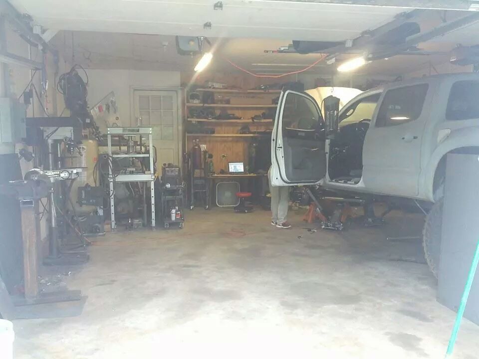

I am not sure if any of you have seen any of the 05+ Tacoma SAS that have been done yet, but I wanted to give you a little insight as to what we are trying to do with this rig. All of the 05+ Tacoma SAS that have been built to date are huge, all of them are sky high and most are running 40s. While that is great for the trail and the few who can afford it, and who have another vehicle to drive on week days, you might as well build a buggy. A truck with a ridiculous frame height and 40s, regardless of who you are is not a feasible daily driver for the masses. The cost of tires alone would kill your wallet. I want a truck that can crawl and be driven back and forth on a daily basis. When I started the research for this project, I found that there are just not a lot of companies even trying to do an SAS much less develop a kit. The only suspension upgrades available for these trucks are simple bolt on spacers and coil over kits, yielding around 3" of lift. With those kits, about $6000 more in parts, and major body modification you can only cram 36" tires in and still have limited wheel travel and weak steering and drive train components. There just are not parts available for this truck. With the venerable 1st, 2nd, and 3rd generation pickups and 4runners becoming impossible to find, people are turning to the Tacoma. Now they are turning to the 05+ Tacoma that is aging as well. From the start I wanted something that didn't exist. I realized very quickly that I was heading down the custom path. Shortly after that, I came to realize that I needed help. That is when I found David and both of us saw the opportunity to make a change in what is out there. While this truck is being built with custom style, I assure you it has been designed from the start as something that can be made into a production product very quickly. As this thing comes together you will see the complexity of what's going on. There are a lot of components being stuffed in between those frame rails and under that crossmember. I am sure here on Hardline, where the buggy guys roll heavy, you can appreciate what's going on under this full body rig.

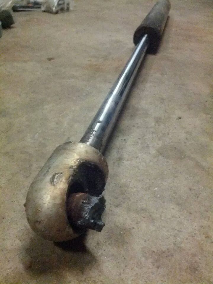

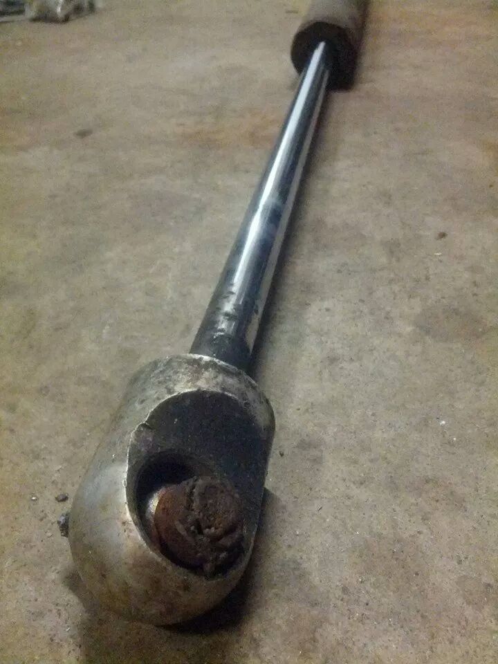

I never really pick at people's Fab work or setup, because it's an experience thing, but ???. Previous owner ran 400 miles of weld on this thing. No wonder we are re-doing everything on this rig.
