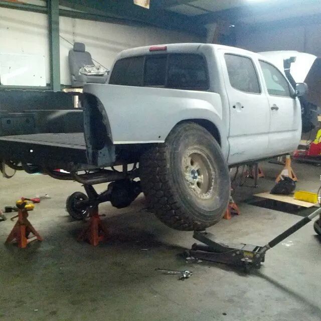

these were put up on several other forums but some how I neglected to get them posted here few little update photos of the progress.
front axel pulled and cleaned up. ready to get the ARB and gears installed and a free coat of paint
Pitman arm version 2.0 this one is built using a Sky chromoly splined slug and 4130 plate. 100% TIG welded goodness. we re built the original prototype due to a slight mis calculation in the length needed.
installed the ram prior to front end tear down. checked the steering and suspension clearances one last time just to make sure it was all correct.

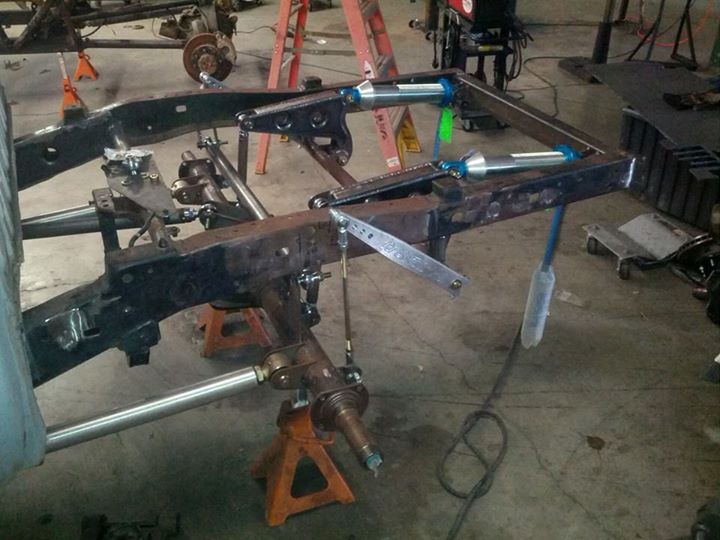

I am not putting up much info on the cantilever kit. this is a product that we have built from the start with the intention of making a kit for the tacoma as well as 4runner and FJC. But we did want to share our progress. When checking suspension bind the sway bar was disconnected and we had 14" of travel limited by the floor out of a 8" shock
things we still need to do in the rear include finish up the bracket plate work. finish a tube substructure to help support the cantilever suspension and provide a mounting place for an OBA air tank. and finally mount the king air bumps.
so now here is the long over due update. the cantilever suspension is done and has been tested for bind and clearance. she preforms flawlessly on 40s with around 25" frame height. I measured 18" of travel yesterday and was limited by the floor.
