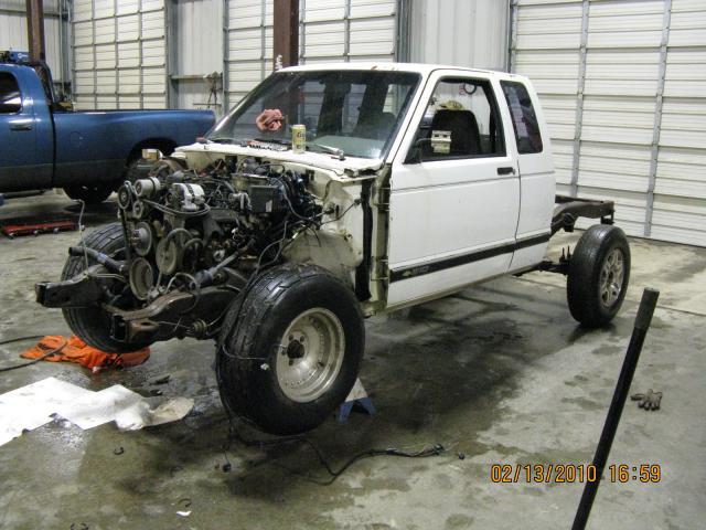

So when I was on the Busy W/ ChopShop and Biglugg I got a little pissed that I was stuck and kinda overreved the ol' 3.0.:booo: I had a pretty good knock so I dropped the pan and the whole bottom end is Fawked. There is no friggn' way I'm gonna put a 3.0 back in so I picked up this cherry one owner whip from Chopshop. :awesomework:

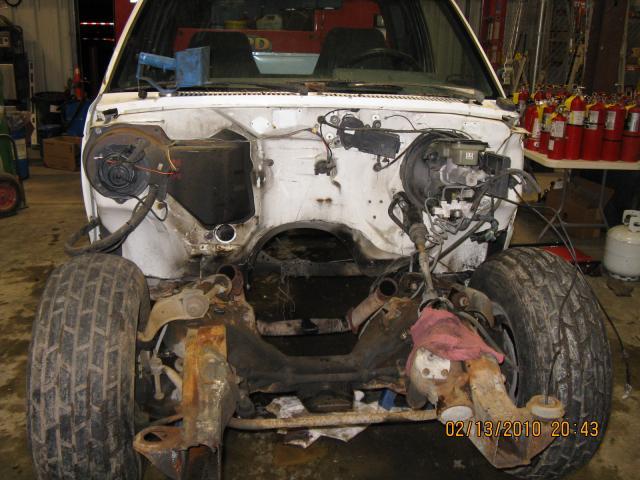

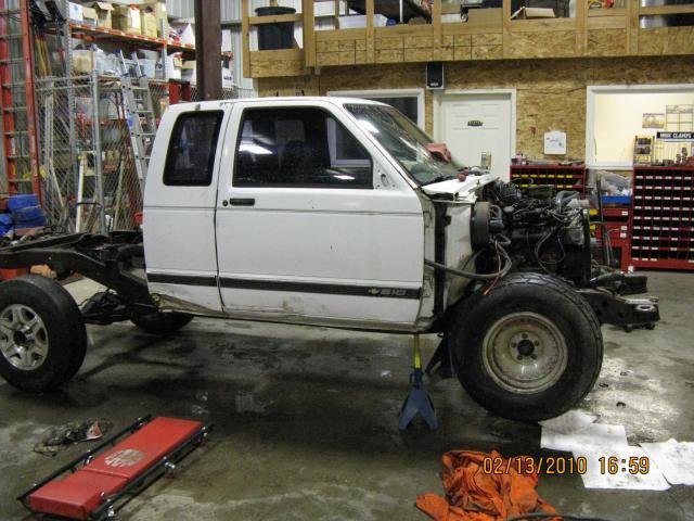

Drove it in the shop and started stripping it down.

Got the 4.3TBI Harness and ECU out along w/ the 700R4. My Dad needs a tranny for his 56' Chev P/U he's building so this should work out good.

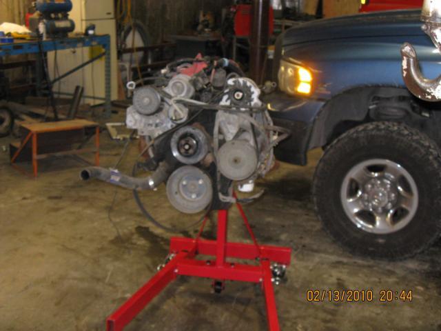

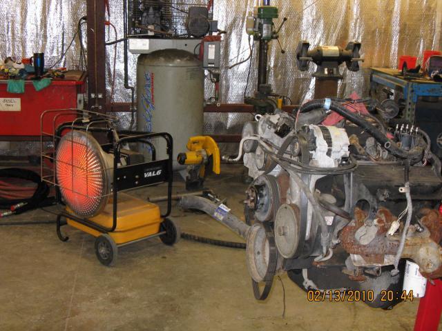

Got the 4.3 on the stand ready to start tearing down and cleaning tommorrow.

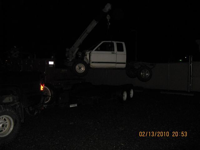

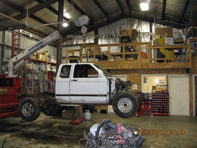

Had to load the bitch back on the trailer to free up the bay. Don't you wish you had one of these!:FU1:

Yeah the motor seems pretty easy. This engine is one of the most gummed up I've ever seen so I might do a rebuild just to be safe. I haven't done a comp test yet or checked the bearings but a **** load of sludge everywhere and 174,000mi. Need to find a resource for cleaning up the throttlebody, it's fawking gross to the point the plate sticks.

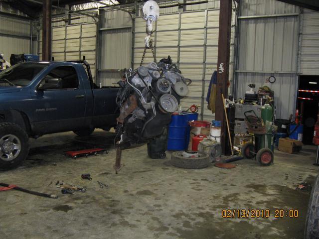

Ok, got the 3.ohhh pulled and all the wiring stripped out. Got everything cut off the frame to clean it up alittle. I didn't trust the gay little motor mount perches Toyota has on the frame. I'd never trust the bolt in conversion mounts from AA or NWOR no matter how HD they claim they are. I'm going to plate the frame since it's so damn thin and I wheel like a tard.
