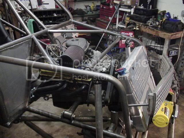

Mo progress... I need my final Turd payment to get here so I can pick up the last few odds and ends to make this thing run and drive

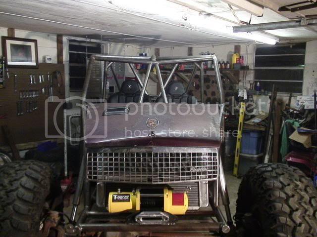

Im going to run a small "euro" style scoop on the pass side of the hood kinda like the older 300Z's had, the filter is up a lil high... I think it will give it a cool look as well on the hood, plus its on passenger side and I wont have to look over it much laughing

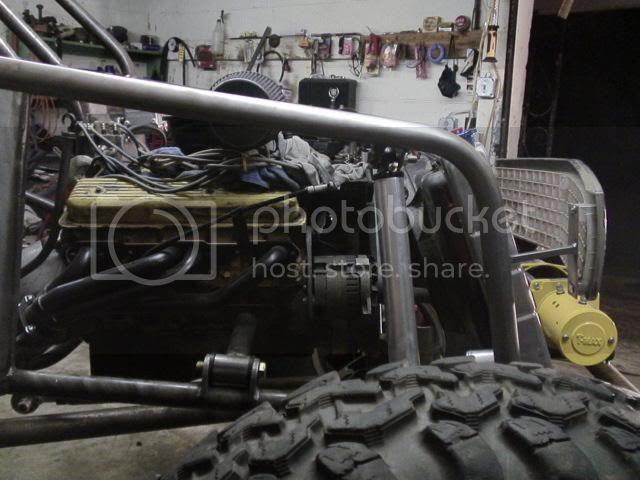

I just took this cause it looked silly.... put the air's back on the rear last night after I put in a cross bar from mount to mount.
Can't tell from the pics, but how did you end up mounting the rad?
wontwork said:
I havent captured the top yet, but the "removable" tube in front of the rad is what Im going to use. The lower mounts are pictured further up... rad slides over them.

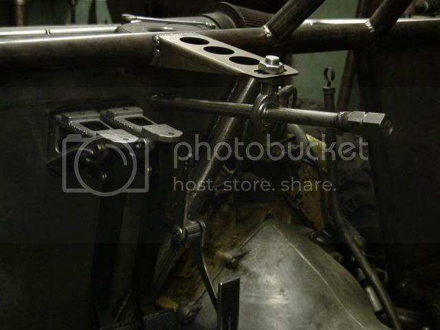

Interior.... fuggin blaaaaaaaaaaaaaaaaaaaaahhhhhhhhhhh
Im not a sheetmetal layin kinda person, dont particularly enjoy it... and with the top of the tranny and Tcase somewhat pokin up the floor Im really hating me for not dropping the belly down another 2 inches. laughing
Im gonna see if I cant get most the floor in and then bring it to work and have Pat do the tunnel work... Im personally not feeling it :-X The buggy may ride a trailer this week thumb.gif

Orbital is mounted, steering shaft is made and all that is in place. I also cut the hood to fit and started sortin out battery mount and steering resy mount points. fun fun... I still havent braced the bottom side of the hood after cutting all the support out of it so its wobbly right now laughing
