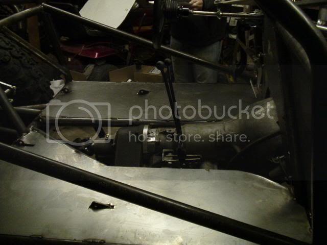

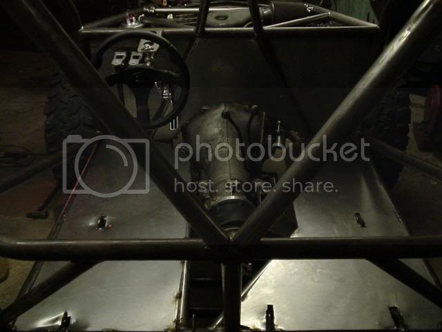

Floors are in, took these pics to bring in to the sheetmetal dood to motivate him, if he doesnt say bring it in tommorow Im gonna lean on wontwork to help me on it... or Ill just cut and weld my ****, Im tired of lookin at sheetmetal laughing1 I also mounted the PSC pump and resy last night and "looked" at my fuel cell... Im gonna mount it tonight. Im starting to re-lean towards a PSC SE steering ram, dammit I cant make up my mind on steering. Im also tight budget wise the bitch may get a farm ram I dont know laughing1

Im at the IDC part.... fug the interior Im gonna get the tranny covered and throw BS at the rest of it... It wont be nice and clean like yours.... it will be simple and sparce... I got one gauge and one shifter to put in it..

I do need to mount the ignition box and a couple of relays but I bought OEM GM relays that have the lil tabs on them so I can just hang them from the firewall with one bolt thumb.gif Other than that wiring wise Im plug and play with the Painless Harness for the most part. I do need to mount the puter somewere somewhat outta harms/ nature's way. Im thinking of a psuedo dash board favored to the passengers side so I got room to do work and Miles has no room to pull his bad ass tattoo out while in the rig :flipoff1:
