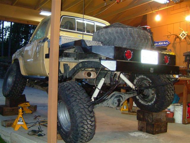

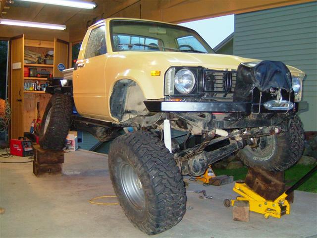

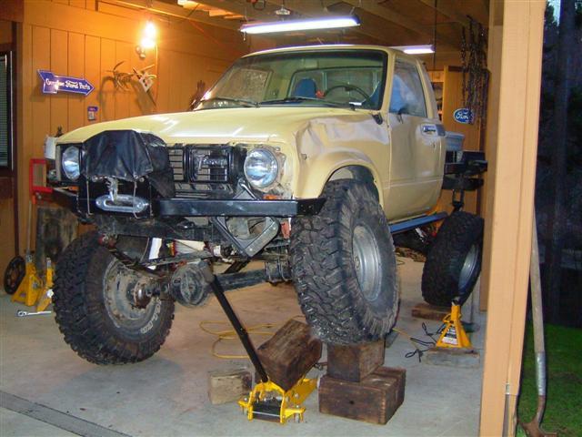

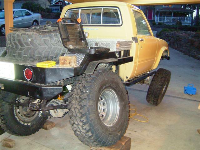

Longer spring packs installed
Well, besides the dents recently added the Toy got longer spring packs installed.
The rears are 5" Trail Gear with one leaf taken out to help level it to the front. Then the fronts are 4" Skyjacker rears with the load leaf replace by a load leaf from the old front packs. I am pretty impressed with the results so far without hitting the trail. Before it would even but hardly move the rears now it will stuff them tires no problem. I likey:D . Here are some picks of it twisted a small amount. I could only get 16" with the jack I have.
Thanks Bigred_086, lilyota & Fullywrecked for your help. :cheer:

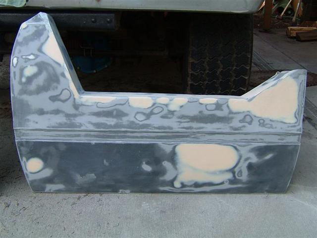

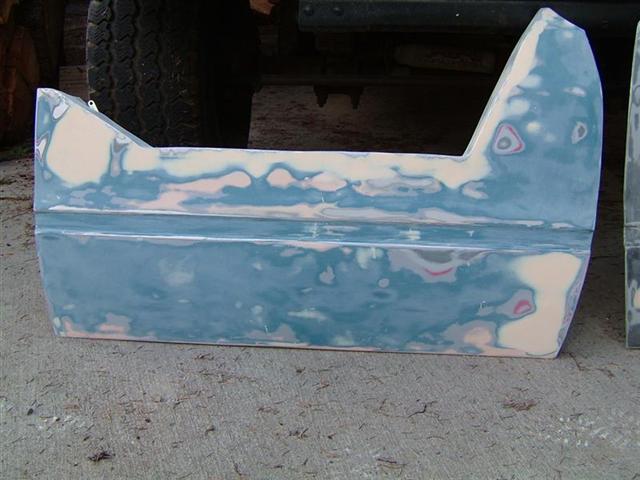

Half Doors
Well, I decided to get the half doors built and ready for use. I will through some paint on them this weekend. They turn out OK.
