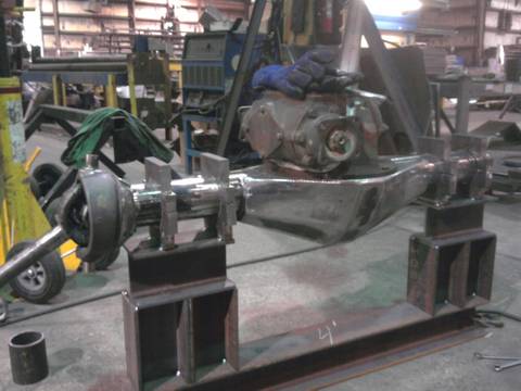

fordcontraption01 said:
Does it use two short shafts? Looked cool how much less does it weight than a stock housing?
Yea I'm running two short shafts and with my wheels and tires I'll be 89" wide outside to outside
Heath has the weight report, I'm about the added CLEARANCE!!!
the first houseing was roughly 40lbs less than stock, I hope the next one is closer to 45, I can do a better job on the center section and make it a little smaller. I know some have drilled the inner cs, but I just can convince myself to go light in that area. I hope that by the time im done with the third. and the hubs, to be within 20/30lbs of a stock d 60 front.

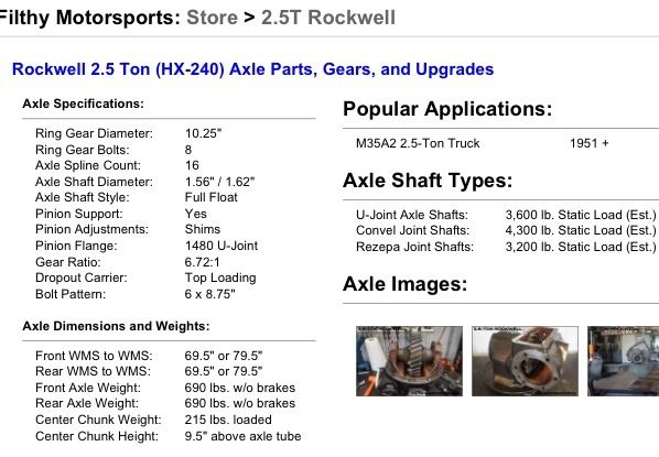

A friend of mine weighed his built D60, 676lb. A de-braked Rockwell weighs 690lb so with Ouverson brake 700lb.

May be a dumb question, but ill ask anyway for education purposes. How is it that a de-braked front rockwell weighs the same as a de-braked rear rockwell? Seems like the front steering setup would make it weigh more then just a straight axle.
Let the education begin....
Here is a quote from Steve Gerstner (Differential Engineering)
"I am listing this info. for future use. These weights were done with an electronic scale. 2 1/2 ton front, 100% complete stock, 842 lbs., narrowed front with no brakes 662 lbs. The rear 100% stock 692 lbs. and with the brakes removed, 532 lbs. Two drums and two backing plates with all of there parts is 160 lbs. steve differential eng. inc."
