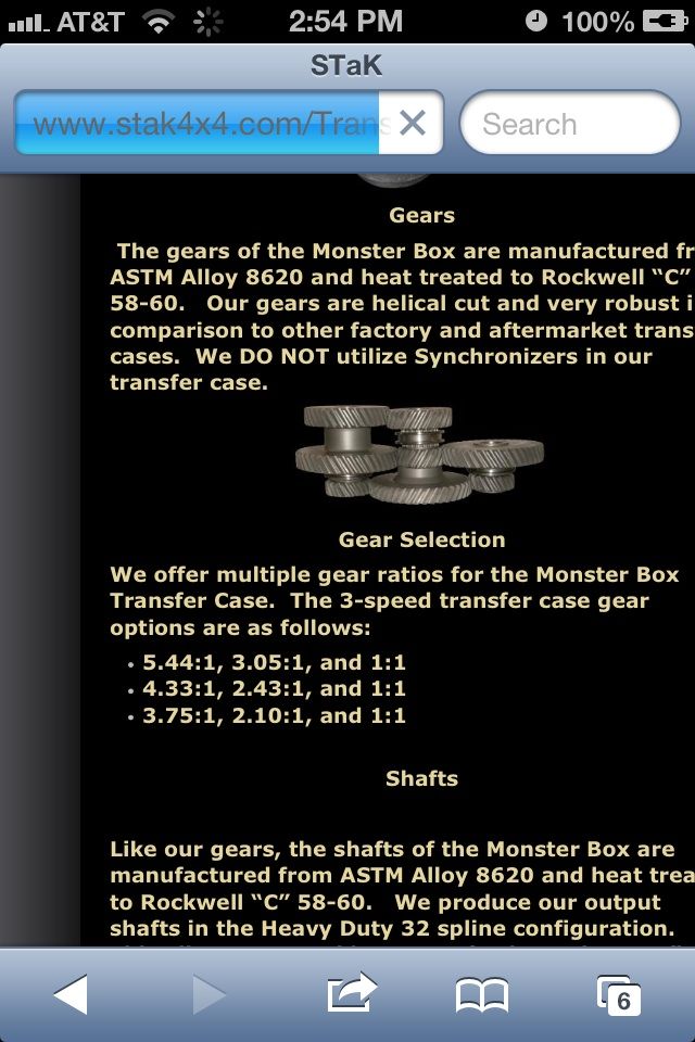

yes I was running 205 with 400 with stock 6.0 blow the tires off until on steep hill then it'd bog motor down so I figured with the 2.1 205 I'd drop a cam in 6.0 and that would take care of that ended up finding a hell of a deal on stack 2.3 so dropped it in also world of difference still not gettn the speed I want So might need to change up motor or blow the motor I gots or it might just be me being a non driving **** beats me
What stak did you buy that has a 2.3 range? I didn't see one listed on there site. That might be throwing your numbers off.
3speed monster box 1.1 2.43 4.33
You sure your figuring that right? Transmission low gear x case low gear x axle gear. 15 should be a high geared pig
He's calculating with the trans in 3rd.
Re: Re: Re: how to shave weight on rocks????
yes sir 1st gear puts me at 34.47 bounceing of rev don't run it much 2nd 24.16 pulls good bogs sometimes 3rd 16.32 every now and then can pull on hills. Showgirl 1st 37.67 he never runs it 2nd 22.48 this is gear he mostly runs 3rd 15.19 runs every now and then
