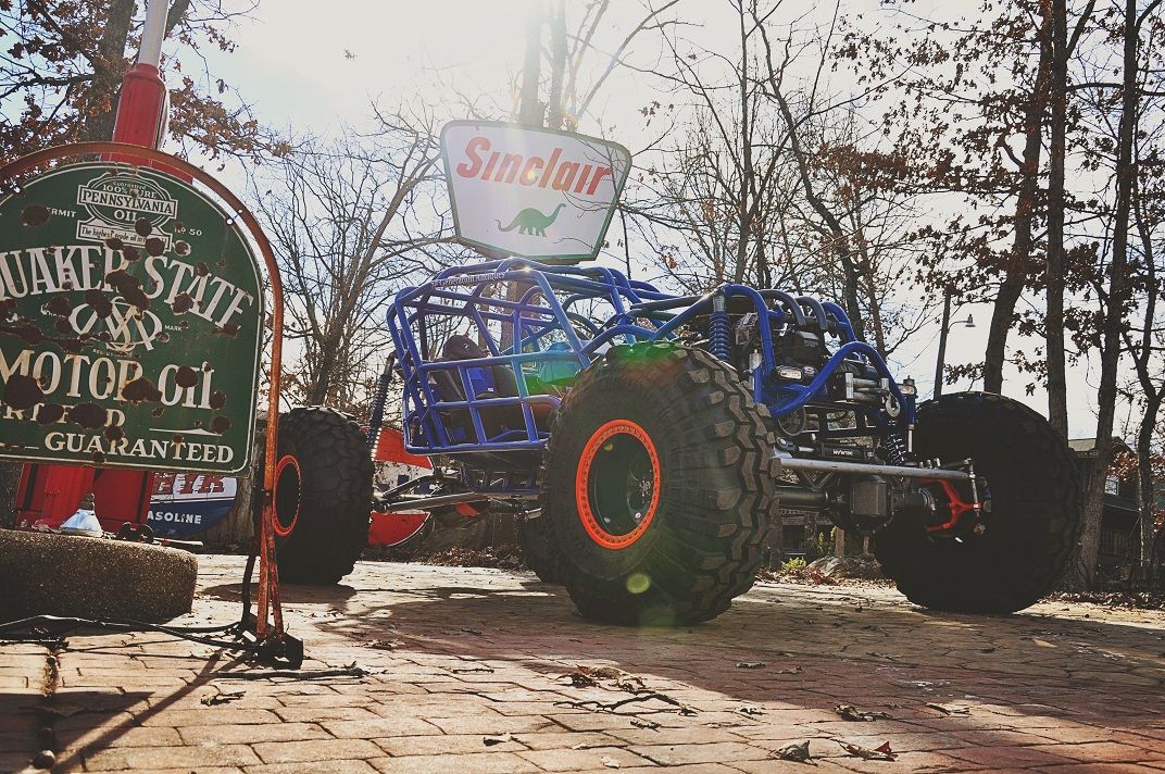

When's the last time ya'll saw a KIA that was built quality like this one? Ever? Give the guy some props for building a unique rig that he's obviously going to wheel the piss out of. Who ****ing cares if it's an exo or an internal cage, either way that's some nice tube work and in my opinion, will hold up fine. If you've got something constructive to say, then by all means go ahead... if you just want to bash, I'd be happy to show you the door. Have we forgotten the rules of this forum?
Nice work traildemon, and I hope I will get to meet you out on the trail soon too... except I'll shake your hand and tell you nice work. Now get that thing finished!

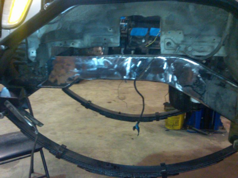

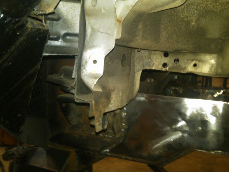

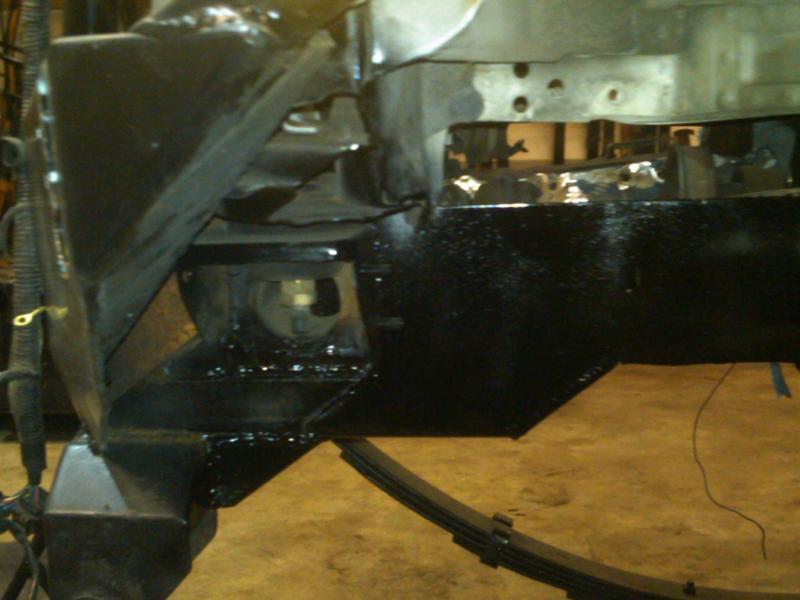

Speaking of cutting fenders out I started trimming the inner fenders yesterday and got the frame all cleaned up, I also threw some frame plates on it too get rid of the crush zones Now I can throw the inner fenders back in and some shock hoops and I should be good. another thing when I test fit the engine I had the exhaust manifolds on it and it fit fine but when I built my motor mounts I decided to drop the engine down a couple inches so the flanges are hitting the frame where the collectors bolt up :mad: so a little plasma action is gonna take place in there later on. But Im going to clean up the passanger side framerail first.

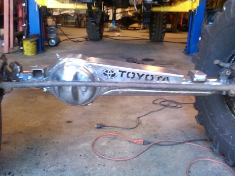

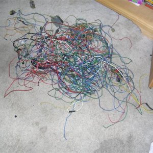

Im getting my high steer arms tomorrow so I will be cleaning that front axle up and getting ready to mount the cylinder. Ive just had enough wiring for a bit so Im gonna tie up some loose ends and then get back to it just needed a little break from looking at diagrams :awesomework:

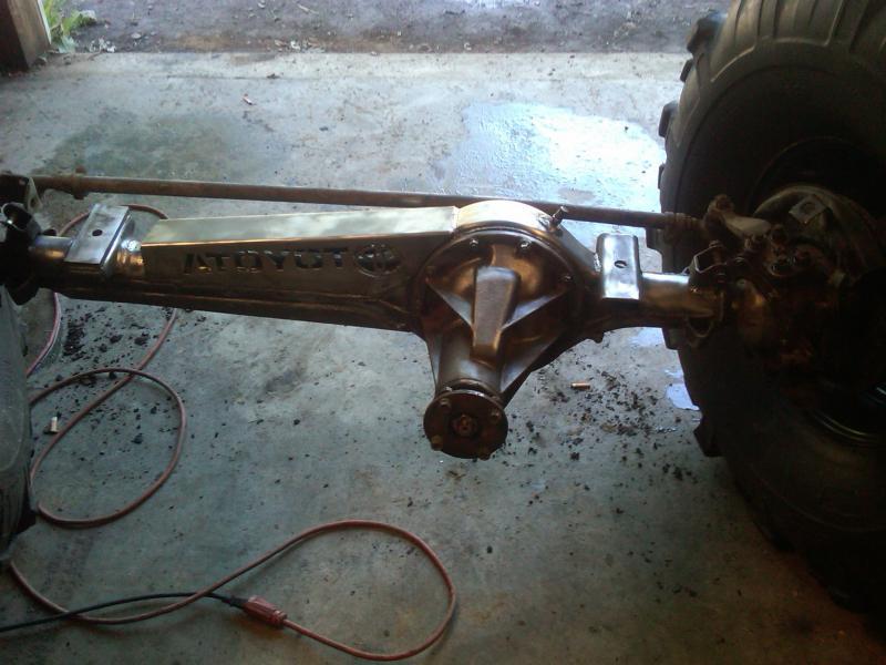

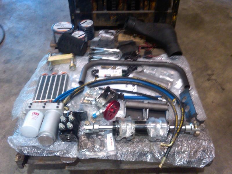

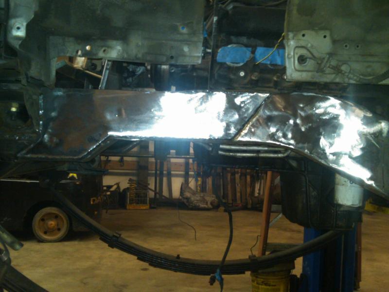

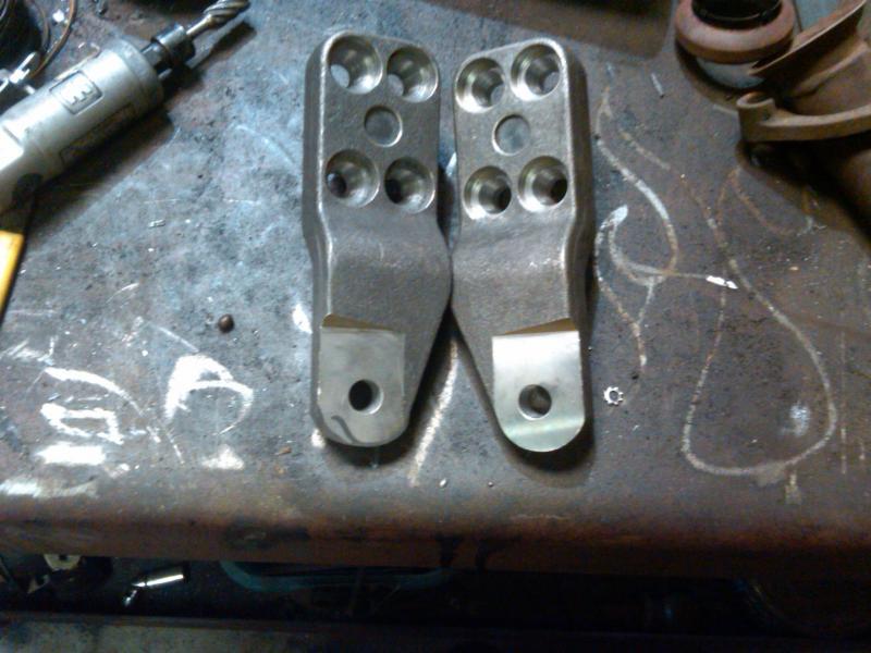

Well I got a few more little things done today. I got the passanger side plate welded on and both inner fenders trimmed up and in. went and picked up some high steer arms and got all my boxes opened up and pulled about 5000 square feet of bubble wrap off of all the parts, now I have everything I need except a serpentine belt pulley for my tc pump,. also I got the front axle all cleaned up so I can start welding on it (hopefully tomorrow)

Thanks Charlie, Im glad you finally made it home, Maybe I will swing up tomorrow am, after I get my coffee :coffeetime: I want to look at the intake on that thing, New project huh. sounds :cool:

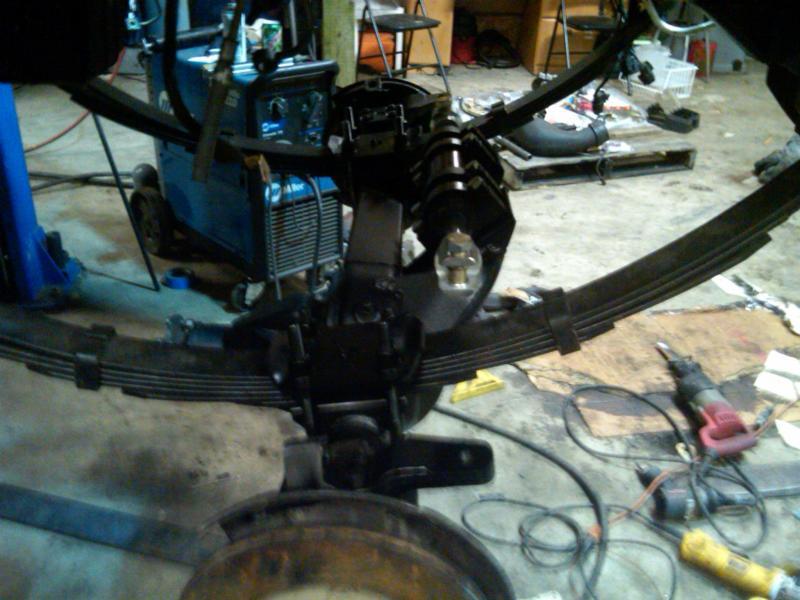

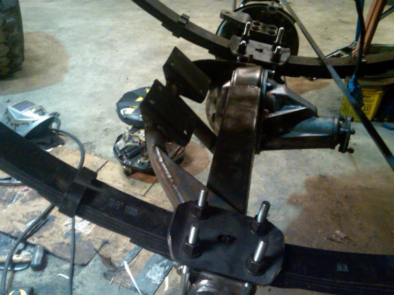

I got a few things done today. I started by cutting the high steer arm off so it would be the same as the drivers side.

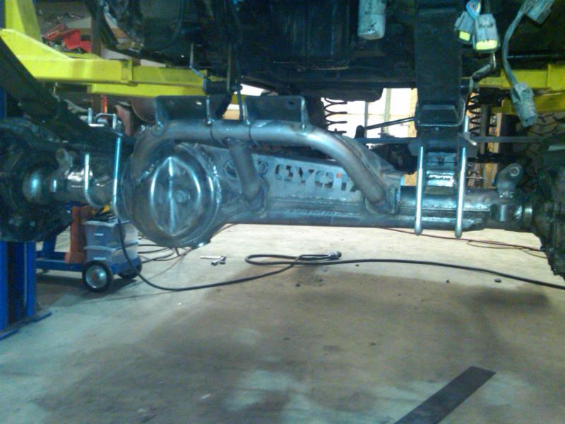

then I started cutting the trail gear ram mount and decided to throw it out and bend my own up because it just didn't look right no matter what I did with it, with the 90 degree bends it just took up too much room so I threw some 60 degree bends in a piece of tube I had laying around and it started coming togeather after that. Once it was all notched and leveled up I put the ram mounts on and a couple gussets. I cant find my 3/4" drill bit so I will have to go get one of those to drill the high steer arms out. I plan on running a fifth stud too but need to get an axle rebuild kit cause it was leaking oil everywhere and the bearings have seen better days. so I will do that while its all apart.
