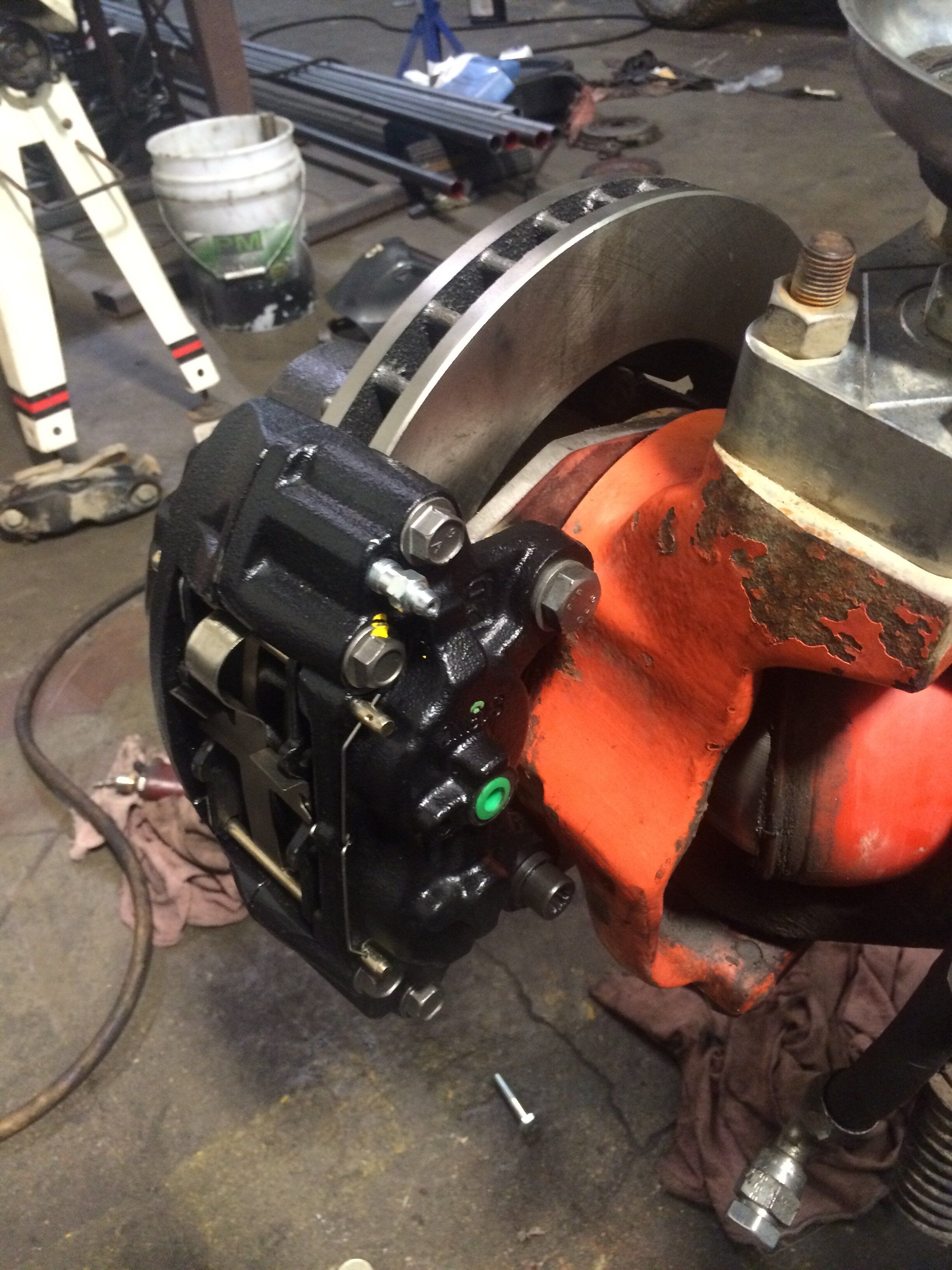

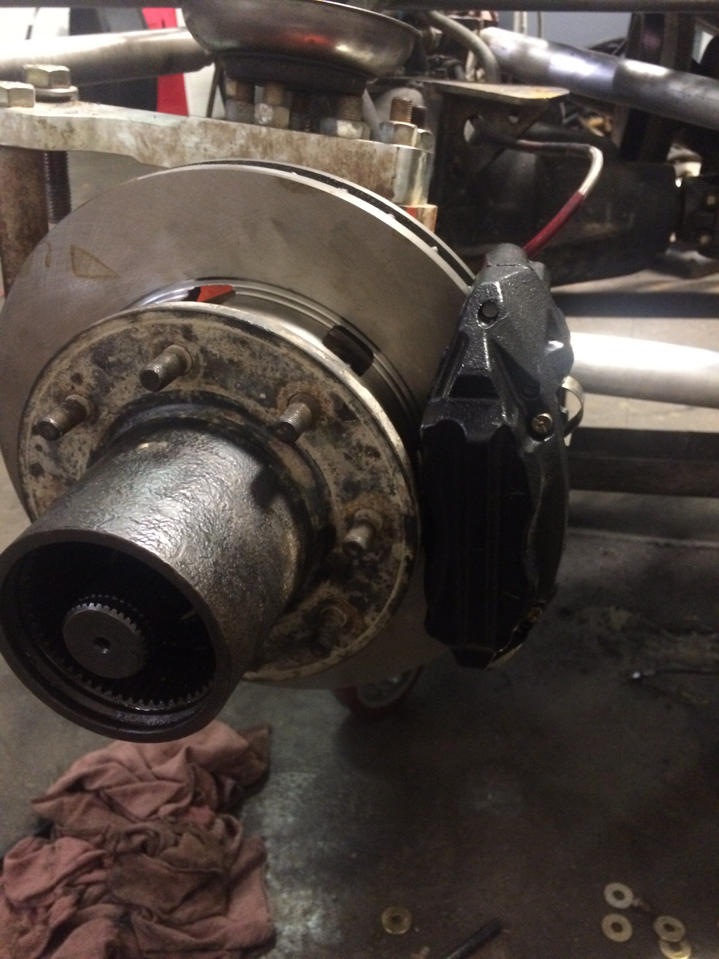

Not a big deal just skipping that step would be nice. One of my rotors has a crack that started at one of the original bolt holes. I got the axle from a metal recyclers and believe it was bounced around on the ground before I got it. It had no tires or rims and was sitting on the rotors. RockAuto rotors are inexpensive and got me thinking.
Will be a bit before I see how they work but here is a Landruiser (96 FZJ80) caliper on a Ford KP 60. Rotors are 1980 Chevy K20.
Also, weighed everything, looks like it saves 8lbs per side, so claims of saving 30lbs per side using chevy calipers I find very exaggerated.
did you fab your own bracket for this? I like it a lot.. please let us know how performance is. what master cylinder are you running ?
