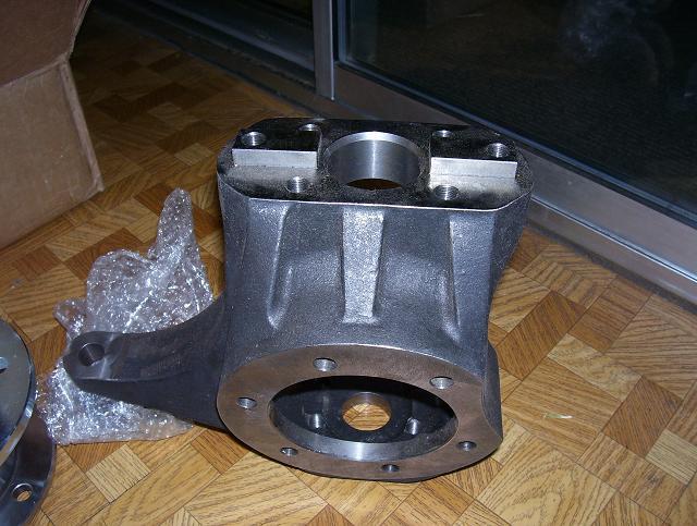

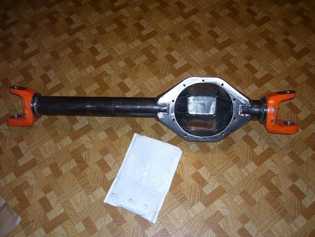

started by making a call to Brian Ellinger at Diamond axles to build me a 609 set up. A few months later Santa came early for me.:cheer:

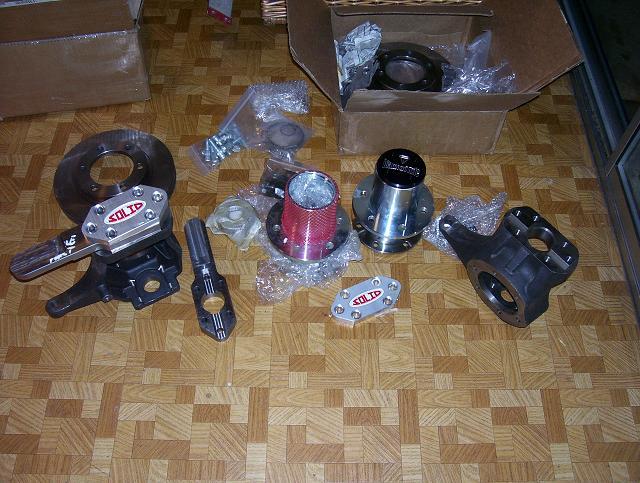

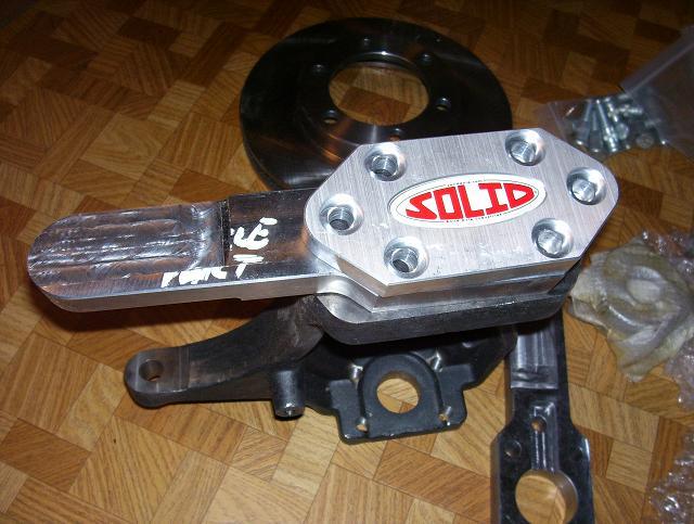

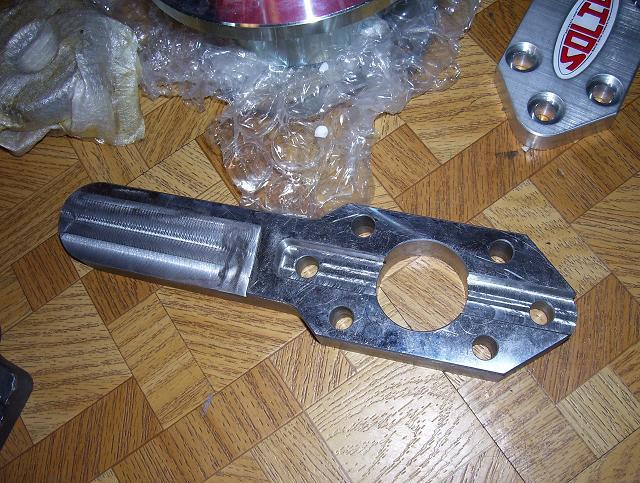

I have to say these are a work of art, no wonder why they are called Diamonds. I ended up getting them in the 3.5"x.5" wall version. They are the same price with .375" or .5" wall version and they only about 6-8# more. I was going to run a different inner "C" but they kept putting us off and it only came in a 3" bore size and I would have to pay to have it turned out to 3.5". Brian had the Dedenbears on the shelf in a 3.5" variaty so I had to settle for these :redneck:
If ur looking for lightweight parts, Solids Industries is not where its at. But if ur are looking for some of the most stout parts out there I feel this is where its at for stock style 60 parts.

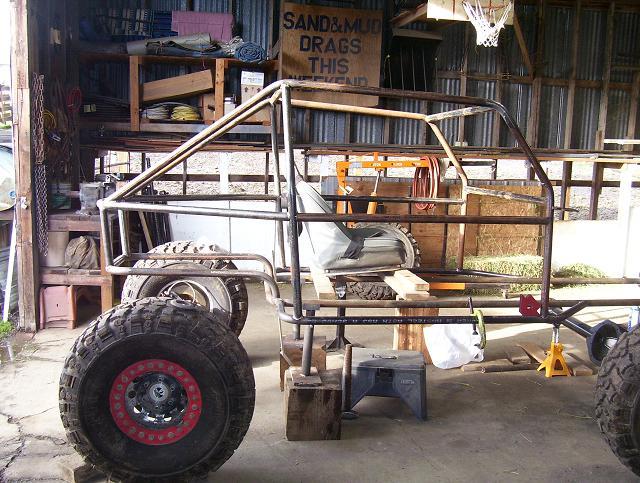

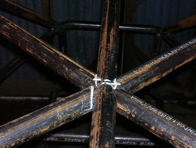

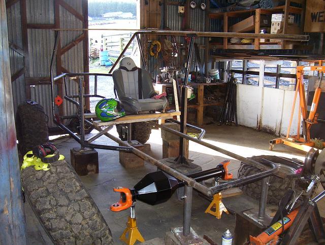

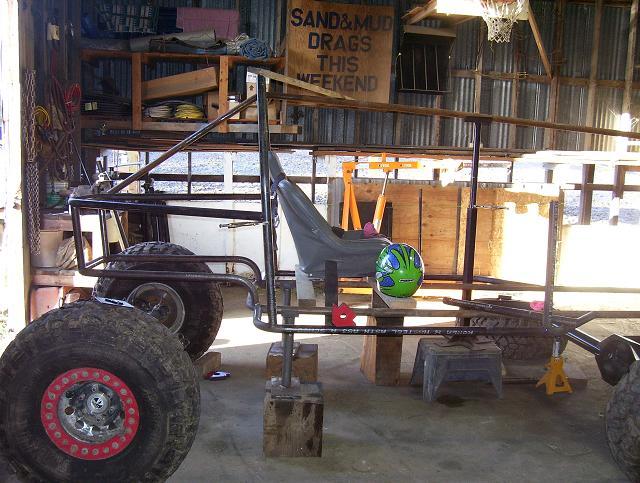

started bending a lil pipe and getting a idea of the layout that I am going with. I was trying to get a 3 seater but there will not look like what I want and still be able to get the rear seat in there. So I settled on two seats with plenty of room for storage and a cooler.

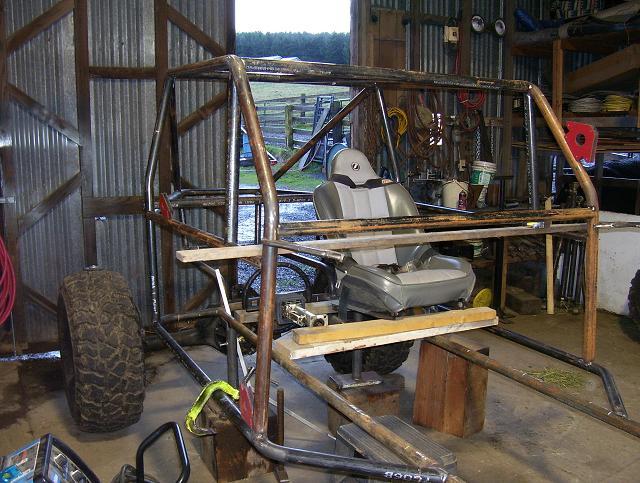

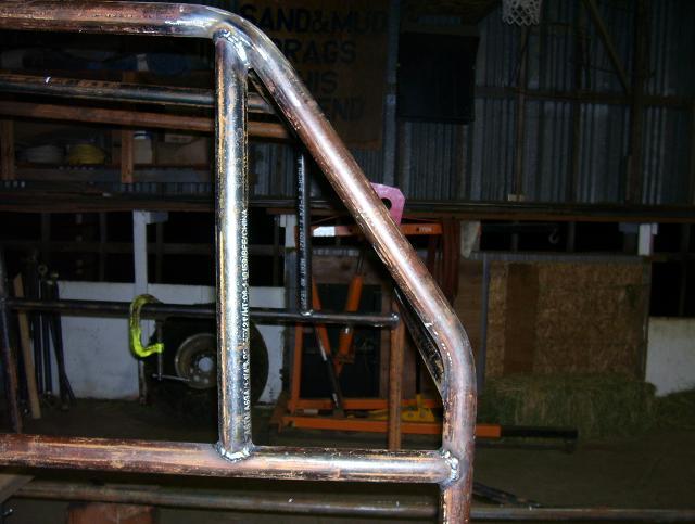

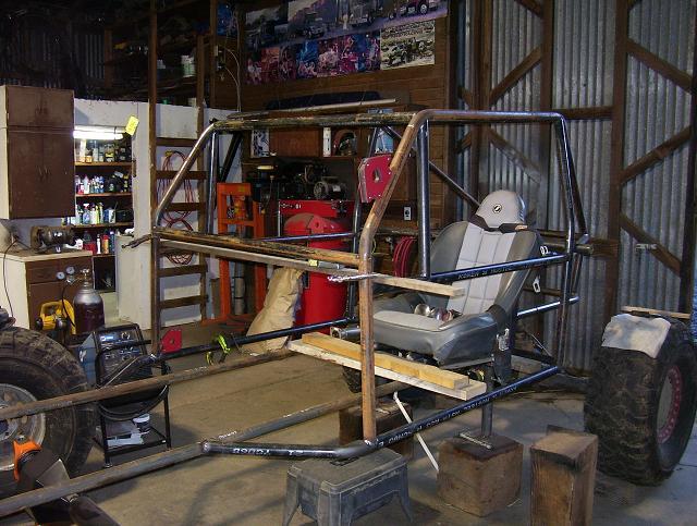

getting a lil more done to the cage, outside frame rails, A-C piller, and door bars are all schedual 80 .190" wall.
Are you building it out of pipe?
It will be with 1.25" sched 40 and 80 and also I will be using some 1"x.083"wall herw tubing. I might have went with 1.75"x.120" herw but it takes around 8 weeks right now to get a die from JD sqare. I have always had good lck with pipe so I just went with it. :kissmyass:

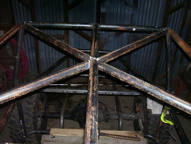

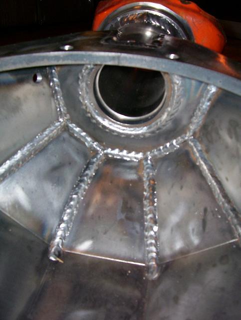

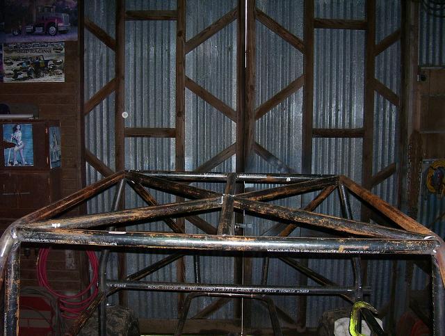

tied the roof alltogether, I thought it came out pretty slick considering who was doing it:redneck: God daaam did it take a while to get it to fit together nicely.:stirpot:
