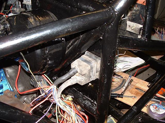

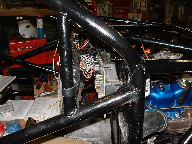

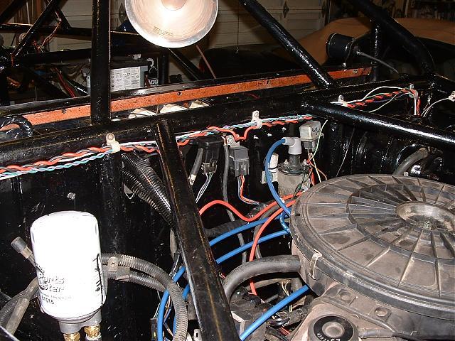

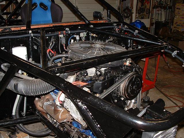

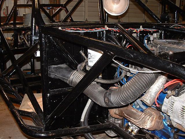

Over the weekend, got the computer, firewall plug, almost all the wiring finished. Even got the air intake put in the firewall. I figured even if there is ever a backfire, the k&n filter will stop the flames from reaching the passenger, and if not, they probably needed woken up anyways. Now I need to finish taping it all up and put convoluted tubing over most of it. Sanitise things a bit.

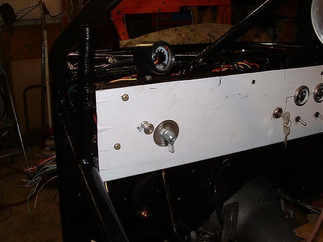

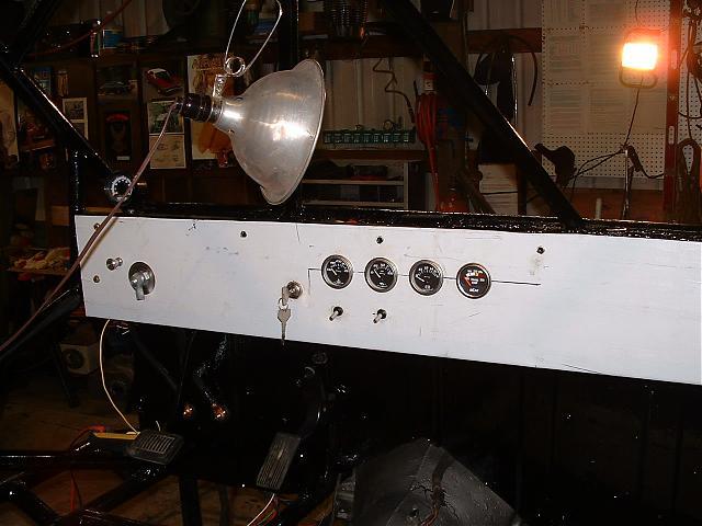

Also pretty much got my dash finished. It still has the protective covering over it. Polished stainless, actually it started as a tailgate protector that was freight damaged that the company said keep it, so it was free. The face is made so the rolled edge that normally goes over the top of a tailgate is at the bottom, so a nice rounded surface just in case you smack your knees, it won't cut you up. I install Equus gauges, hey they work. I really wanted the autometer C2 series, but when I compared 170.00 to 33.00 it was hard to justify the extra expense. So I have volts, oil, temp, and also a B&M trans temp gauge. The tach is an old sunpro unit I've had for years. Not trying to be cheap, just trying to afford to finish it soon. Battery trays are made and got Exide Orbital Extreme's installed. Got the fuel pump, a Carter P5001 installed and a Fram HP1 filter also installed. Now for plumbing. Also have a kill switch on the dash for me, and another in the back that kill everything just in case.

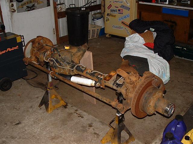

I scored! Yesterday I got my front Dana 60, the best part, only $550. I knew being patient would pay off, but they were wearing thin.:awesomework:

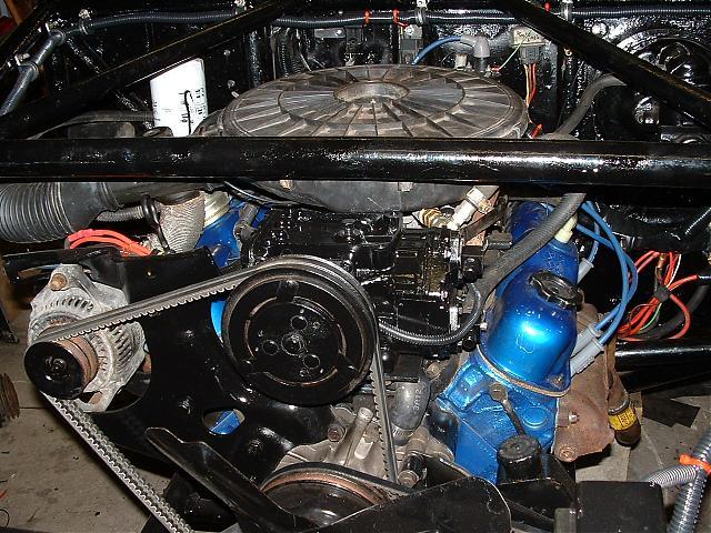

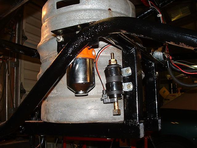

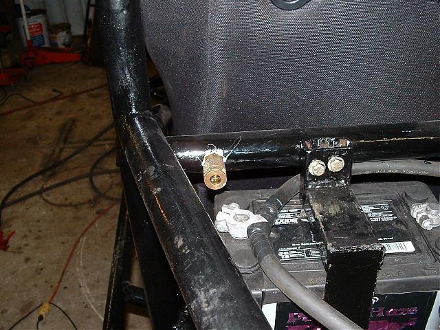

Here's the $550 axle. I'm happy with that. Hard to spend over $1000 for one when you will probably have to replace all the bearings, seals, gears, add an ARB, yoke, and possibly axle shafts. I've made up my mind, going to go with 6.17's. Also got the compressor installed, hey it looks like it's suppose to be there. Actually the bracket came off an old small block and since the V6 is basically the same, it fit, just had to cut an ear off, and drill a couple of holes is all. I plumbed the intake to the under side of the air cleaner, that K&N should work fine for a filter. The pressure side is plumbed to the center upright frame tube, then I drilled the main frame rails to carry the air rearward, and various other bars to act as an air tank. 1/4" holes thru joints, and welded up the outside holes. Got lucky, only had one leak, and it was in the middle of a tube, so I assume the factory weld missed a spot. Unfortunately it was behind the firewall which had to be ground loose in a spot to fix it. The tube where it leaked is also where I added to the cage height, so it is double walled there, one tube inside another, so I'm not worried about strength issues. For a total of 52 feet of pipe pressurized, that gives me a 4 gallon air tank, and one that's free and takes up no room. I figure I will run it at about 150 psi and use a regulator I have to cut it down for the ARB. I installed air fittings at each side just above the batteries, and will be putting in water drains at the lowest points also just in case. I did install a quick disconnect for the air cleaner housing and also the pressure hose off the compressor. So if for any reason I spring a leak, I can still get air from the compressor and bypass the tank. Trying to think ahead and avoid problems. Oh, by the way, the axle is out of a Dodge also. Mopar all the way!

Looks good but is that air chuck right over the positive terminal on the battery? Could cause some excitement when hooking up a hose if thigs touched:eeek:
Could wake someone up yes, but it's farther away than it appears. I'll tell ya, If I arc it out, that keg for a fuel cell is full of beer and I've had too many.:beer:

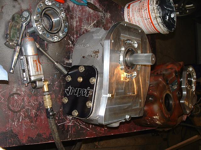

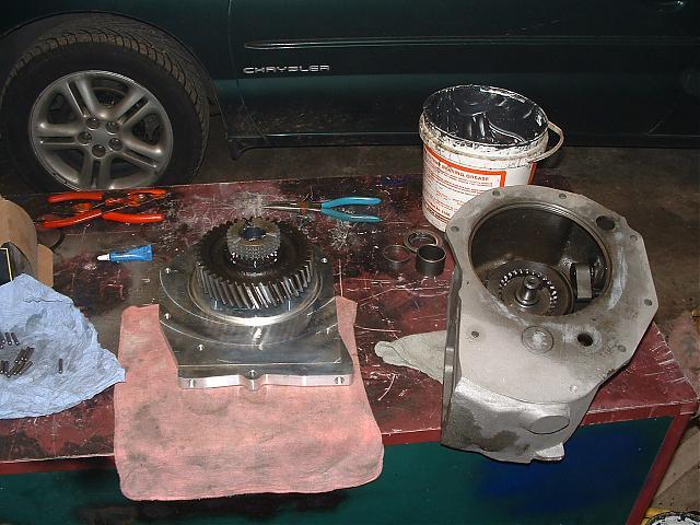

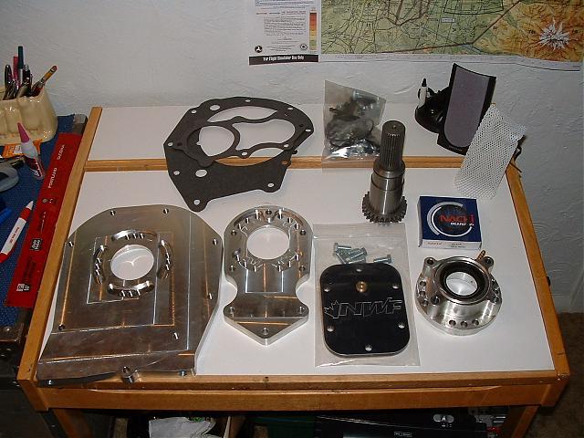

Wow, finally I got parts, and they're pretty! Now time to get to work and continue on. I helped Stan (model A buggy) most of the weekend on his Diamond 609 assembly. Wow, what a job. I was kind of disappointed at the fit of parts for that kind of money. Not to mention installing an ARB air locker in a 9+ case, lots of grinding to do. Anyways, I got my Northwest fab stuff and I'm impressed with it, good looking parts. Heading for the shop to start assembly. Yeeehaaaaaaaaaaaa:awesomework:

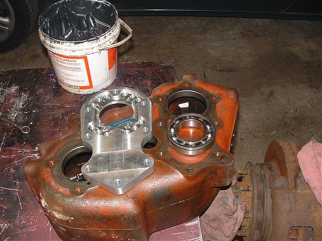

got the 203 range box together, now tomorrow I need to get the 205 machined out for the larger bearing that the input shaft takes, then continue on.
