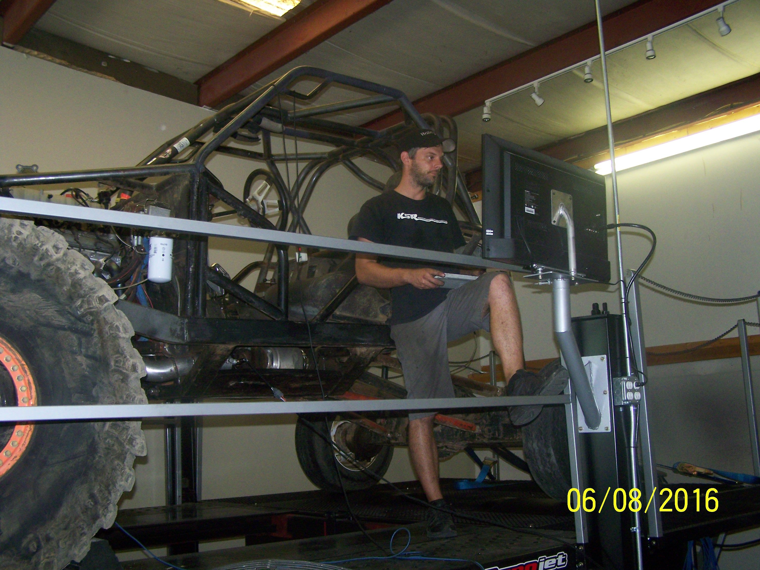

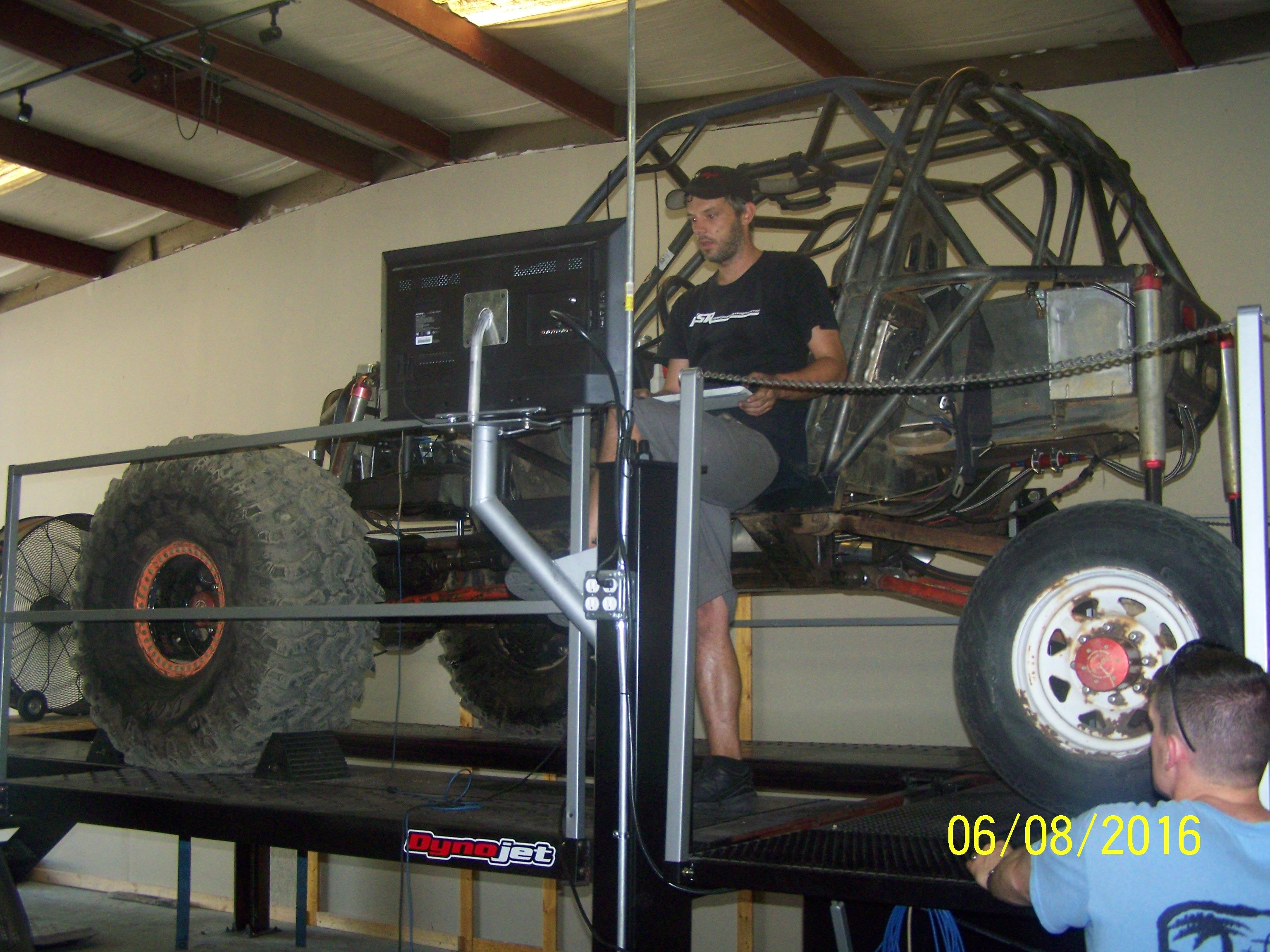

Couple of pics getting ready to make a pull. I have video but I have never been successful at posting them, the few I have one here have been posted by JJ for me.
