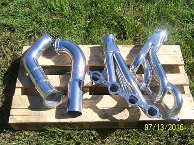

While I have it all apart I sent the headers JJ built for me to Q.C. Coatings up in MI. Bill Walker is a heck of a guy to deal with, he coated them, put then back in the mail and went on vacation. I haven't even paid him yet. I hope they are at the house when I get home tonight I will get pictures and more information about their product later.
RTR
Got these back from QC Coatings Shelby Township MI. Coating is their Ceramic Silver said to be good to around 1600 degrees. QC said they have seen as much as 200 degree surface temp drops with this coating. Shipped back to me was a little less than $300, they were great to deal with and fast turn around. Thanks again to JJ for welding these up, great job buddy and I still can't believe how loud they are without those yard sale mufflers attached to them.

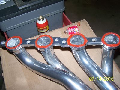

True surface, no gasket just Hi temp silicone
