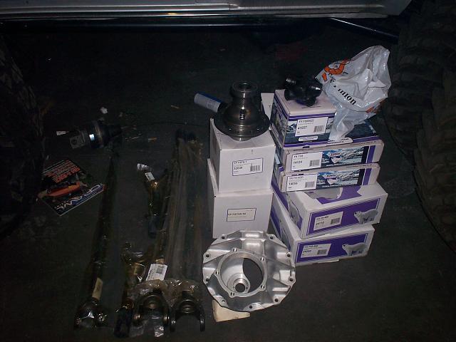

Set up the 9 last night.

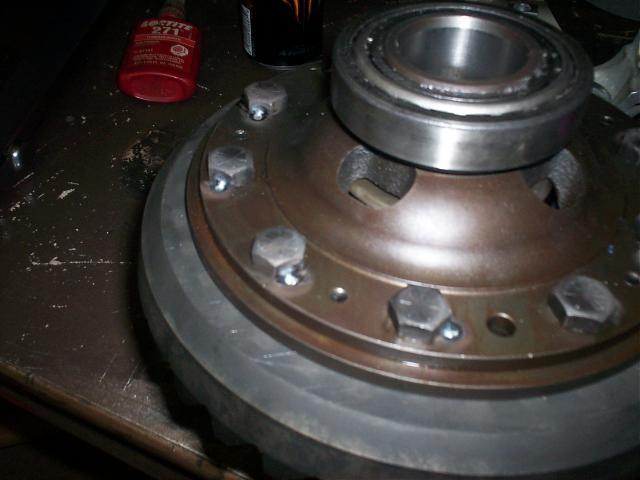

Brad, I think I have a descent fix for the ring gear bolt's backing out.:;

That should work just fine for a trail rig :awesomework:
Actually pictures arent the best, I'd guarentee it for 100,000.

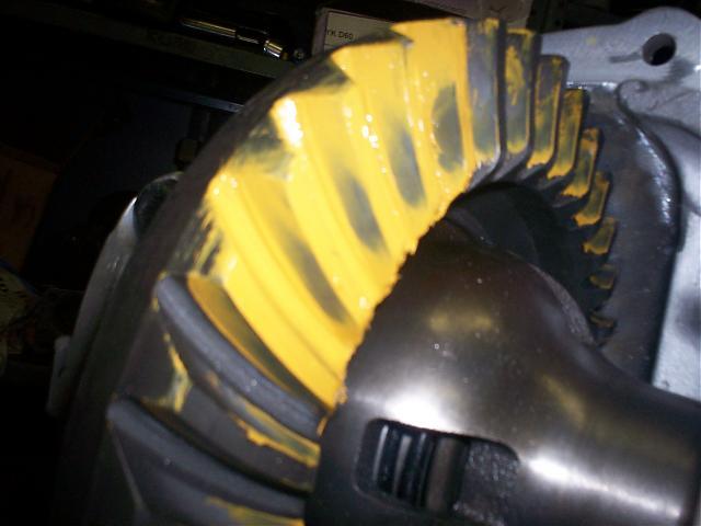

I could have dialed it in better, but after 10 or more in and out's clearencing the housing I said **** it (it's an early Yukon 3rd, they need the **** ground out of them so the gear's actually rotate, 2" wide 1/8" trough all the way around and about 1/2" off of the pocket bearing boss).....good enough.

I don't think you will EVER have a problem with it.
I think the only time you might have a problem(not in your rig) but under the cirmcumstances where there is ALOT of ponies---like a drag car where torque is aplied to the bolts/stretching. But like I say you will be good to go....

Well in that case I would set it up at .004-.007 and run the pinion on the shallow side. Thank's for the re-assurance.........I know it's good to go.:fawkdancesmiley:
