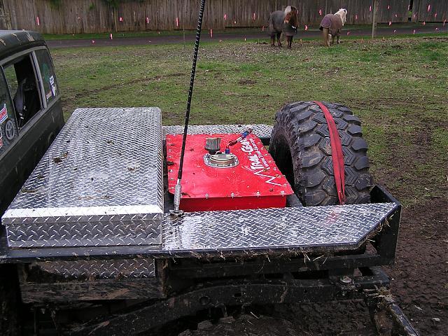

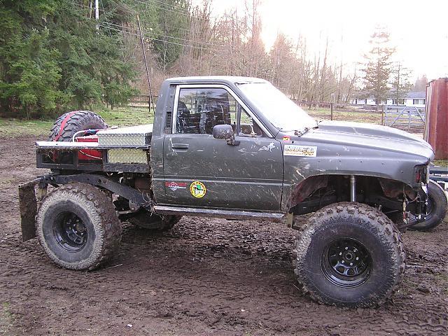

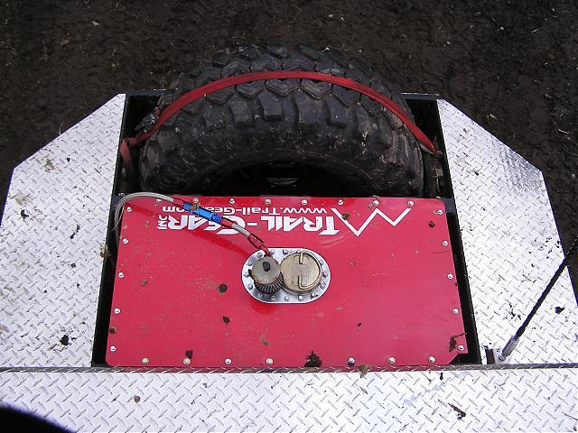

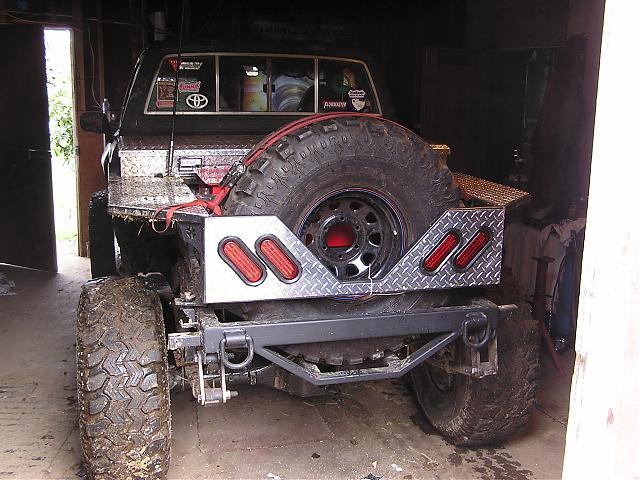

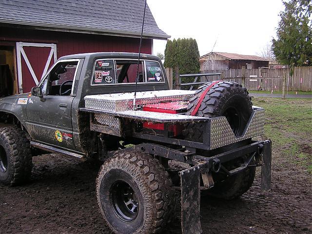

my some what new toy build

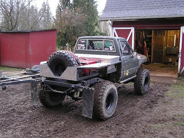

so i got the diamond plate cut and rivited on. looks pretty sick. also got it driving and am pretty stoked. heres some pics.

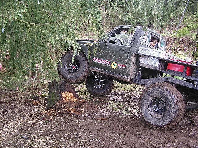

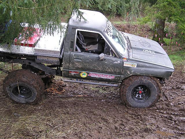

so here are some updated pics.oh and some of the bosses race truck... how you like them onions?

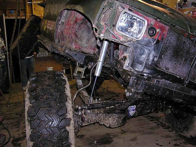

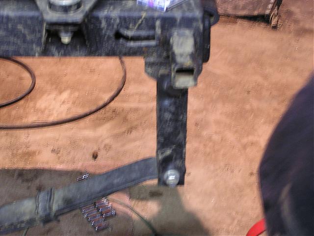

got some new 44044 waggies today along with shackles and rear dakota springs, also got a rebuilt ifs box and 4 rancho rsx 14" adjustable shocks for 300 hundy. so i put the waggys in, what the **** was i thinking before??? these things work great. one of the best things ive done to this truck. still got to do the rears. how do i figure out were to put the new hanger. as far as loaded spring ride. and how much angle do i want in my shackle at ride height?

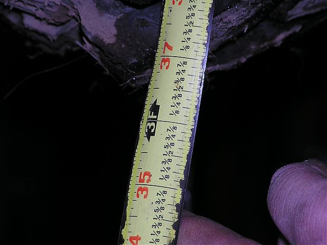

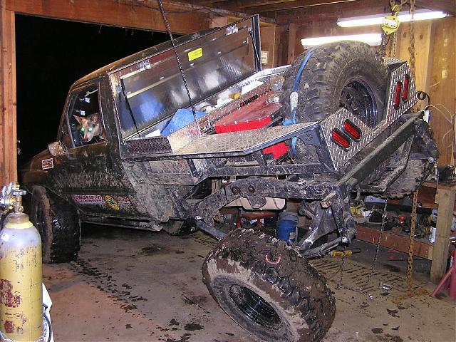

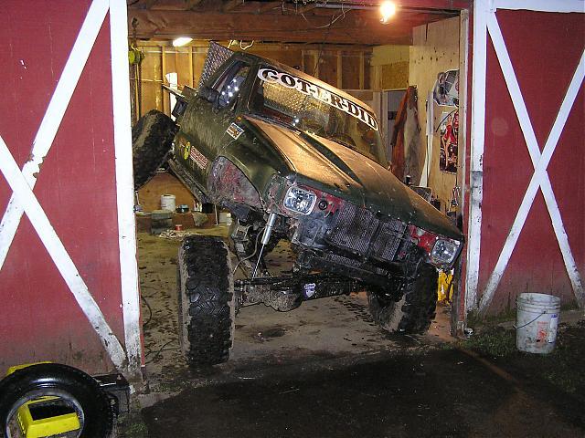

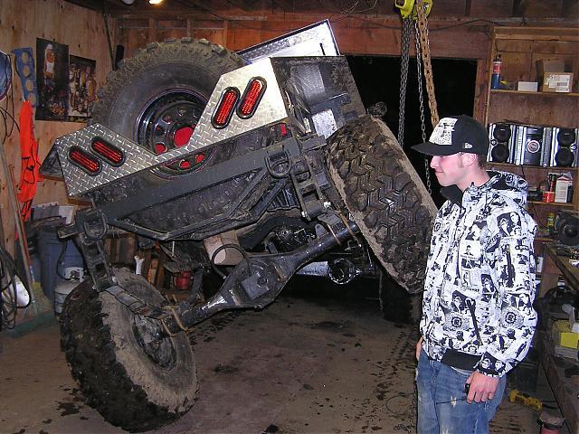

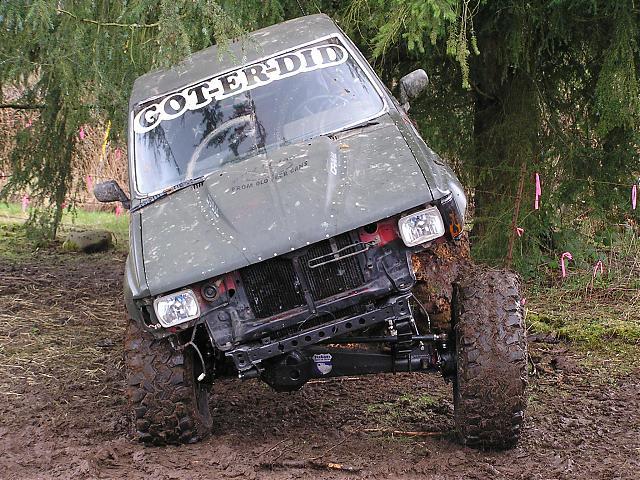

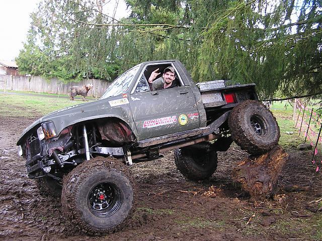

so tonight i worked on the rear suspension:awesomework: . got the new hangers in and springs along with cleaning up the rear housing some more. got some poser flex shots for ya to. im not sure yet but think i need to move the front hangers back more to allow for more shackle angle and resulting in more droop??? :corn: im not to sure if that is correct so help me out:corn: . i want to maximize these springs and they are fairly flat. i set the front hangers with a very slight angle on the shackle. the springs are very squishy:redneck: but as the truck squats the shackle barely moves leading me to believe i can allow more shackle angle at ride. as it is i get 36 1/2 inches of tape messure under the right rear tire without any of the other tires lifting. what do you guys think?

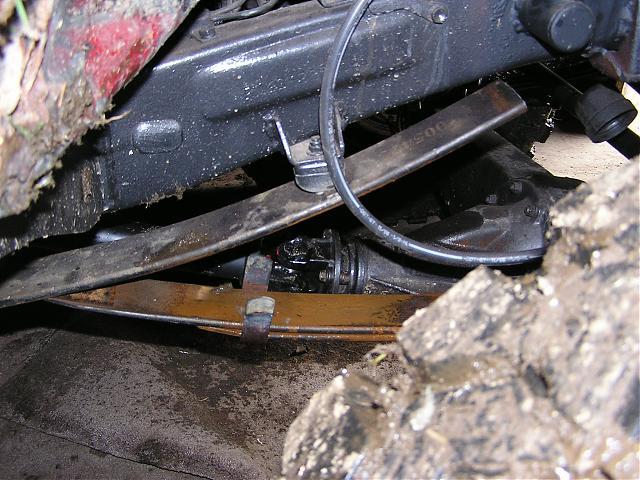

and some more. the one of the shackle is just the spring no axle. to me it seems like if i add more angle it will allow for more droop. the shackle barely swings back under suspension compresion. am i right or wrong?:eeek:
