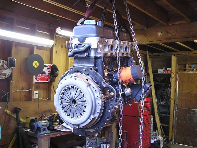

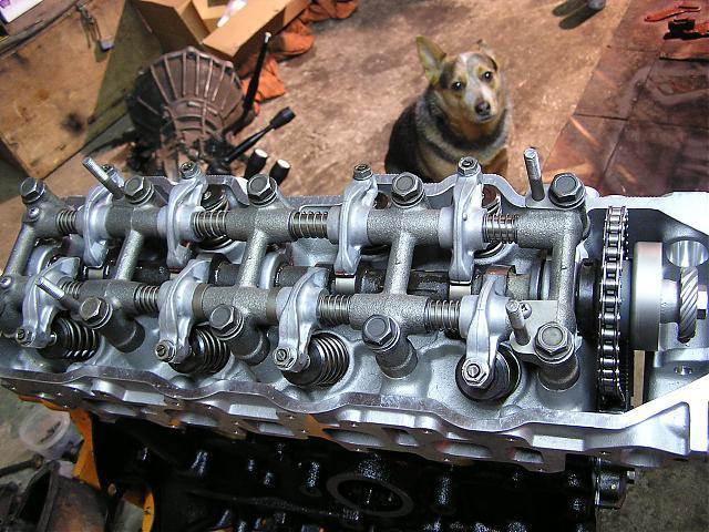

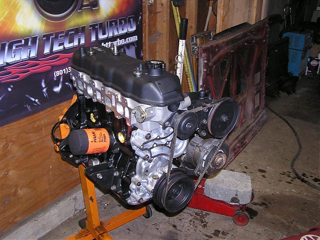

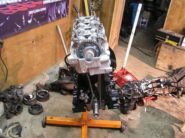

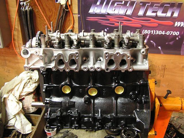

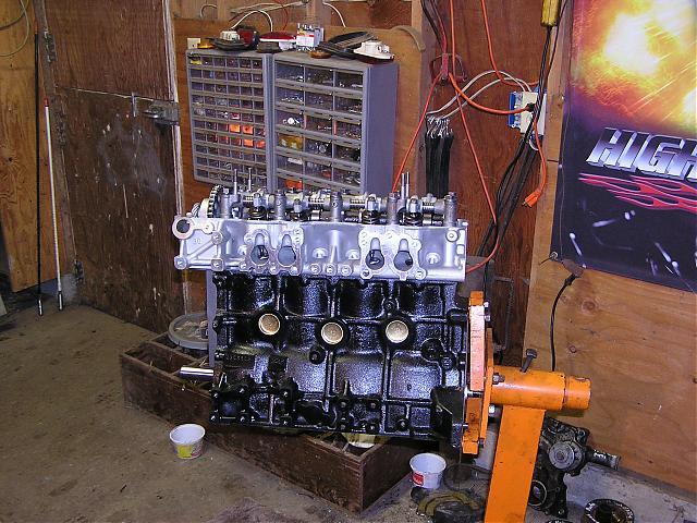

so the motor that i had turned out to be a pile of scrap metal, along with the other two i had from before. i decided to look around and see what was out there. i thought about rebuilding one of my cores but the price didn't seem to add up right to do it myself. with maching and the new parts(pistons,cam,head work, bearings etc) i was looking at a lot more than i wanted to spend. i also liked the idea of a warranty. i wanted to get a "new" long block with some goodies. i checked a few places and the best price/warranty i found was through oregon engine rebuilders inc. they have 3 stages and they all come with a lifetime unlimited mileage warranty. i went with the stage 3 which consists of a new heavy casted head, swirl polished vavles, 3 angle seats, bronze guides, springs, retainers, keepers, crane cams torque cam(425/IN and 440/EX lift, with a 260IN and 280EX duration), kieth black 9.7:1 pistons, high volume oil pump, new timing cover, and steel timing guide. the power band is said to be idle-4000rpms which should work nicely. it may be squirrel power, but these squirrels are jacked up on mountain dew. i also finally got the rest of my stuff from marlin and through that together lastnight. cant wait to try it out...:beer: :beer:

hell yea lookin great:awesomework: i just put the same pistons in my 4cyl, hyperutechtic coated? where did you buy your oil pump from? what did your motor run you?
it was 1700. pretty penny but cheaper than everywhere else. plus 10x the warrenty. most other places only have maybe 3 years or 30k miles. how do you like the pistons?

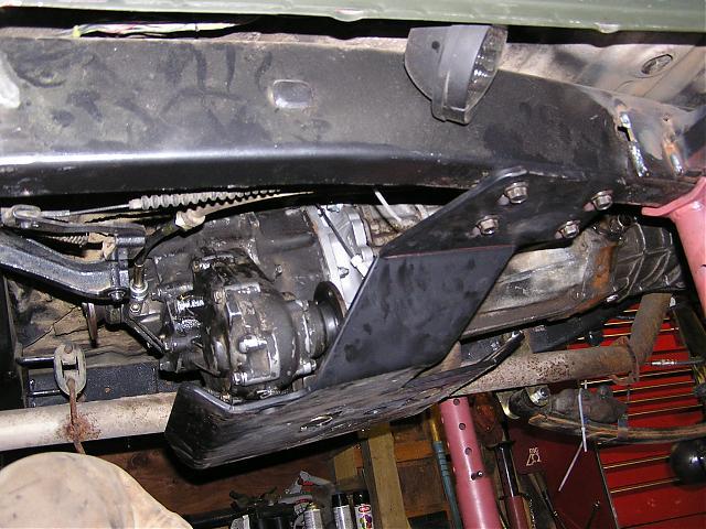

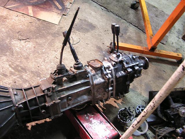

so today i put my dual cases in. i found out that i need to take a dyegrinder to the drain plug holes as they dont quite line up with the drain plugs, unless... wait a minute... ill get back to that later(just thought of something). my motor is also ready to go and and i might be able to get to that one night this week. really excited to see this thing coming together the way i had visioned it in the beginning. anyways heres some pics.my dog always seems to make it into the pics. she cant wait to go wheelin either. happy building:redneck:

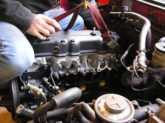

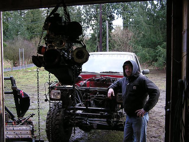

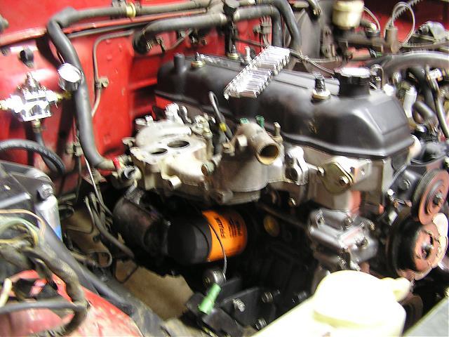

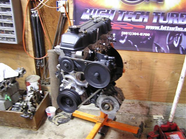

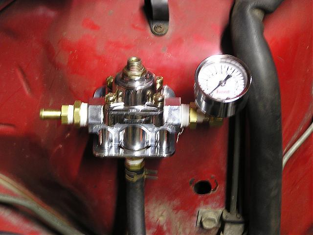

today a buddy of mine came over and we slaped my motor in. its been a while since it has had a "not fawked up squirrel wheel" in it. cant wait to get it goin, and spin a couple shitties. also mounted fuel pressure regulator and next is the fuel pump. still need to do drivelines and finish bed. think my tax return will cover a new miller 252 mig. cant wait for that either. happy wrenchin:redneck: :beer:

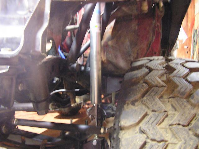

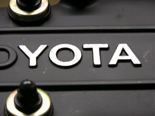

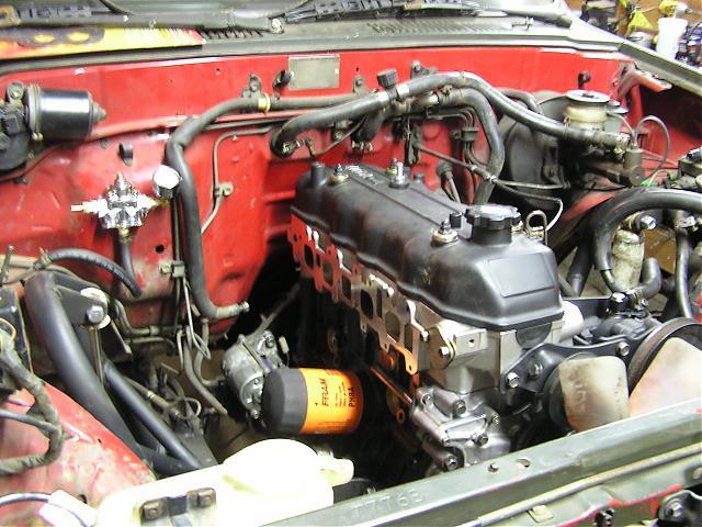

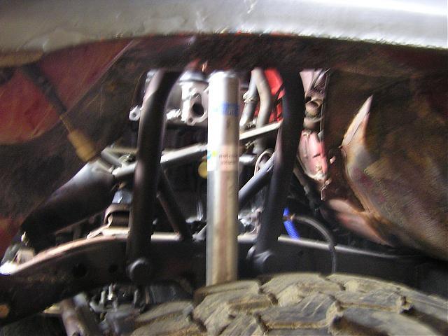

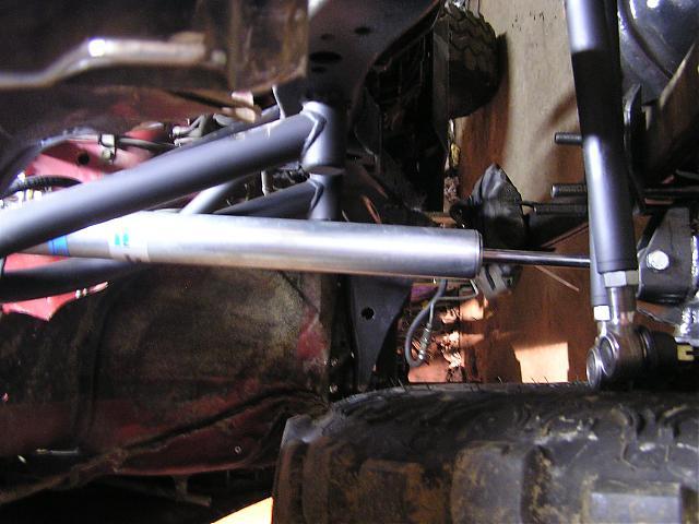

got some shocks. put the fronts on and not sure yet what im doin with the other two. got a pretty good deal on them so i might just keep'em and use the other two on the rear. right know they wont fit but i might be changin that here right directly. my dad stoped by to suppervise a little. also put intake and other accesorries on to. hooked up exhaust and header. blah blah blah. treatment takes up most of my weekday evenings right now which sucks.:mad: :puke: :beer: :beer:
Was that over dinner? SUPPERVISE?
LOL ANd why would you want the MM252?
