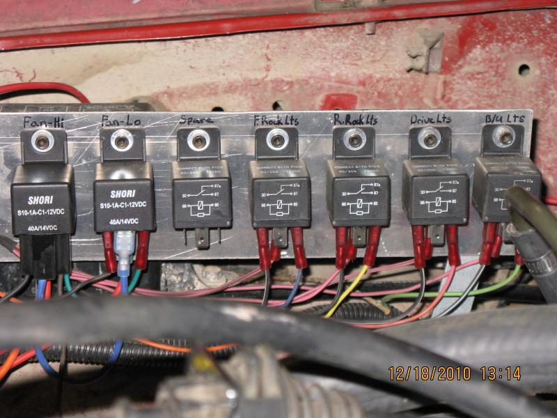

Started throwing wire at it.
Now I actually have to figure out what to do with the relays. lol
Here's what I ended up with.
Thanks for the visual, but I am retarded. :haha:
I have mostly LED lights so I only am going to relay my Fans, and hella lights.
I can fit them on the back of the panel, but have never REALLY looked at how they work, which ones I need , and how to wire them.
I will be looking into that this evening. Thanks again for the pic!

They are pretty simple to wire. You can see that most of mine have the diagram right on them. Run power from your switch to pin 85 and ground to 86 (you can tie all relay grounds together since it is low current). Run your high current fused power to pin 30 and hook your load to pin 87. Easy peasy.
What about on-off-on switches. Those I am assuming require a 5 pin relay?
I have one for heater fans, and one for radiator fans.
cheers
