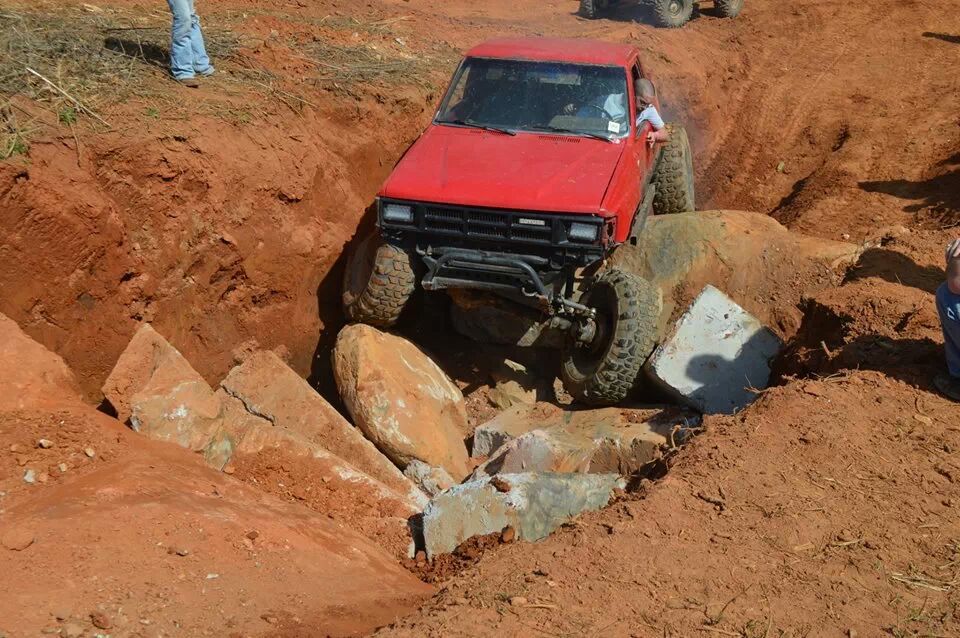

Think i rode with you a little bit at the flats a while back. My truck is that red toyota and I was with a tracker and a samari buggy

Yessir that was me. Was hoping to get back out with yall sooner but ended up tearing it down. Are you going on the hardline forum ride to Harlan
