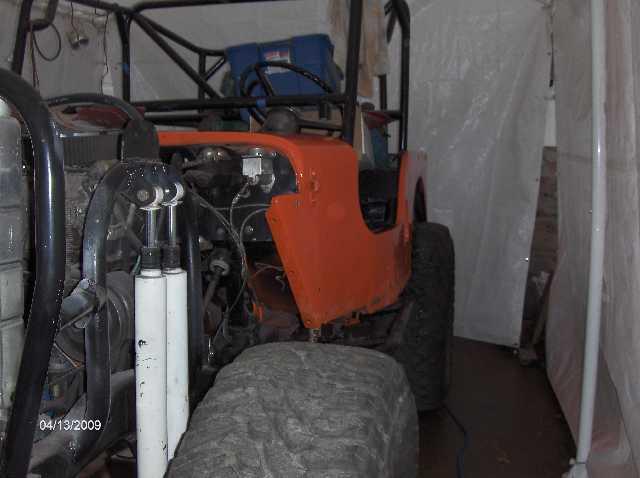

I actualy spent most of the day working on the jeep again.:haha: Summers getting close I need to get my butt in gear:haha:

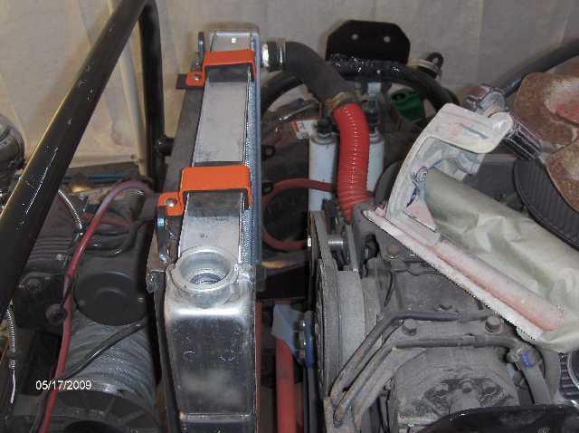

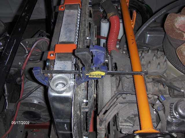

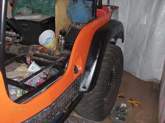

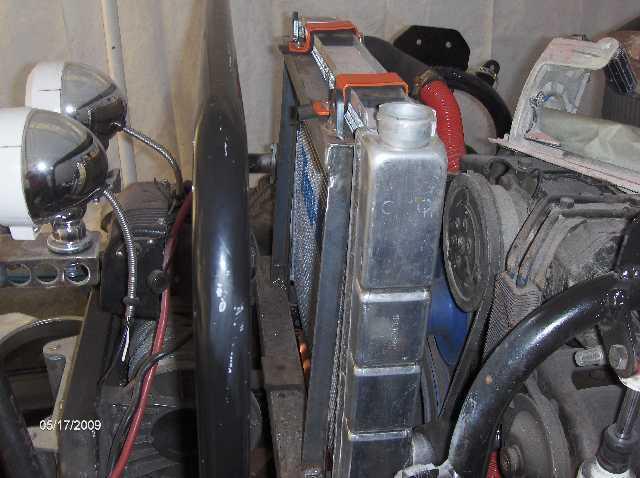

So I got the radiator mounted up and started in on the fans. Got the shroud/mount made up and just need to pull it all back apart againg to weld some mounting tabs on to the shock hoops to hold it all together. Looks like I will have a whole 1/4" clearance between the one fan and the AC compressor:eeek: Got the diamondplate back on and the drivers side fenderflare. They probably wont last long but the TJ rear flares cover most of the tire (all that street legal jazz):haha:

Nope Hasnt ran since I pulled it from the cj5. That was the biggest Radiator I could find that fits in a flatty. I am using a set of twin flexalite fans. Worked great on the old rig and I like the idea of having two fans so if one pukes theres still a backup. Plus their pretty thin.
Jim-
The lack of pulley clearance is a bit scary. I can easily imagine the flexy frame of the flatty allowing the pulleys to hit the fans when all flexed up.
Jim-
Yep I know I am hoping to get about another 1/2 by reversing the radiator bracket and taking some meat off of the grill
