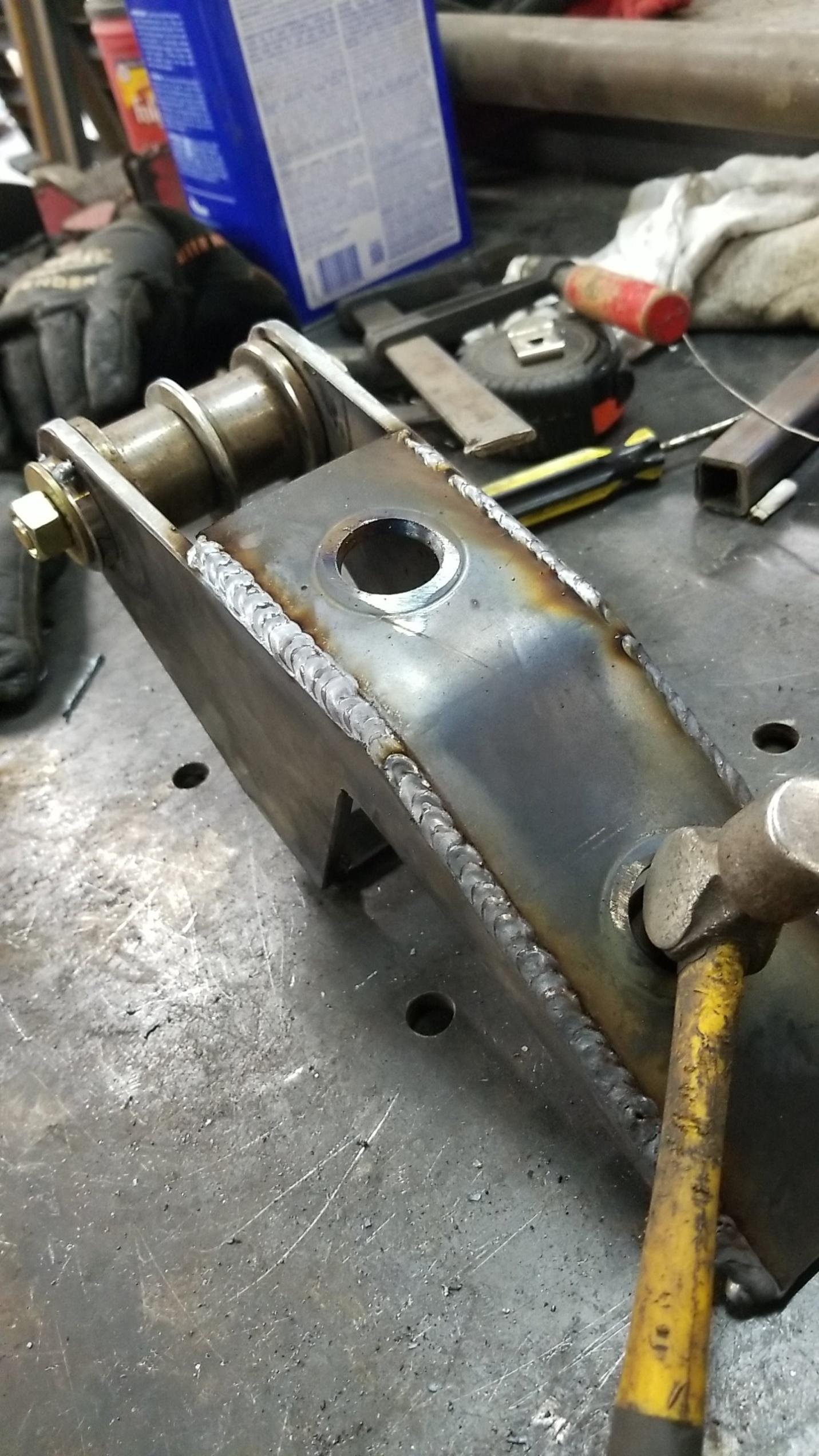

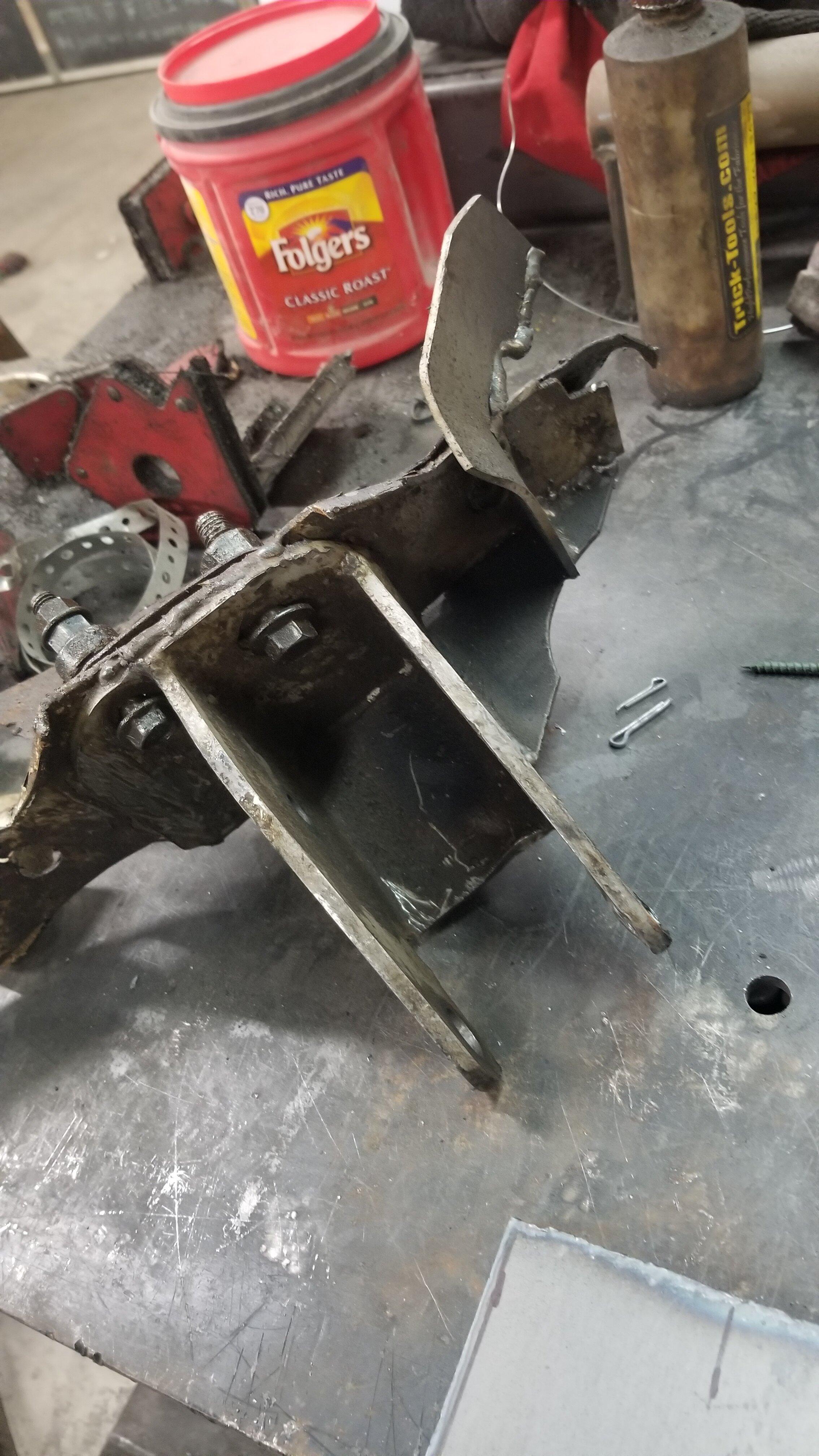

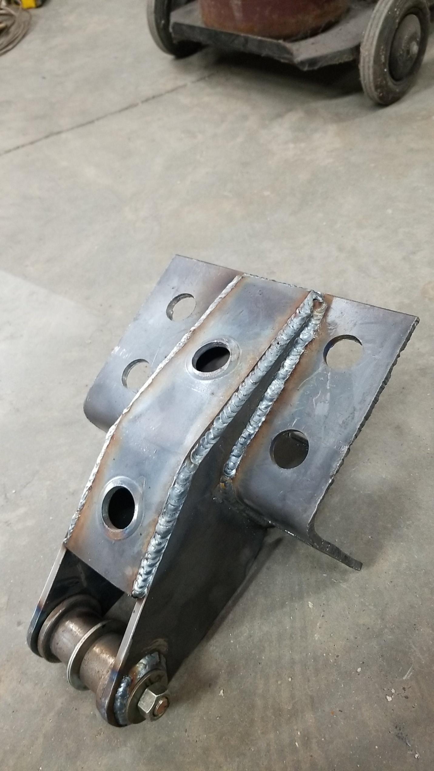

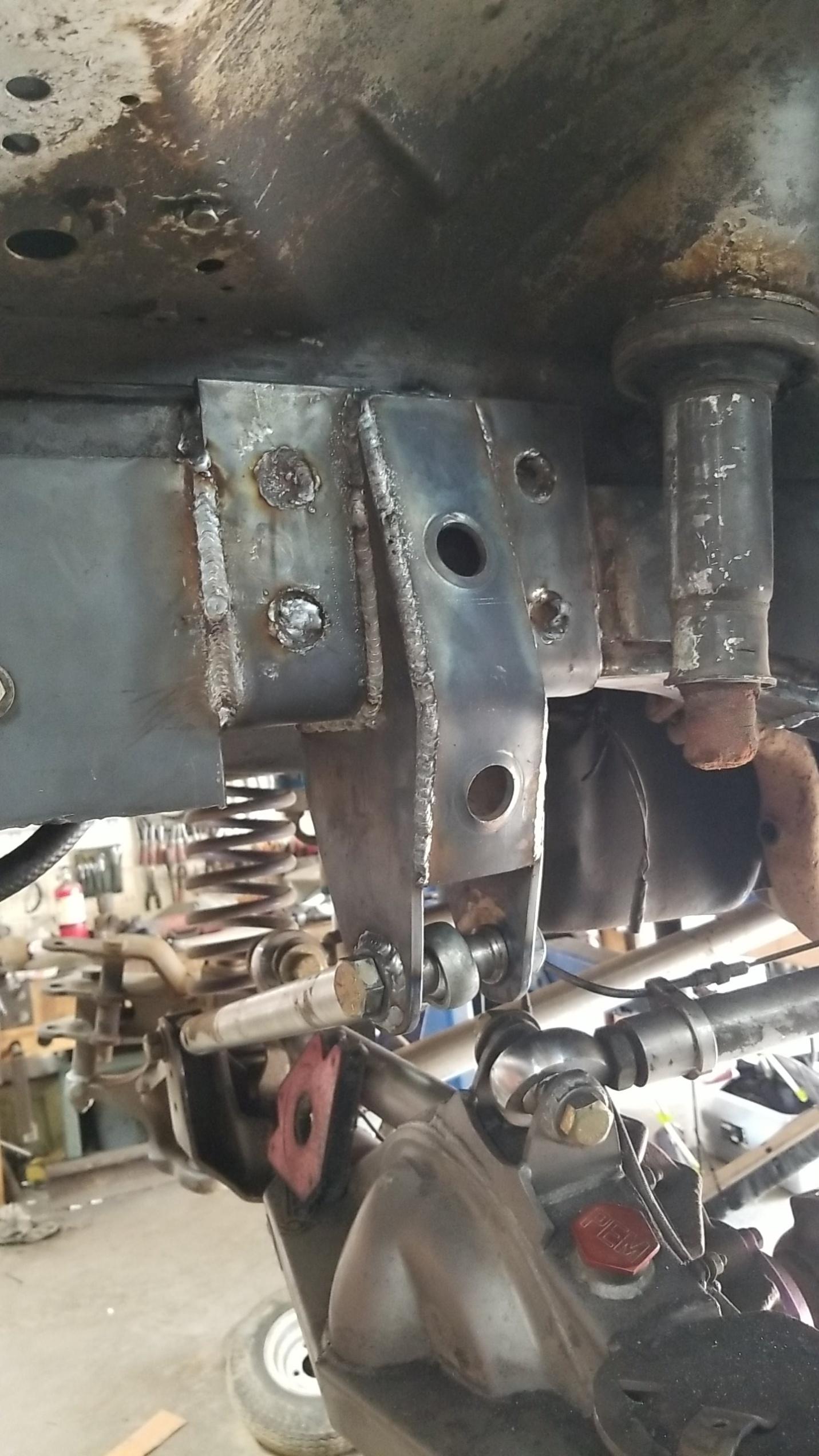

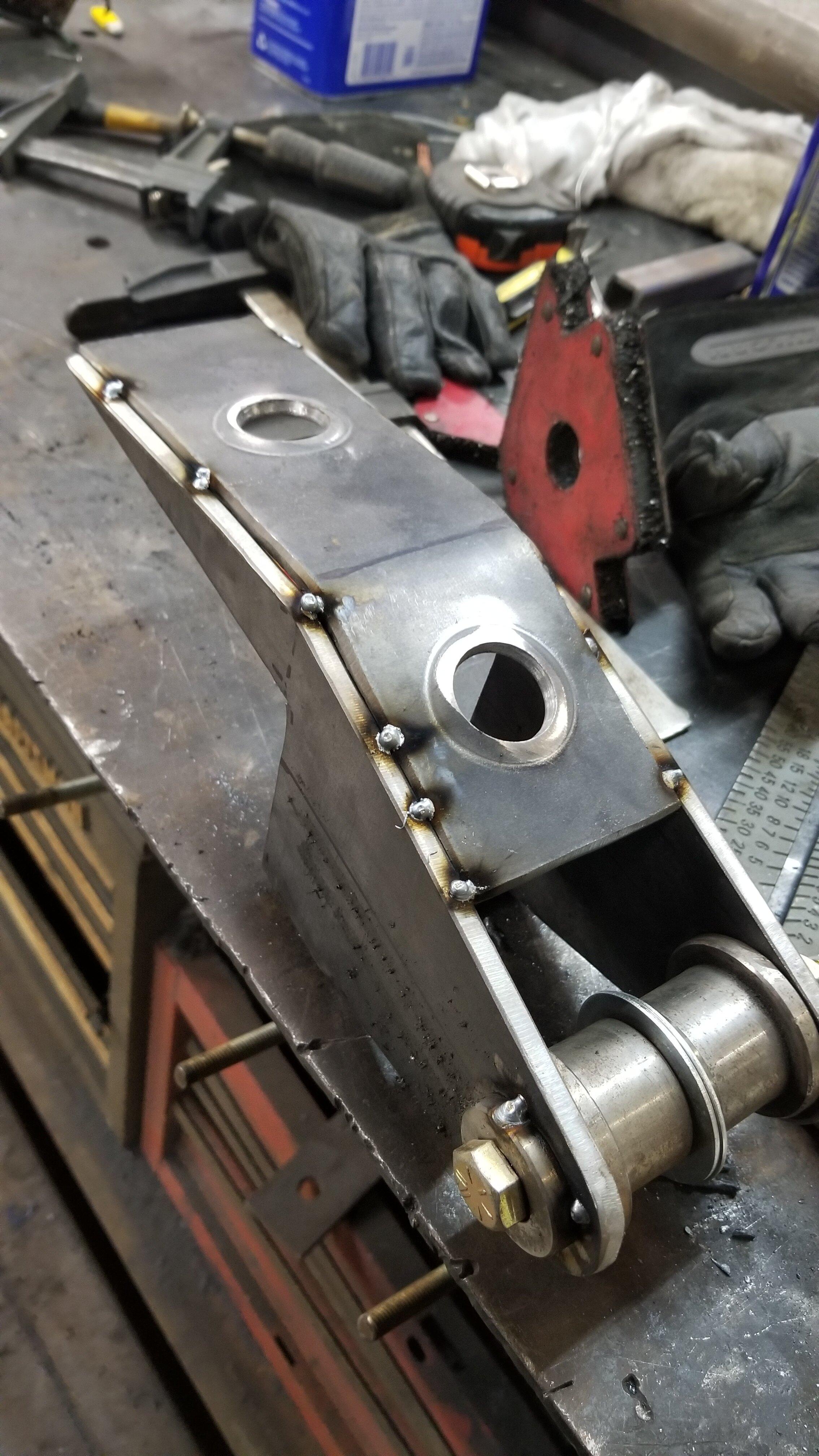

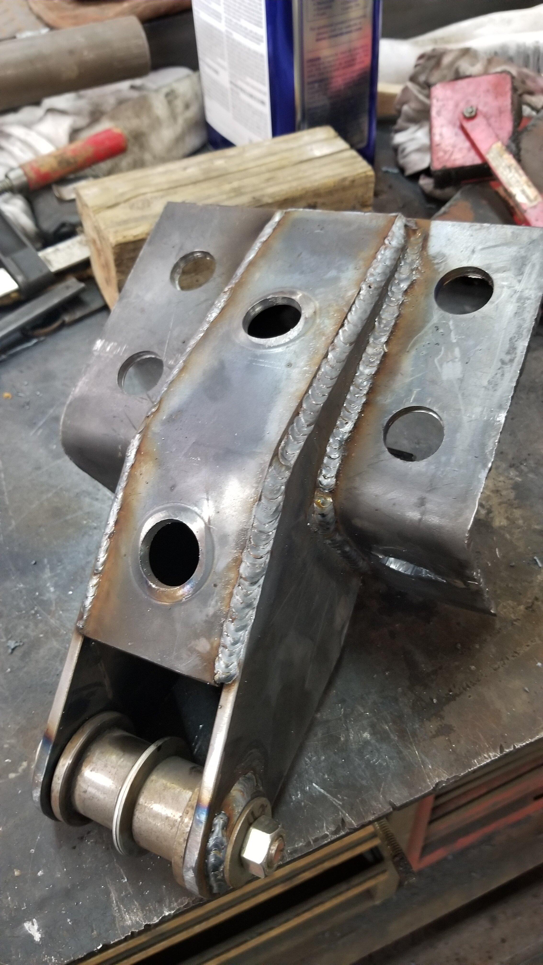

Finished up the new mount. All 1/4in with dimples and plug welds.It fully wraps around the unibody.Welded to the inner steering box stiffner and the motor mount.Really happy with the finished product.

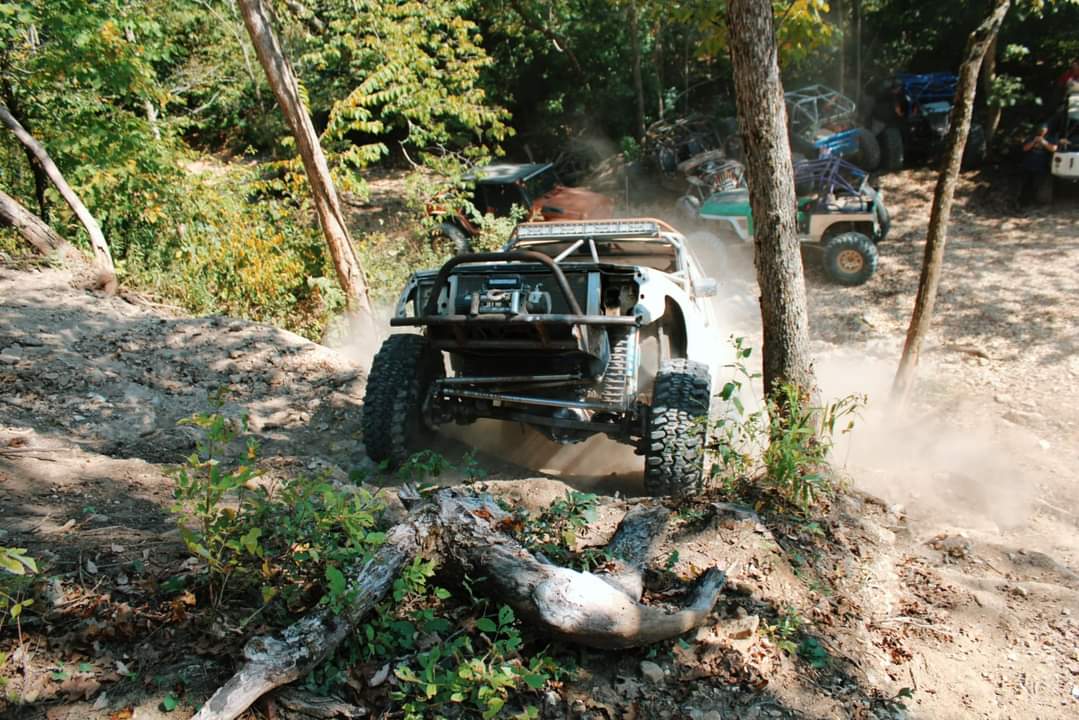

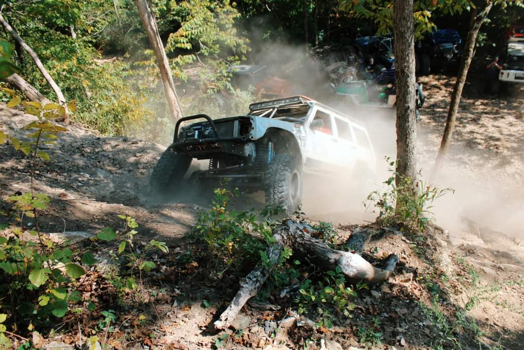

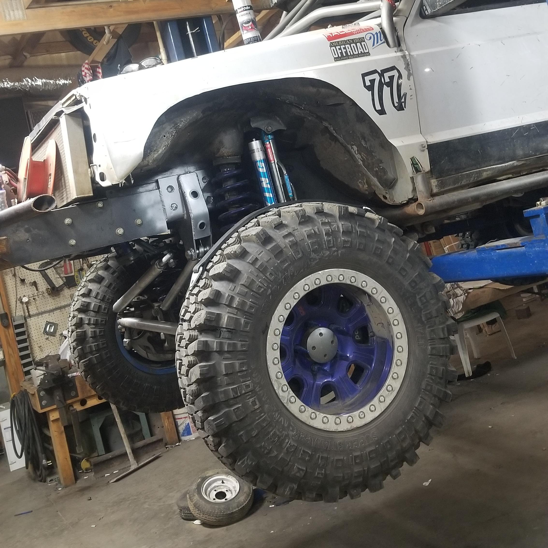

This pass weekend took the jeep to Midwest Jeepthing's Jeepstock at SMORR with my friends.Had a good time wheeled for a bit.Then found out 1/2x20 studs are not strong enough.
Had the wife run me down some replacement after shearing 7 studs total on the front. Plan on tearing apart the UBs and installing some 5/8in studs to eliminate the problem. Thankfully the rotor took the hit well.
5/8 are going to cause problems with the Race Line wheels. You cant or i could not get a socket on,or find a lug nut thin enough.I ended up going with 9/16 and they have held up OK.
I have 2 spare rims I might try and machine the counter bore to a large diameter.Or search for a 13/16 head nut.
