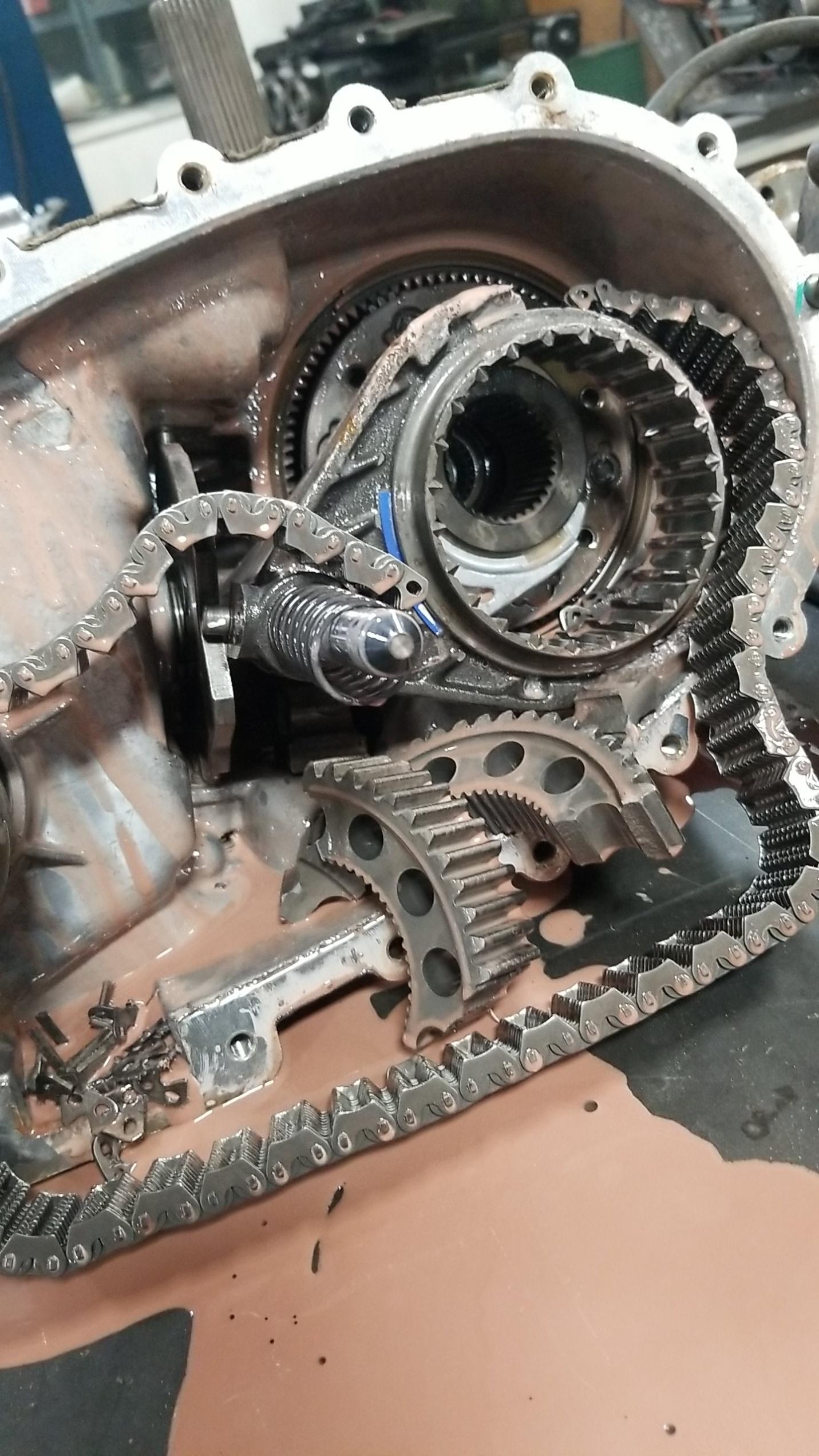

Climbed one of the big hills ar the park this weekend.Nice to finally climb it.But broke something in the jk tcase. Front will pull in 4high but not 4low
Broke the JK 241 really good. Time to save up for an atlas
