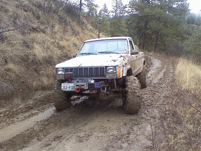

Some pics from our xmas tree run, everything is holding up good so far, lovin the build so far, added an electric fan finally also.:redneck:

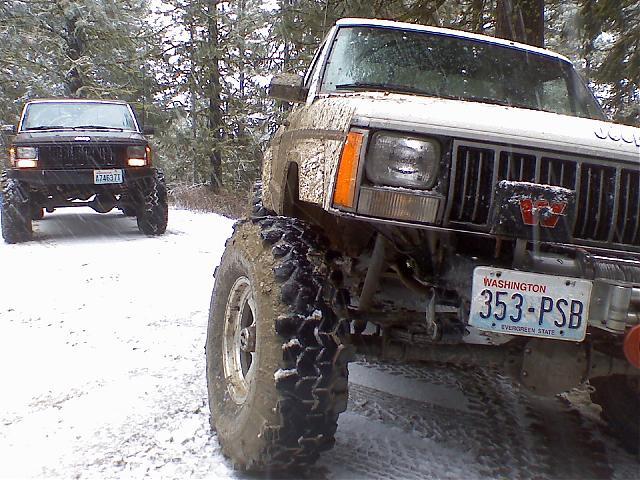

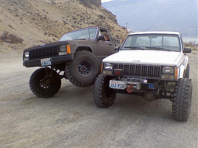

That was a fun day. Coupla pimpin' Comanches out wheelin'. The brown one is my brother's (Co-Man-Che on here), I just stole it for the day.

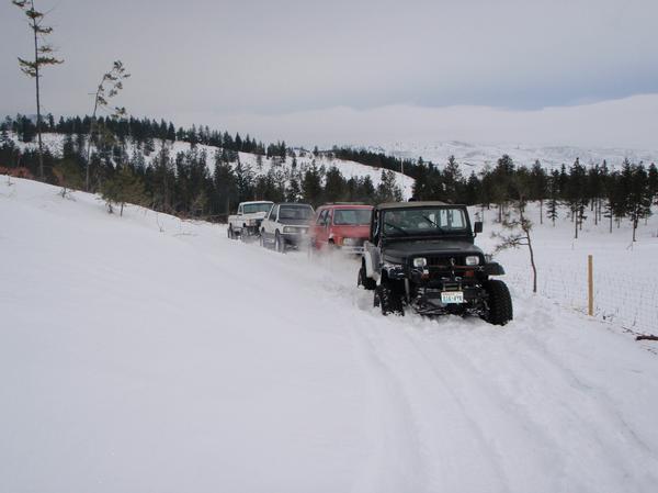

Played in the snow today...got hi centered....so did Matt...still don't think I learned my lesson....haha.:mad: :mad: :mad: :cool:

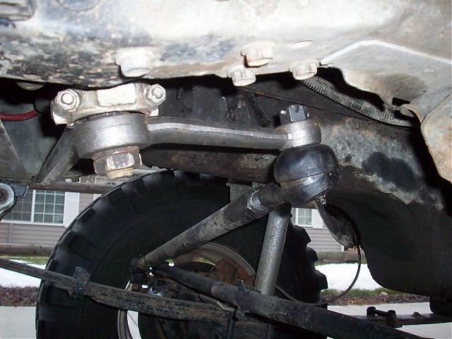

Got my steering issues all delt with...used a waggy pitman arm reamed for GM tie rod end. finally got full steering bump to bump.

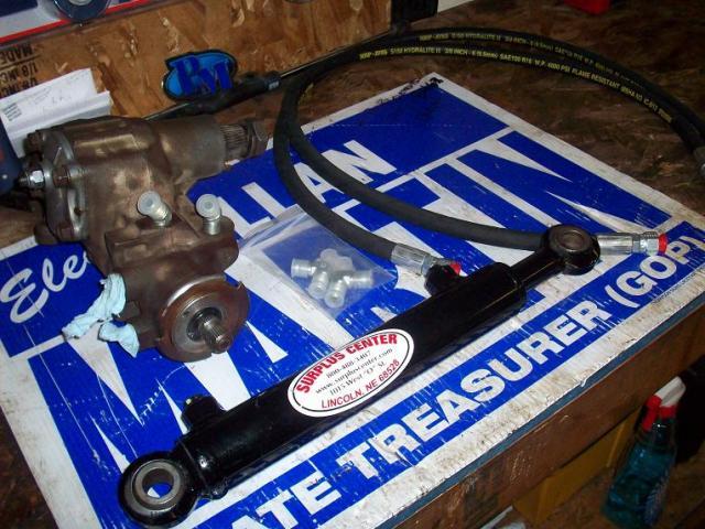

I ALSO ORDERED EVERYTHING FOR MY HYDRO ASSIST...GONNA TAP MY BOX THIS WEEKEND....

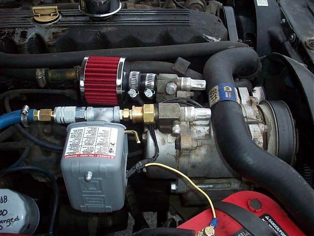

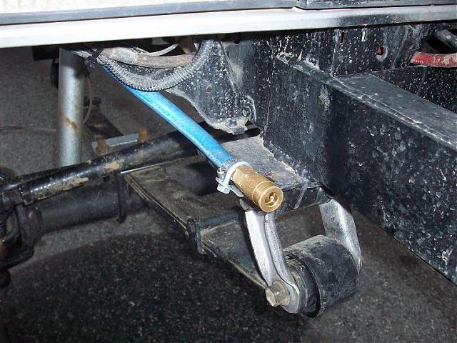

On board Air, Made with Square D pressure switch, some fittings, quick disconnects, and an air filter...oiler to come.

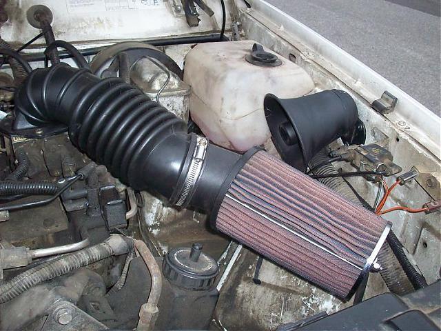

A homemade intake(actually gained me some horses)...and added a PA speaker to the CB..

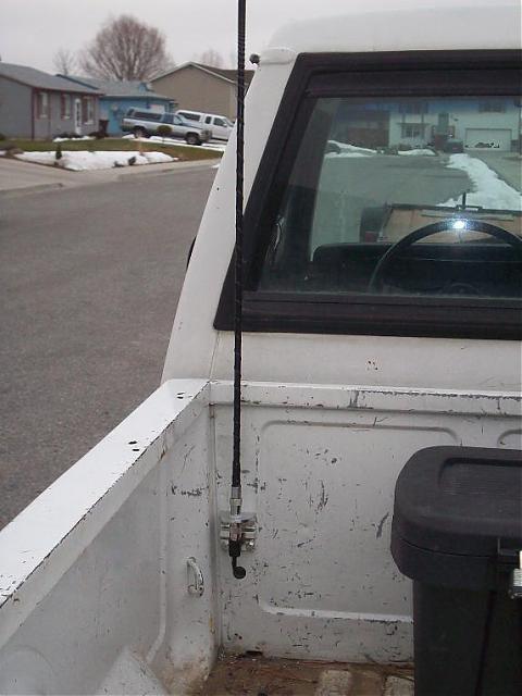

Mounted a CB antanna...hid it behind the cab for protection...seems to work good and it is still about a foot over the cab, says you are supposed to have 2/3 over roof, but It hit my garage when I pulled in and was annoying.

Like I said before....here is the pitman arm I went with reamed out from PARTS MIKE....full steering finally from LOCK TO LOCK...much better.

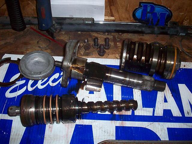

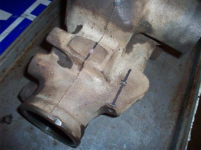

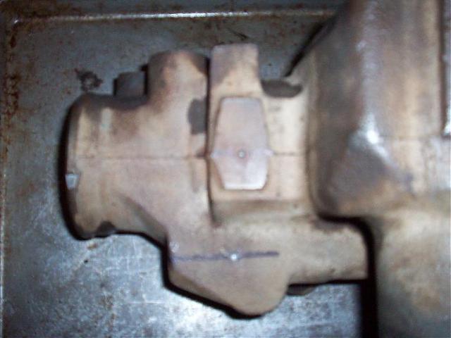

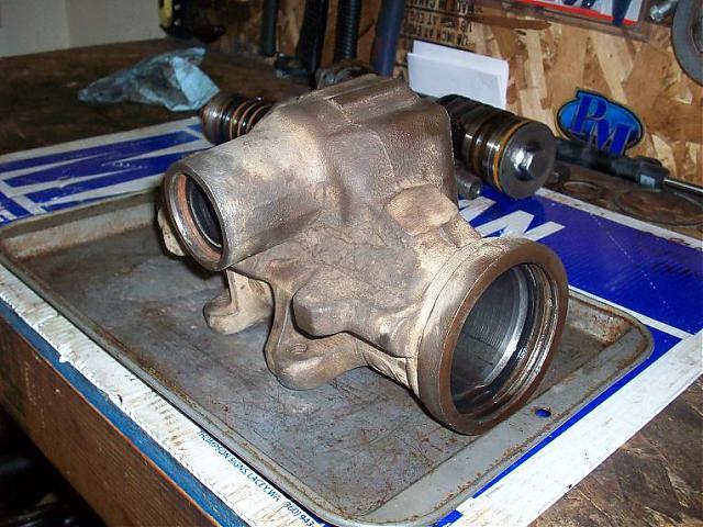

Before drilling the holes for the Hydraulic lines you will need to fully disassemble the power stering box. Thats one reason to do a full rebuild with new seals and bearings at this time.
1. First remove the pittman arm
2. Remove the 3 steering box bolts holding it to the frame.
3. Remove the high pressure and low pressure line going to the power steering box. place a oil sheet on the floor about a qt of fluid will come out. keep the lines tied up and clean.
4. Remove the shaft from the steering wheel to the box, be carfull the box is heavy.
5. Now work on the box at a clean bench, use pliers to remove the c-clip on the pittmanarm shaft. Remove the top 4 bolts at the other end of the shaft. make sure the pittman arm was centered, then this shaft will pull out. A lot more fluid will spill out, get a bucket.
6. Now remove the LARGE c-clip at the end of the box that goes against your bumper. At the top of your box there is a pin hole push through the pin hole to help get the clip out. Slide the pittman arm shaft back in, and turn it. This will move the big pistion and push the cap out of the end of the box. Now pull the pittman arm shaft out again.
7. Keep turning the steering wheel shaft till the piston comes out of the end of the box. You will probibly hear the bearings fall into the big piston. they will, so dont loose any.
8. Now remove the c-clip at the steering wheel shaft side.
9. With a hammer you should be able to tap the ring (yellow in my pics). The ring has three indentations on it you can tap on. Just screw it out. Then the spiral shaped shaft and the smaller piston will pull out.
10. Now you can drill the holes for the ram. The top hole will drill all the way through. I used an 1/8in bit for pilot holes to keep it centered. The bottom hole only drills half way till you hit the hydraulic line hidden inside the casting. Both holes are 7/16in (look at the pics for locations)
11. Tapp the new holes with a 1/4in NPT tap. The top hole is easy, the bottom hole will only go till the tap bottoms out. Then I cut about 3/16in off the tip of the tap, then continued with the bottom hole till it bottomed out again. The tap was like $6 at Home depot.
12. Clean the box with paint thiner to get all the grit out, then use a air sprayer to get all the metal shavings out. Paint it and stuff. Then put the 3/8in to -6aN fittings on the box using pipe tape.
13. Put new seals on the pistons. kinda tideious. (see pics)
14. Re assemble.
Did this last night, want it done before hydro stuff gets here...:cool:
Notice where I punched to drill and tap on the box...need to get the tap tonight and a new seal kit.

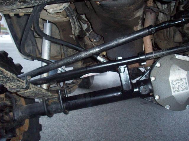

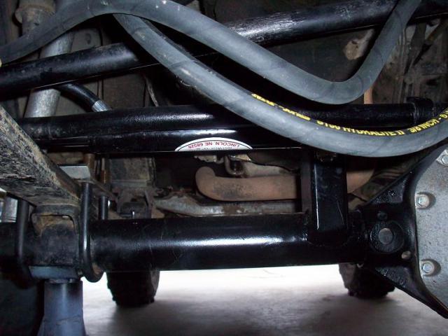

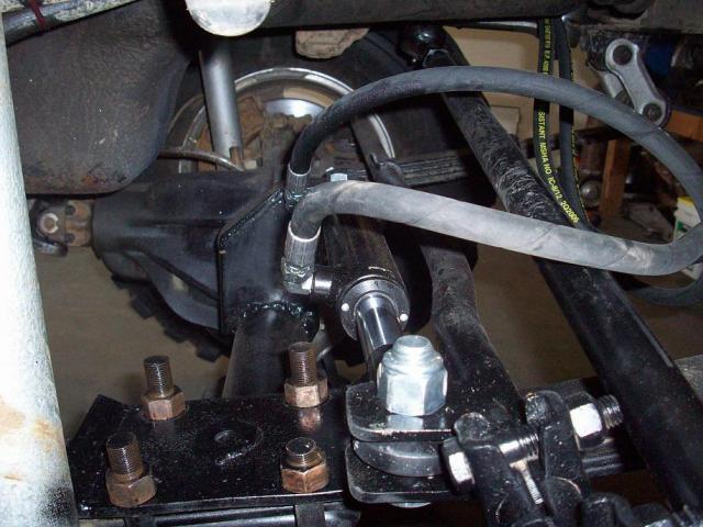

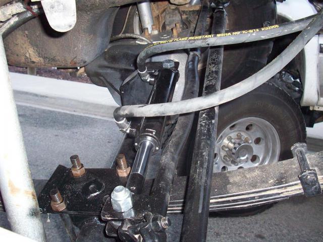

here it is...all wrapped up, had to take a alittle off of the passenger ubolt plate, and cut down one of the ubolts...just need to get the damn thing blead all the way...???
