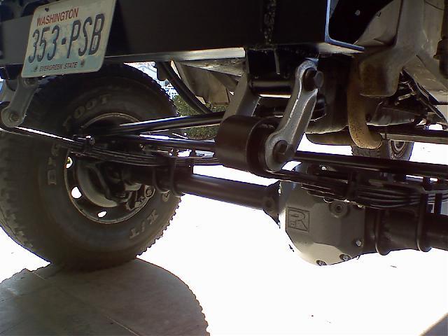

shackles forward is the only way to go. I did a shackle reversal and it sucked! Tons of pinion movement and it did weird crap when climbing obstacles.
I also prefer shackle forward for a sprung wheeler....:awesomework:
You know....I considered doing shackles on rear but after mocking it up(roughly), I decided that I liked the way it sat with shackles forward...plus I'm gonna be putting even smaller than stock wrangler shackles up front...my angles are good. Plus I'm using the stock driver purch built into the diff on the hp44 and if I put shackles rear my pinion angle would be WAYYYYY off...as it sits it will be close to "right". The leaf angles are sitting good also as if I had a shackle reversal on it now...so ride/handling should be pretty sweet also. I just hope this **** turns out good altogether...I got in pretty deep with this project...much more extensive than I have ever done at one time.

Yeah, I agree on the shackle forward also---It's just alot of people talk about doing shackle reversal on their rigs.... Also, if you want to 'tighten' up the front end, you can build a custom track bar that will hold the front axle in place and keep the shackles from 'twisting', yet still allow flex:awesomework: ....

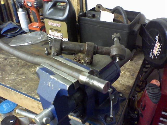

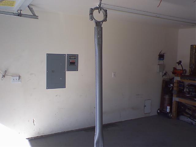

This is me cutting down the stock ford tie rod, I'm reusing it trying to save some funds for now...had to cut it down 2.5in. Its a sold piece...should be plenty strong.

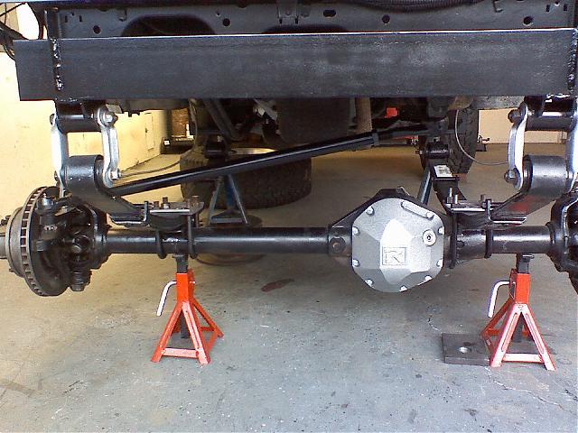

This is with the draglink painted and installed.

This is with both tie rod and draglink done.

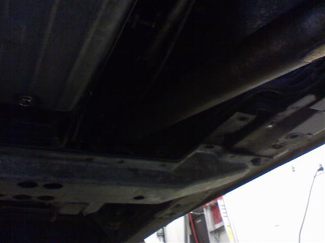

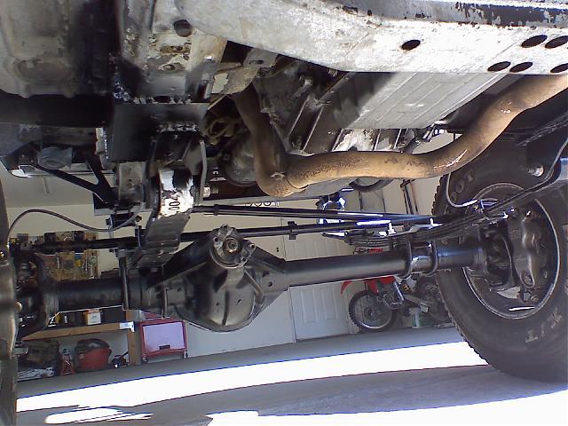

Some random pics from underneath.

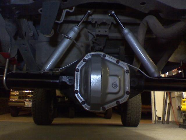

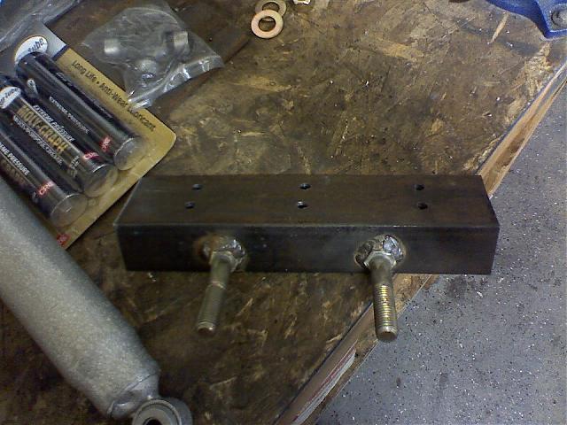

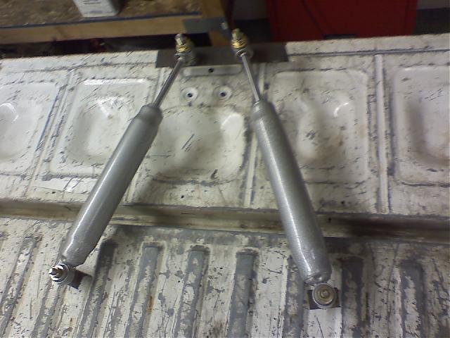

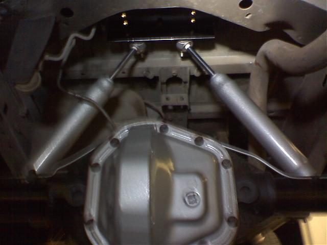

Finished the rear shocks and installed the steering box brace with some modification...must have been a different steering box in the xj or frame a tid bit different, anyways...the back of this pile is completely done....onward to the front...needs shocks and front driveline.

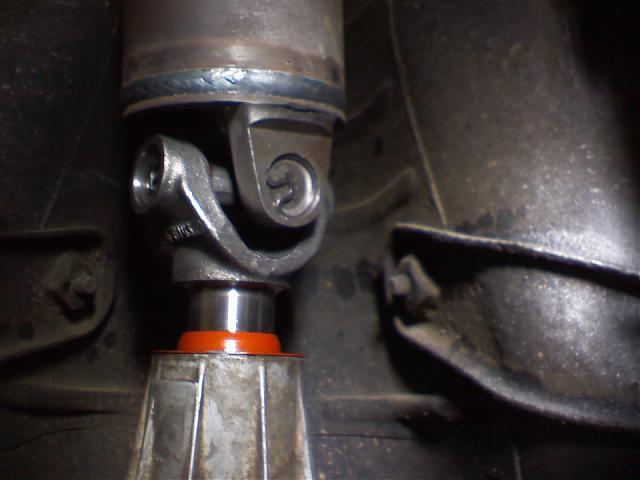

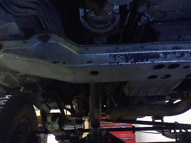

Ended up changing out the yoke for the high angle YJ style....bought it new because "somebody" didn't have one when they said they did.
Finished the front driveline...spent some time going through that thing...
Good clearance between the crossmember...no modifications necessary.
Good driveline angle, just enough slip either way for full articulation.

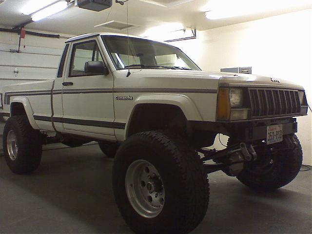

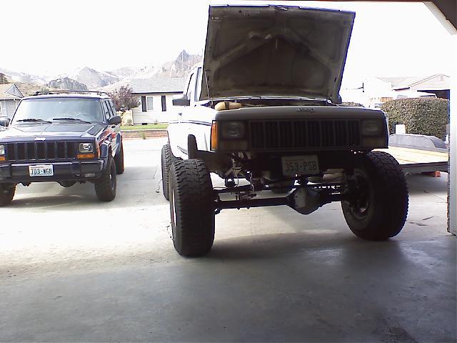

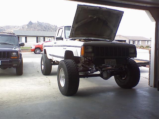

Jeep at the end of tonight.:kissmyass:

Where the flex pics?
I almost asked, What does he need shocks like that for the tailgate?
