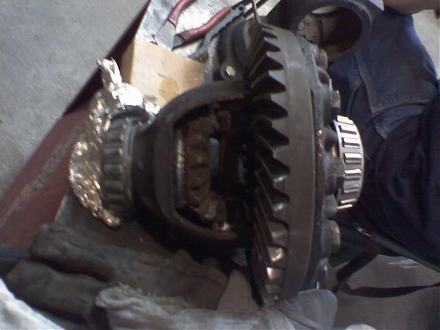

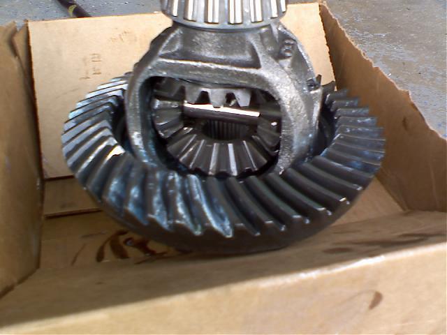

I slid the axles out of the 60 just now and pulled the carrier....I'm gonna weld it up this evening and make my stock cover extra burly with some plate steel down the flat spot of it....can't afford another Riddler just yet.
the 60 is all welded up with the help from my buddy Denny....he's welded up lots of these and never had a single one break yet....

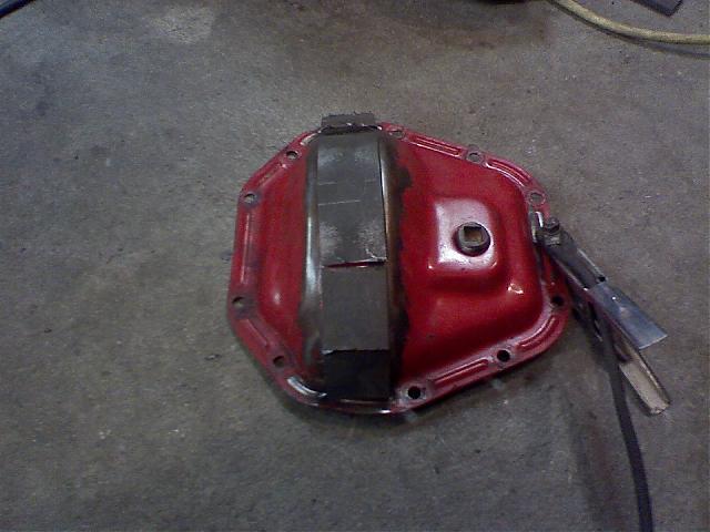

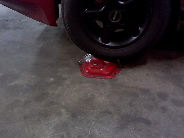

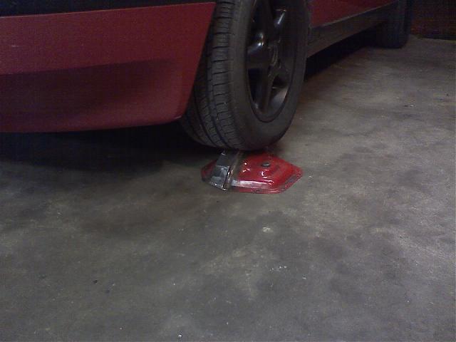

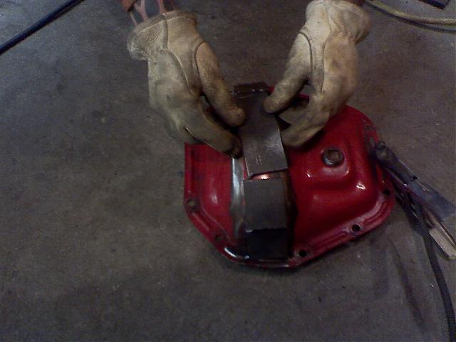

Since I can't afford another Riddler cover, and we had it off, we thought it would be a good idea to add some gerth to the stock diff cover....
And then drive over the top of it with Vinnie's audi.....over....and over....and over....
DIDN'T cave in...good sign.

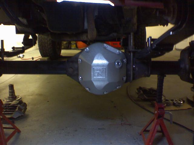

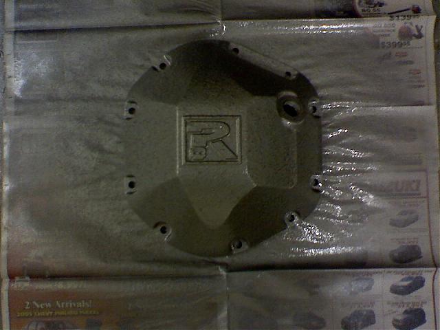

Here is the finished products....60 and Riddler cover silver hammer finished.

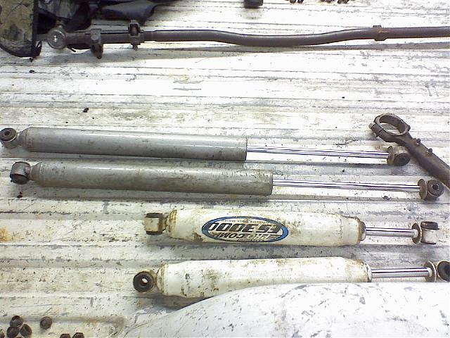

And Denny gave me some almost new long travel shocks for the front...and some procomp 3000 is decent shape for the rear.

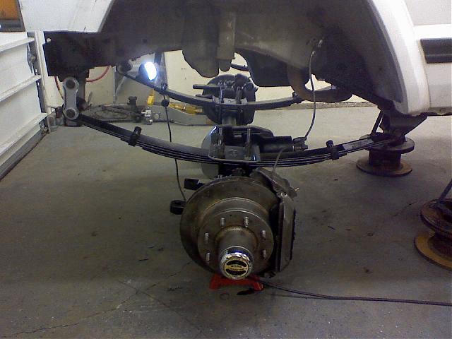

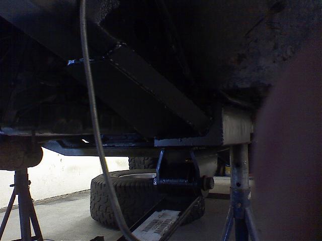

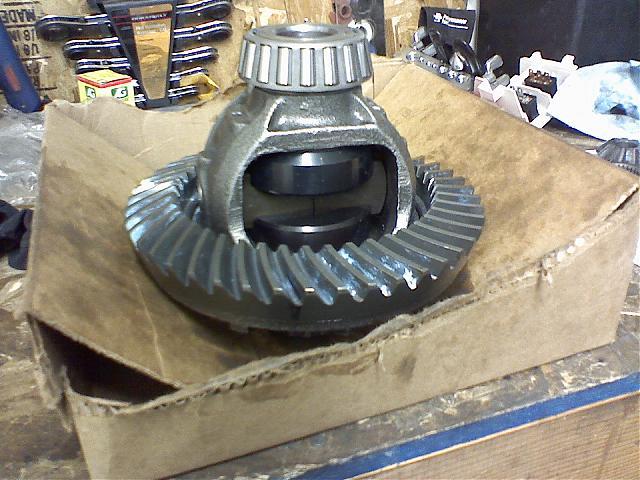

well, the last few nights have been fun and interesting...I've been boxing in the frame around the old LCA mounts(where I ripped them off)....during this adventure I've managed to learn alot about making templates and welding in weird positions...as well as catching my shirt on fire and recentering my front axle...that was sweet...then once I put the spool in the front and when I was putting the calipers back on I broke the bolt that holds the caliper on to the bracket...so I went and got this nifty new style of a bolt extractor that worked magical! Everybody says they don't work...well...when a bolt with a shoulder busts off half way down in there, they work great!....then my buddy gave me a tap and I drilled the hole out and tapped it for a 3/8 bolt, which is considerably bigger than stock...looks like someone already had to do that on the other side....everything is welded and painted and tomorrow will be assembled...hopefully I will get it full of fluids and drive this bitch around the block on Wednesday.....we'll see....**** always seems to work out differently...
okay...so in the midst of trying to REcenter the front axle......I ended up welding the stock perch and redrilling which F....ed up everything....so I had to redrill the ubolt plates and now I'm realizing that my drivers side axle shaft is hitting the blocks in the mini spool...so I need to tear all that back apart and grind down the shaft at least an 1/8 of an inch...the pinion yoke is changed out but i'm not sure that the seal will seal that good do to some dumb ass before me messing up the seat for it in the diff....we'll see I guess....if not I will need to see about fixing that somehow...lots of good stuff...
Frame is completely done, everything welded and painted...90% assembled:mad:

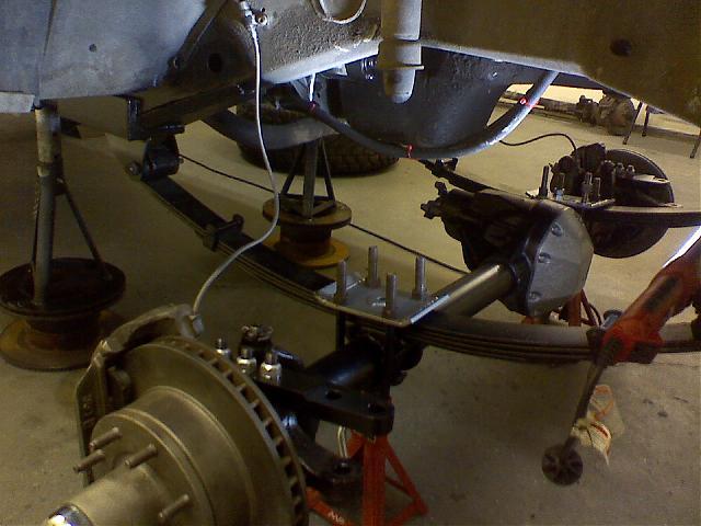

Spool install from start to finish....

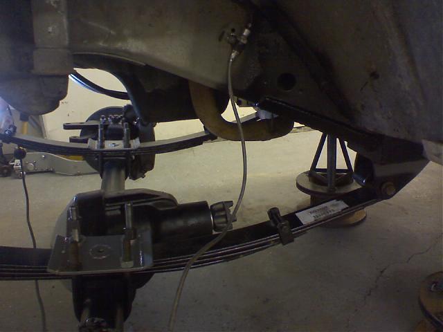

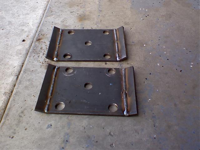

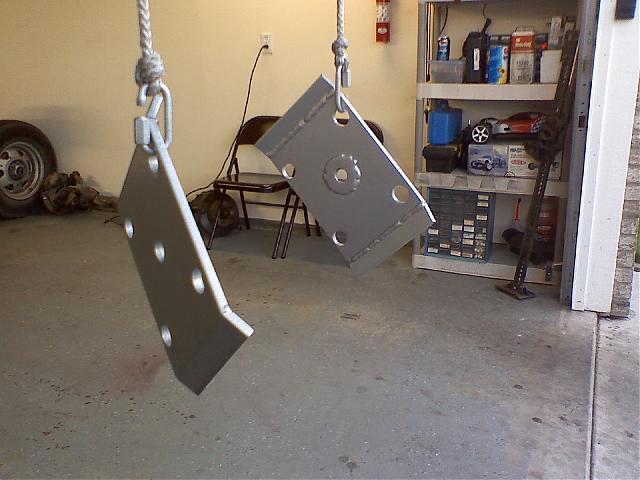

finish bending, welding, and painting u-bolt plates....

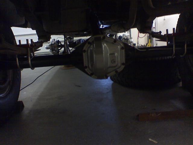

Frame is done being boxed and reinforced for now...
Just got the 24in brake lines on...
and the rear cover is on...needs fluid.
The pinion yoke has also been changed from 1350 to 1310.
oh yeah...and I ground down the drivers side axle shaft(spool end) about 1/4 inch...so it would quit binding up...works like a champ.
