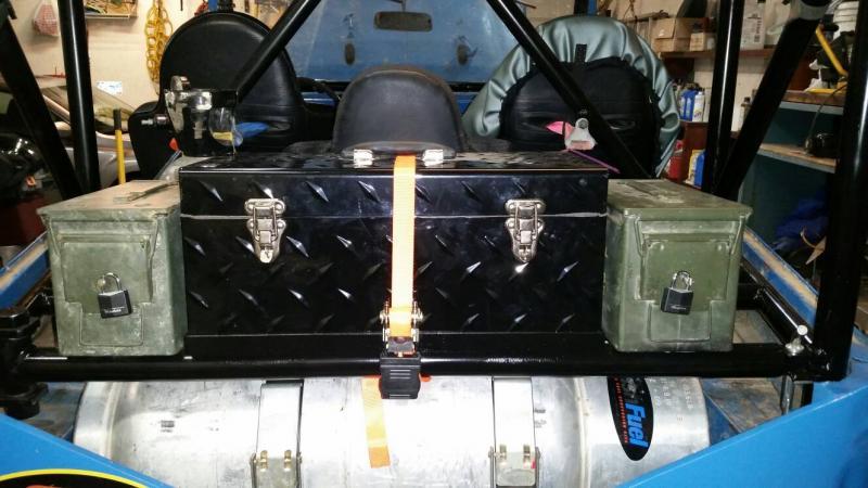

I picked up the ammo cans from Nick this weekend and got them mounted to the rack. I was able to fit all my recovery gear in them with a little room to spare.
Looks good. I see my old home-made seat cover in the picture too. How does it fit, is it going to work out?
Yup, they fit fairly well. I had to add a couple more loops to each to hold them down since they were a little on the small side, after I did that they fit great.

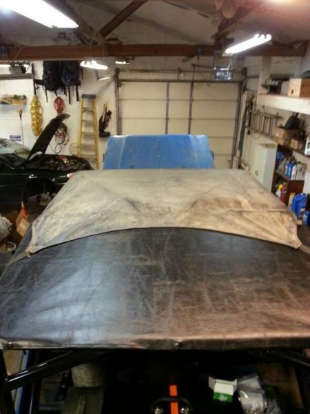

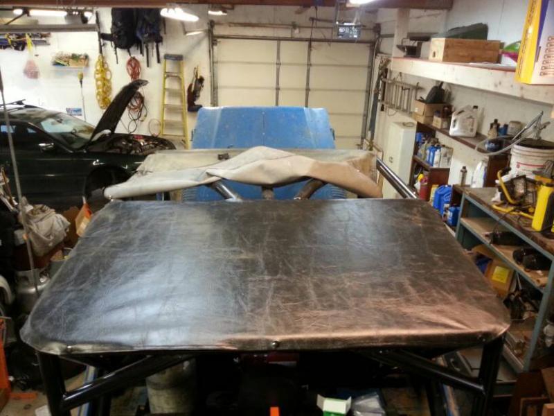

Finally got the top on the rear section of the cage. Its nothing fancy, but it should work well.
