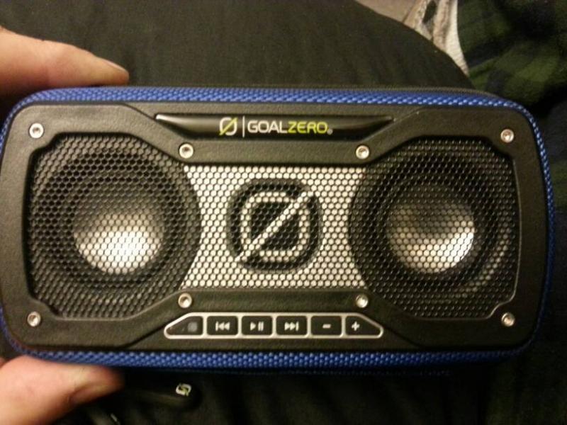

I was wanting to put a stereo in the Cruiser but haven't had the money. I came across this today, it is a Goal Zero Rock-Out 2. Its water-resistant and has bungee cords on the back for strapping it to things. It's actually pretty loud and the sound quality is surprisingly good. I got it at REI for $40 after a 20% coupon.

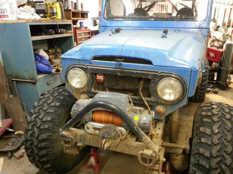

Ended up mounting TEQ badge up on the grill, what a PITA getting my hands back behind the grill.
